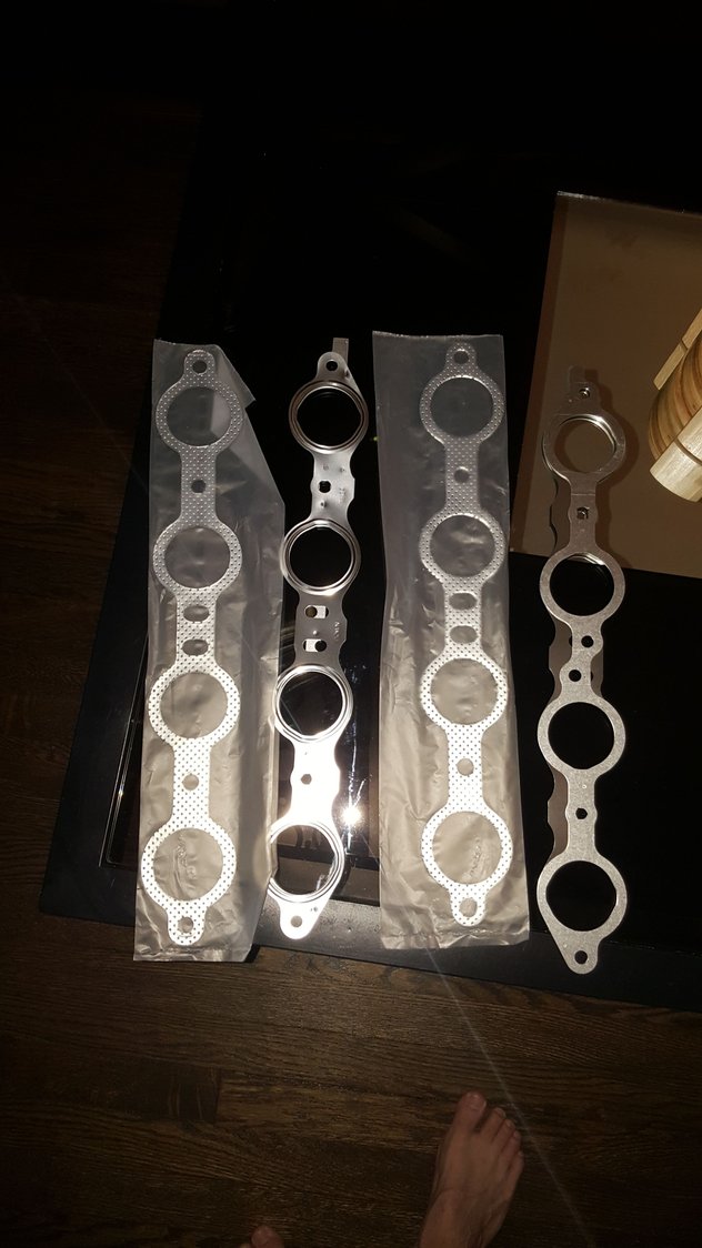

So i got my headers and xpipe in the mail today just curious and wanted to ask so i did not put them on the wrong way, do i put the gray dotted gasket on first then do the metal one?

You would only put one gasket on. I'd recommend going with the MLS (metal) gasket.

Alright i was just curious the metal gasket is super thin so i wasent sure

Metal is a crush gasket, much better, last longer, fits tight, love you long time!

Weird that it came with 2 sets of gaskets

Yes, use the MLS gasket (multi layer steel).

Used the metal gasket seals great, car sounds amazing now
