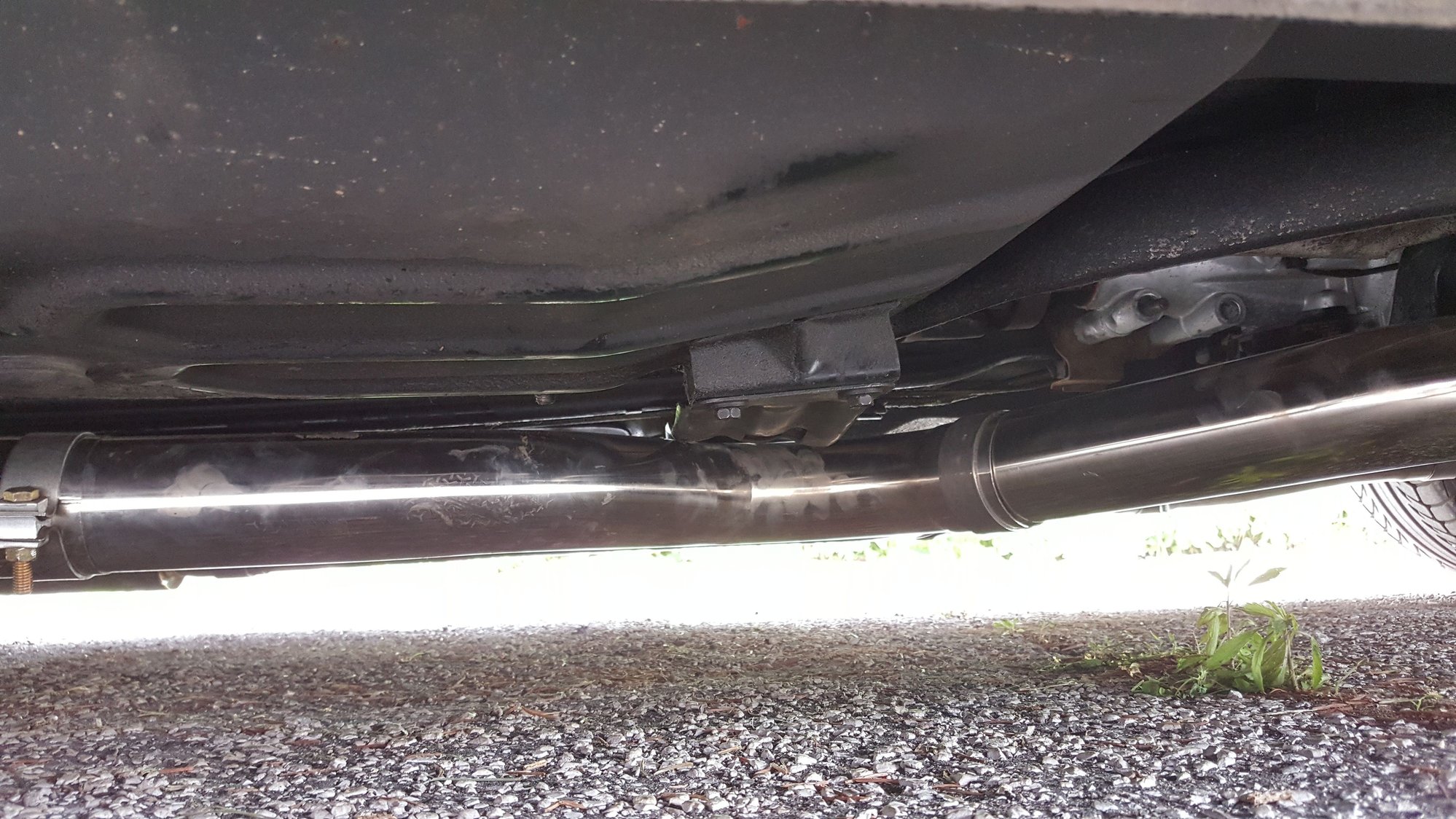

So I installed my long tubes and true dual xpipe set up the other day just wondering if anyone here has not put the mid crossmember that runs under neith the car? I seemed to be able to get the pipe to hang pretty high but it was resting on a suspension piece that ran to the rear end so I thought it best to install the piece and take away from the clearance but now my tips are pretty close to the ground

And anther question to go with it does anyone have pictures of how there setups are ran under the car

Under the axle , people have had issues because of clearenc e and if road conditions in your area are lacking.

This is the crossmeneber i am talking about

Is that a thin wavy piece that goes across the tunnel that's giving you issues ?

you could remove it or introduce it to Mr. BFH

Ya, I would remove it. Don't think anyone with Lt's keeps that anyways.
I know I removed mine years ago, walked over to the garbage and dropped it in.

Remove it, it does nothing.

Throw the tunnel brace away. If it's hitting the torque arm just keep messing with the fitment. At full droop on a lift my torque arm will bump the duals.
