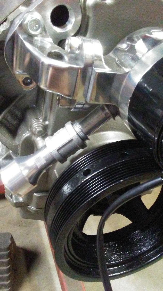

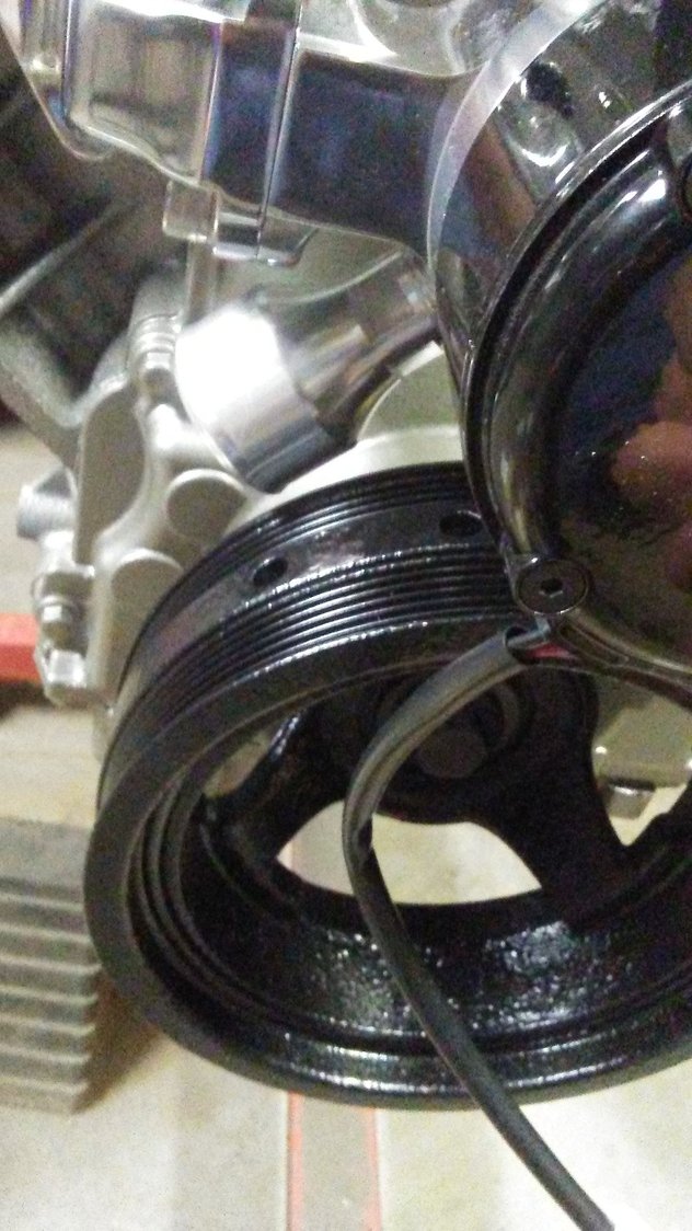

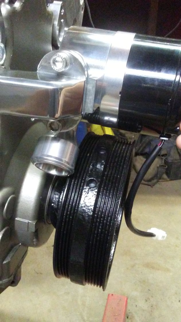

I have a 2004 tahoe 5.3 that i just installed a bbc electric water pump (e-5927-p) on. I purchased the ict billet adapter plates for it. Once installed the lower radiator tube off the electric water pump almost hits the harmonic balancer pulley. I was wondering what others are doing to eleviate this problem. Going onto an 85 cutlass. Thnx

Can you post a pic of the clearance problem?

Ummm an under drive balancer?

i thought about that. But it seems my lower radiator hose would be right on top of it still. I was wondering if they have an adapter to angle the hose back a little so its behind the pulley. I couldnt find anything. The spacer plates is wht has it to far forward. I would imagine that other people would have already ran into this issue. I was just wondering what they did to fix it. Thnx

Use a balancer with no ac pulley

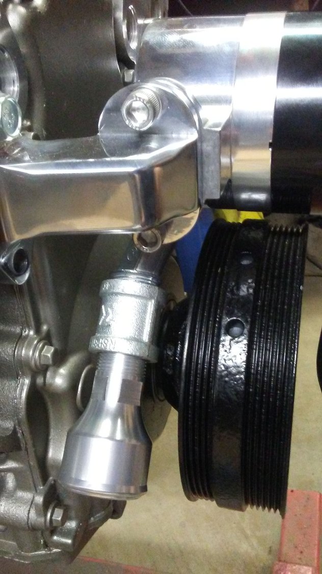

Temporarily installed. Paint and seal it up. Hope it works. Rigid offset and coupler from lowes. Seems to be the perfect offset around the pulley. But i wonder if the rigid offset will hold up to the radiator pressure?

Necessity becomes the mother of invention.....
Invasion of Elect. and Plumbing Depts. to the rescue! lol

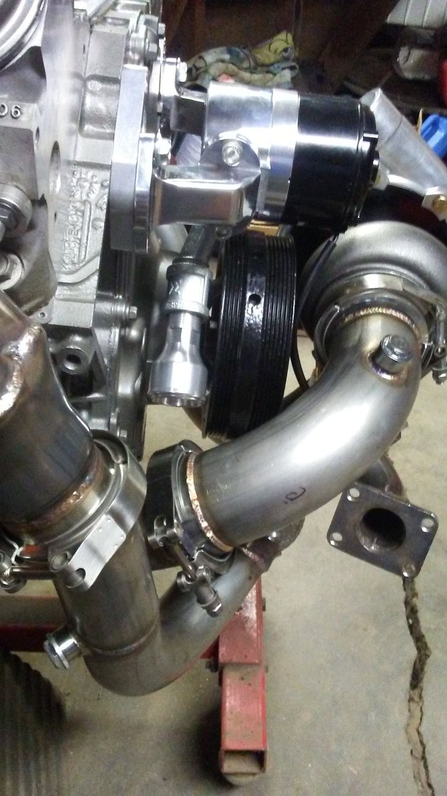

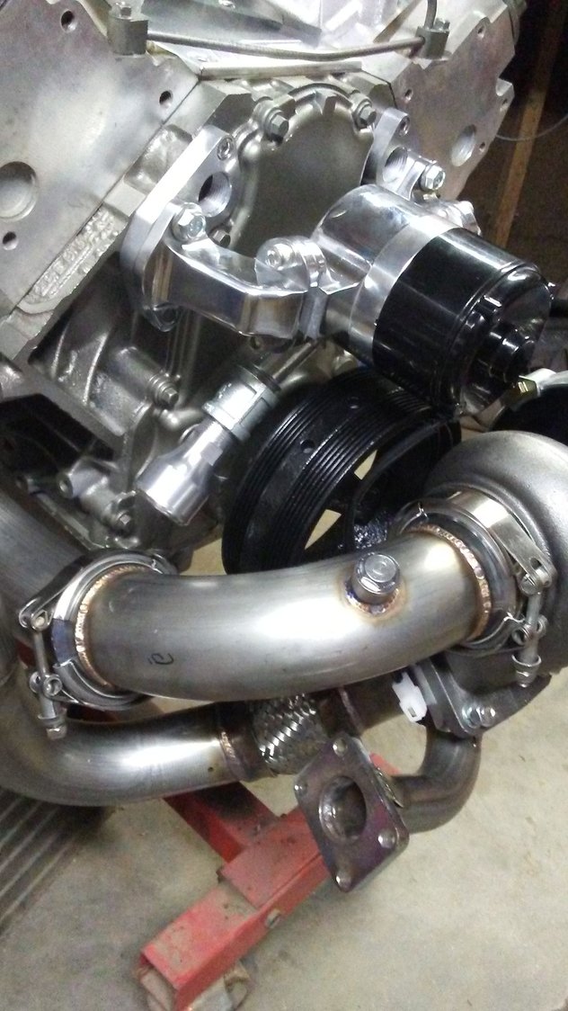

I think im gonna have to do some serious re routing. I installed my turbo exhaust and the down pipe is in the way now.

Sub a 45 ell for the coupler and aim it up. Looks like it should clear then....
