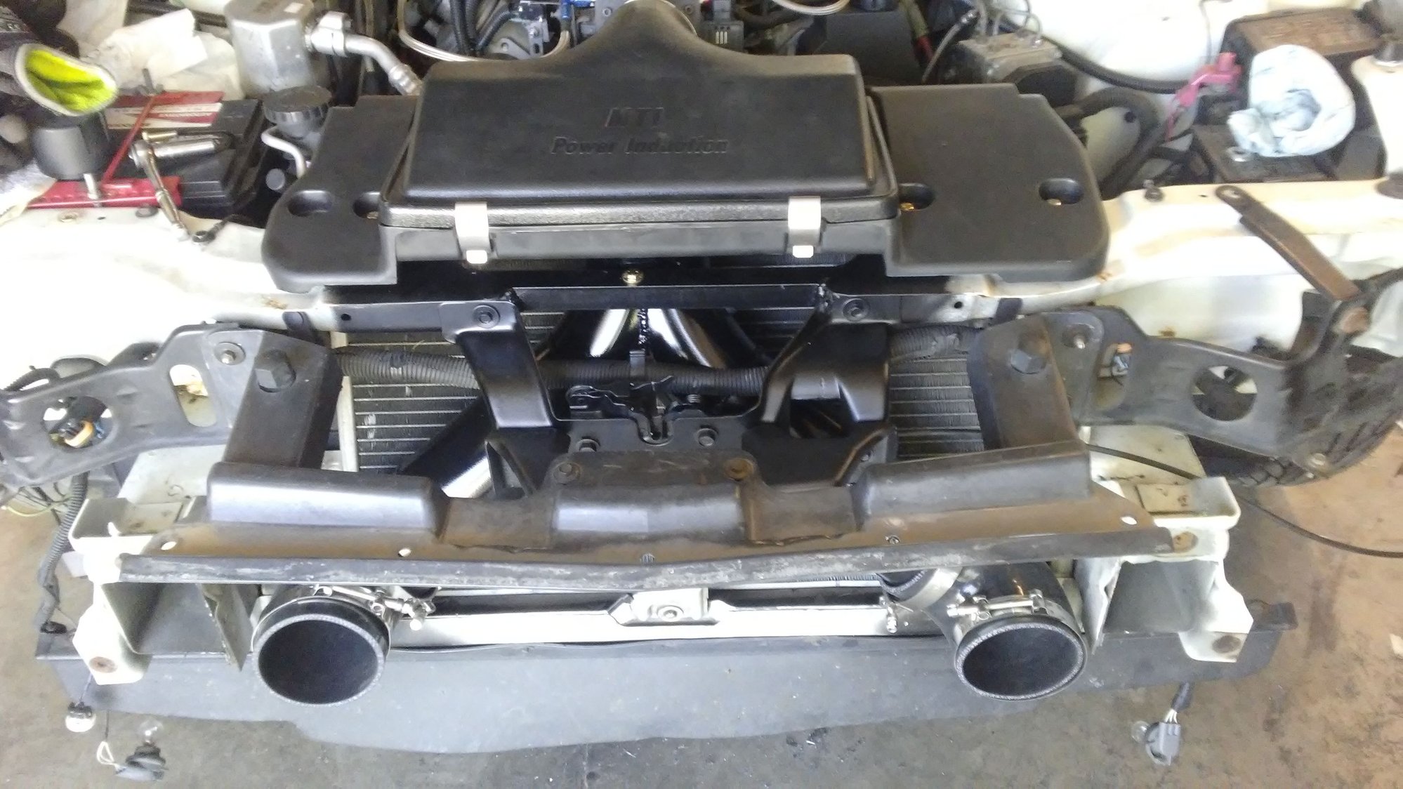

Race trim

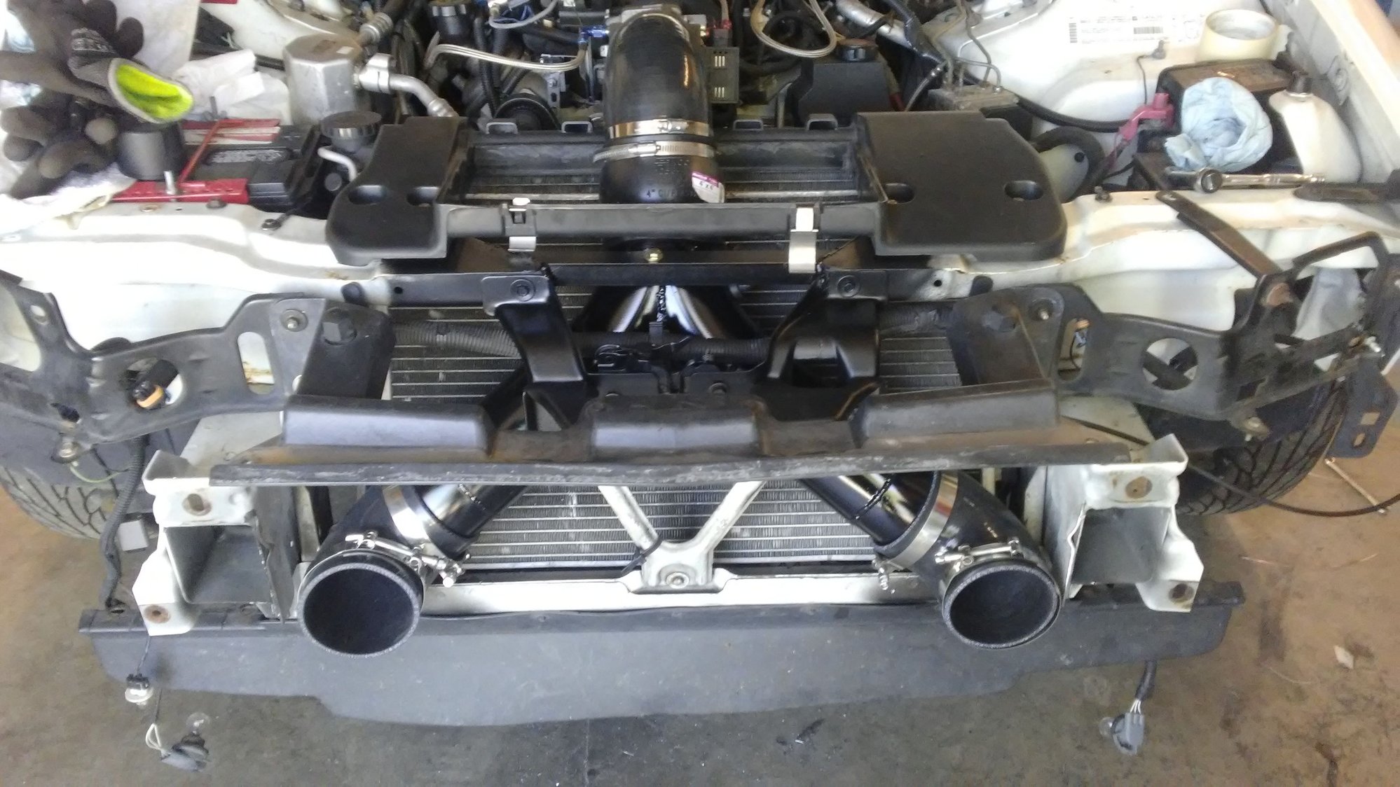

Street trim
Old Jun 24, 2018 | 07:09 AM
98CayenneT/A's Avatar
Joined: Nov 2013
Posts: 3,913
Likes: 366
From: White Bear, Mn
That's a big difference in da and I bet a quarter mile where your speeds are higher would be a better comparison

The sealed ram air setup was showing higher MAF numbers in Hz and in/min but didn't really show up in et
did you log the difference in the map? That kind humidity is a killer. Be worth 2-3 tenths in the 1/4. Also the ram air is going to help more in the 1/4 mile than the 1/8

Did log map on all the runs. On the back to back night the street trim with lid Read slightly higher up to 96.x on map while the race trim was 95.x-96. But again neither beat the earlier runs this year in less da and humidity where it peaked at 97
