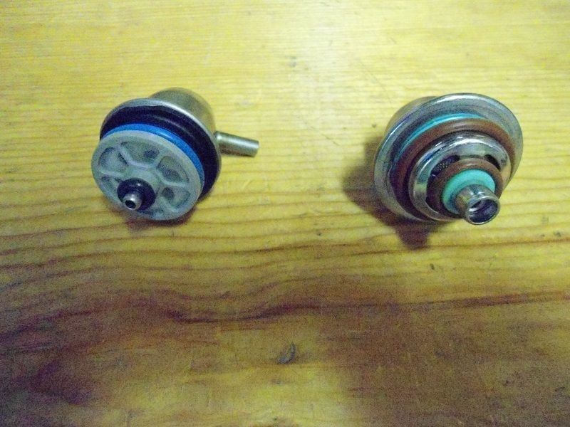

Here is a picture of the fuel regulators. The left is the non flex "T" code regulator and on the right is the flex fuel "Z" code. The fuel rails must be different. 3/8 supply and 5/16 return to tank on the flex 2003 and 2004 GM & Chevrolet trucks as far as I know.

The difference can be the material used. E85 or mtbe will eat most types of rubber

OK Big Hammer but the physical size and port differences are definitely easy to see in the pictures. My 2013 highlander says no E85 on the gas cap. This 03 Tahoe engine resides in a 1993 Jeep YJ and is quite the beast. I also use only regular with 10% ethanol. I do not use E85 at all. Oh and the injectors are different in flex vehicles. I read they flow more also.
