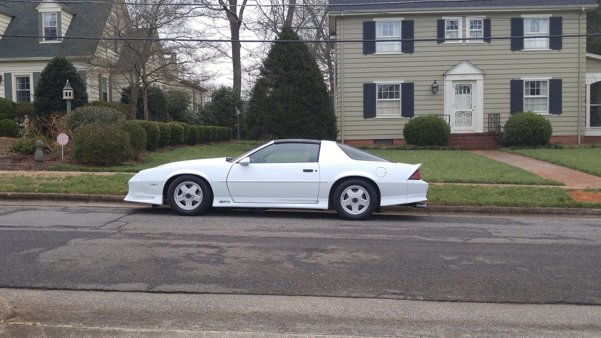

My 91 RS was LS swapped & restored by Hawk's. Exhaust is Hawk's Motorsports Stainless 1 7/8 long tune headers with 3 inch primary. The headers fit very well and spark plug access is good, better than my 99 TA with Kook's. I like the headers.
The RS has the matching Hawk's Y pipe, which I really don't like the Y merge. It's a compromised 3 inch into 3 inch Y and the Y is 3 inch out. However in fairness the Y pipe tucks up tight and doesn't rattle. Due to the Sinister Subframes, cross-brace and short torque arm attached to the subframe etc Hawk's put a one inch notch in my Y pipe due to the suspension set up so it all tucks up nice and tight. This gets more ground clearance. My RS has Eibach Sportlines with one full coil removed, so the car is sits low and ground clearance is at a premium.
The RS scraped occasionally in North or South Carolina with the tucked Y pipe where I used to live. Moving north to cold weather Indiana and getting on poorly maintained roads ravaged by winter and full of potholes quickly made me realize the RS is too low. Without that tucked & notched Hawk's Y pipe the exhaust would have been crushed probably a dozen times over.
A pair of electric cut outs off of the headers bypassing the notched Y pipe takes care of the restriction issue when it's time to play
