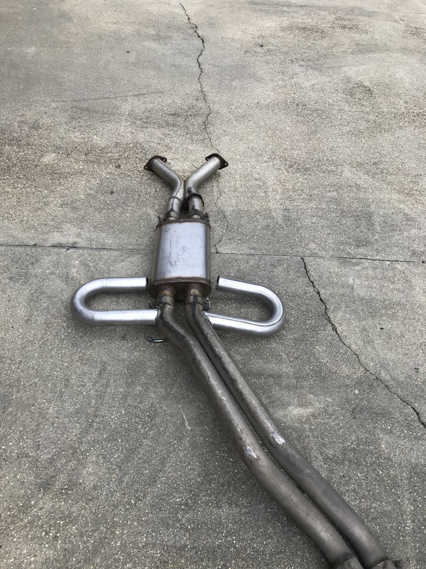

btw, if you like the way it sounds and the volume of it.....its just the drone thats messing you up, look up helmholtz resonator. i built some for my car and they got rid of 80-90% of the drone. Or you could put a turbo on it. That eliminated the drone 100% LOL

Originally Posted by 99TransAmDude
Never heard of that. I'll look it up. Yeah a turbo would be nice. 😃
if you end up doing a helmholtz, it’s crazy, it eliminates the drone but the volume stays the same. Here’s mine, probably not the best lookin but it works.
That's pretty interesting. It make since how it works. I did some reading up on it.
