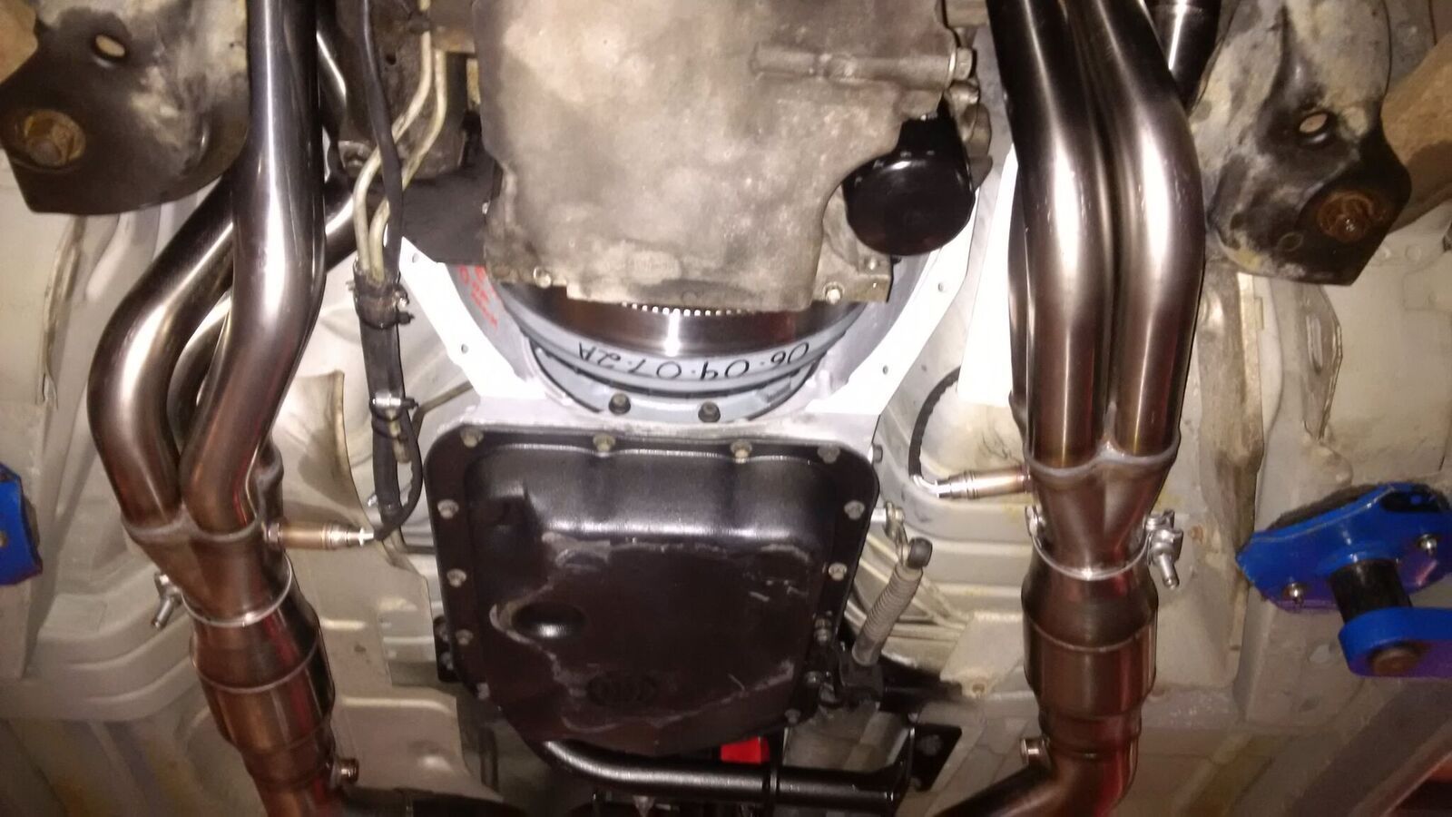

I'm not sure about the version. I got it in Feb. 2018. It fits quite well. It clears most speed bumps, but I'm also at factory ride height.
Old Aug 30, 2019 | 04:42 PM
Utinator's Avatar
Joined: Dec 2017
Posts: 1,033
Likes: 221
From: San Antonio
This is the only pic I have.

nice looking setup there.

Utinator, yep that's the newer version. Thanks for the pic.
