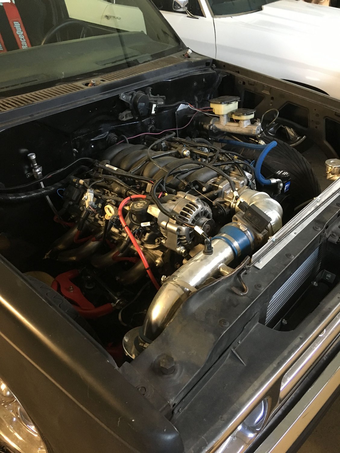

I have a stock LS1 auto out of a 98 firebird .I'm building a 85 S10 autocross truck to run SCCA cam T ,Looking for advice for the best bolt on combo for low to mid range toque ,we have SSW long tube headers with H pipe,3.73 rear .Unfortunately we didn't make it out this year so looking for some winter upgrades Thanks for the help .

I’m guessing the elbow on your air intake is just for mock-up?

The truck is going to weigh around 3000 when complete so 400 should be fine ,and my elbow I think I,m on my 3 or 4 attempt at a 4'' 90 from summit and jegs I'd want to send it to them and ask for something just like this. That set up was getting the motor started Thank
