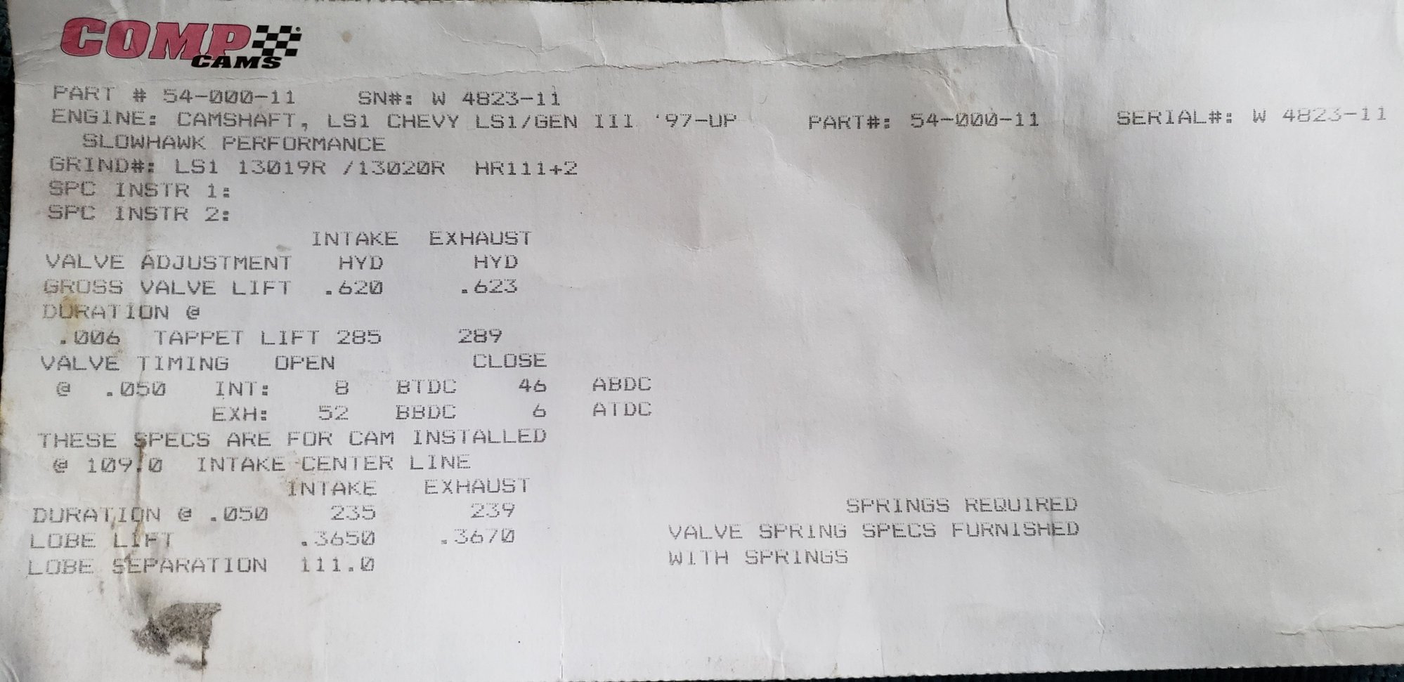

Looking for a intake that will suport 215 cc trick flow heads and a 235/239 cam on a 346. Looking for some thing that will pull till 7200 or more and fit under a stock SS hood.

Alot of people say that the fast 102 doesn't carry power past 6400 well. The car made 448 @ 6400 with a 12.1 afr. The thing was still pulling like a monster with the ls6 intake. I think a good budget for intake and throttle body is about 2 grand.
