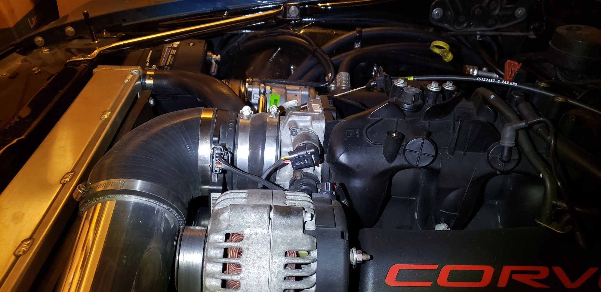

Looks like it has a MAF sensor

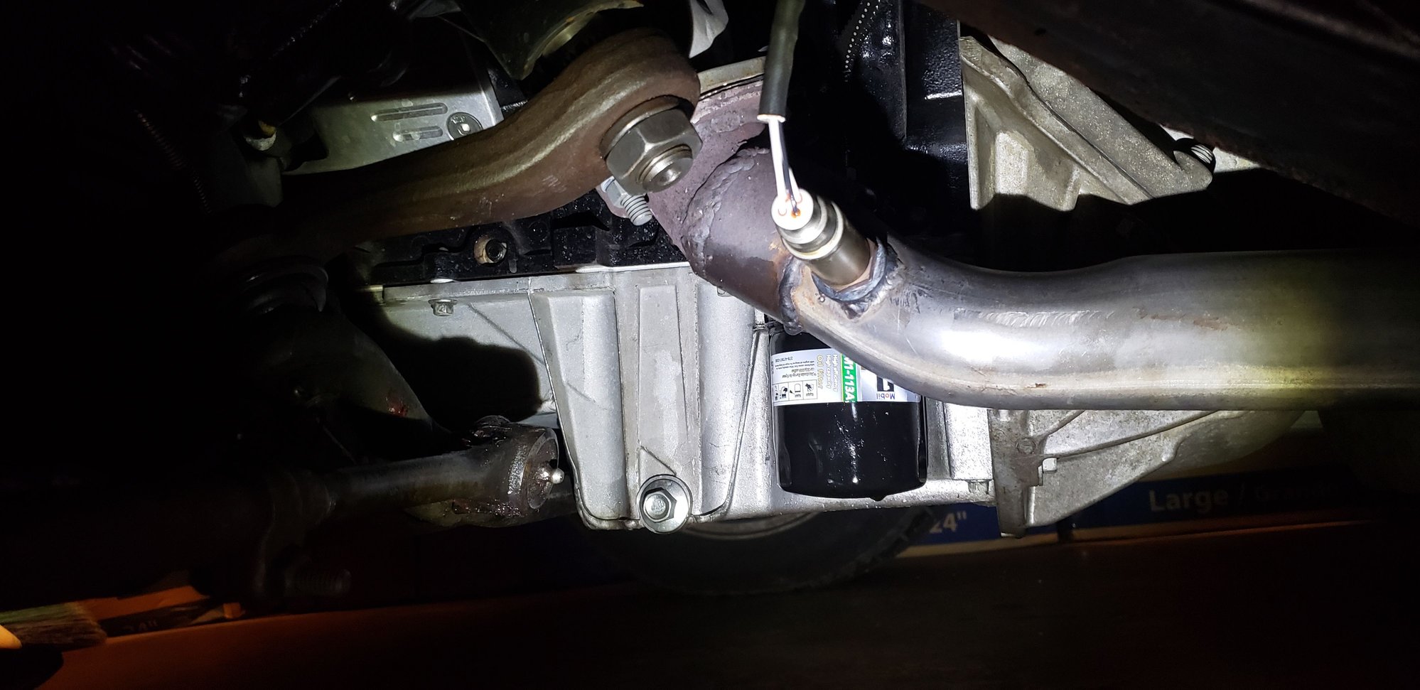

Here is the O2 detector that they added to it
