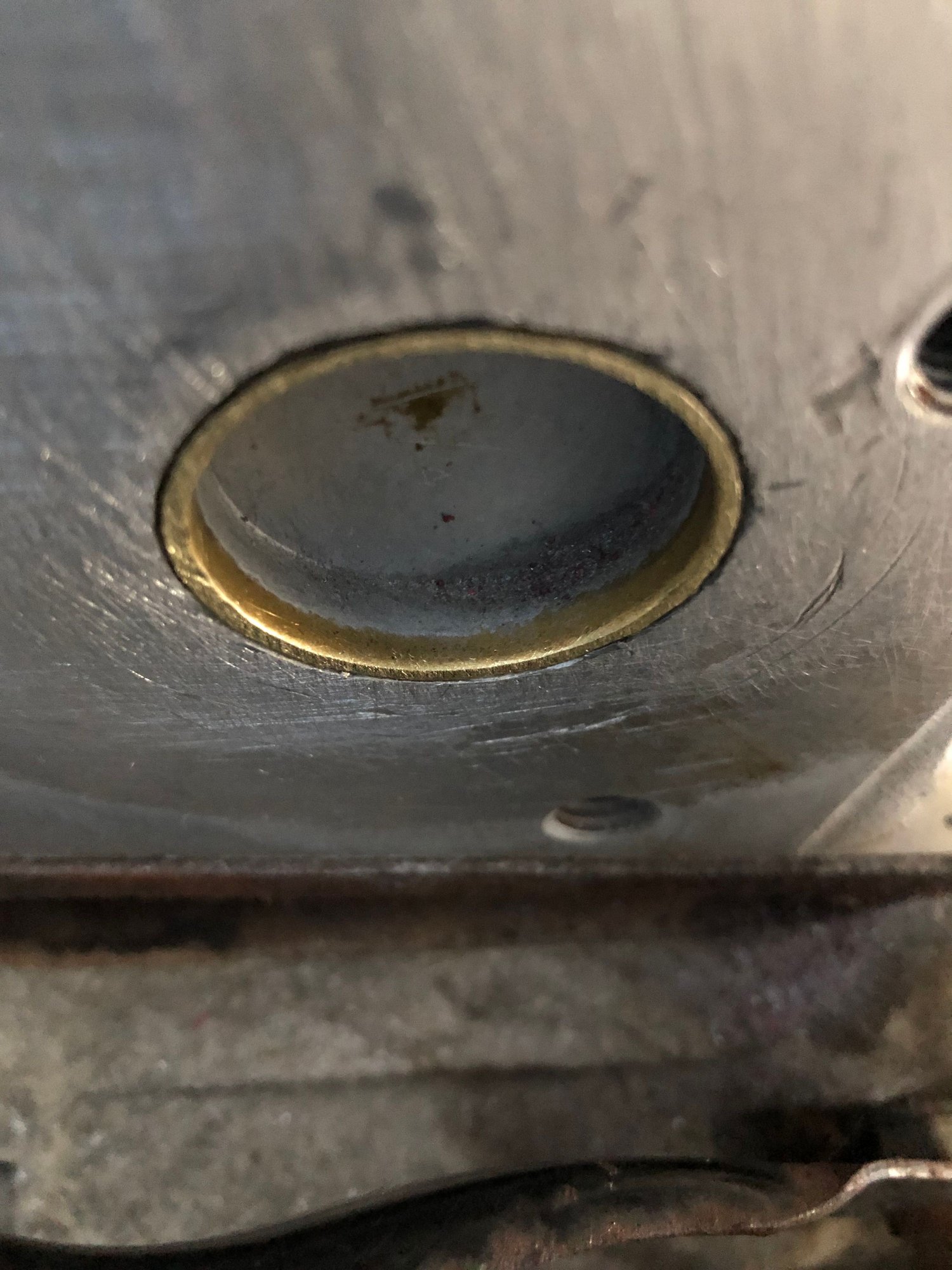

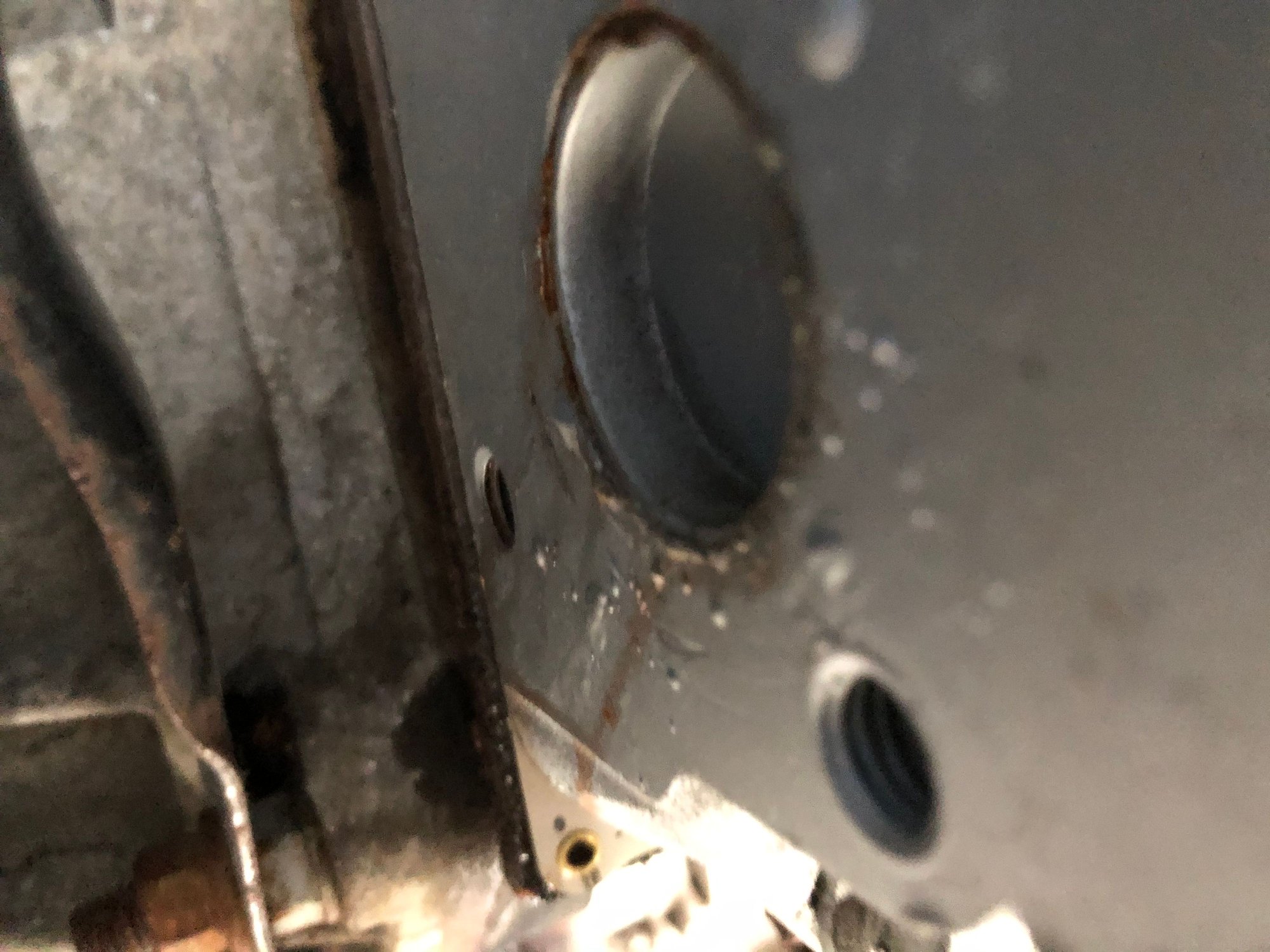

Old Mar 28, 2020 | 01:59 PM
chalou88's Avatar
Joined: Feb 2018
Posts: 163
Looks like the freeze plug on back of the head. See attached pic. What would be the culprit of this and is there any way to fix/repair it without removing the head. Using dex cool 5050 from the jug by the way only about a year or so old.
Old Mar 28, 2020 | 05:37 PM
wannafbody's Avatar
Posts: 5,605
Likes: 1,150
From: Pittsburgh
You can try some stop leak or pull the head. Some people don't like stop leak.

Isnt a leaky freeze plug likely to get worse if left alone?
Old Mar 30, 2020 | 09:10 AM
RB04Av's Avatar
Joined: Dec 2017
Posts: 2,180
Likes: 969
Not necessarily; sometimes the leak corrodes up and seals itself, if it's a good new plug as in this case, and the underlying problem is that the casting got scratched removing the previous one or something like that.
The ones that are GUARANTEED to get worse though, are the ones that rust through in the middle. Those will pretty much NEVER self-heal.
