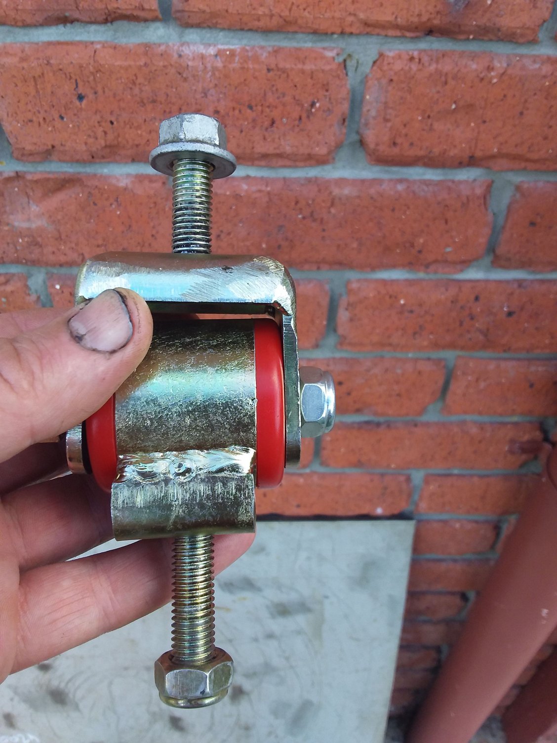

Hi I'm installing my LS1 tomorrow with these engine mounts, I wondering which way is up?
I was thinking the steel in these might abrade the underside of the alloy motor mount on the engine made worse because the surface area on them is greatly reduced compaired to the originals?

I dont know which way they go, probably doesnt really matter, but theres a heat shield between the mount and the aluminum part so i think it doesnt matter about the abrading you are concerned with.

The orientation is in the this thread: https://www.ls1gto.com/threads/scss-...talled.283706/
Are you sure that you have genuine mounts??? They don't look right to me; maybe Chinese knock-offs because the welds look very sloppy and they are crooked.

Thankyou for that link,
I put mine in the reverse orientation to those shown in link because both top and bottom surfaces were not flat but the smaller surface was the flatter of the two so I put that towards the bottom, I never seen any like those in the link here in Australia, they look like much better quality mine are not genuine GM just a nolathane brand common here. I haven't tightened them fully yet, put engine in today finally.

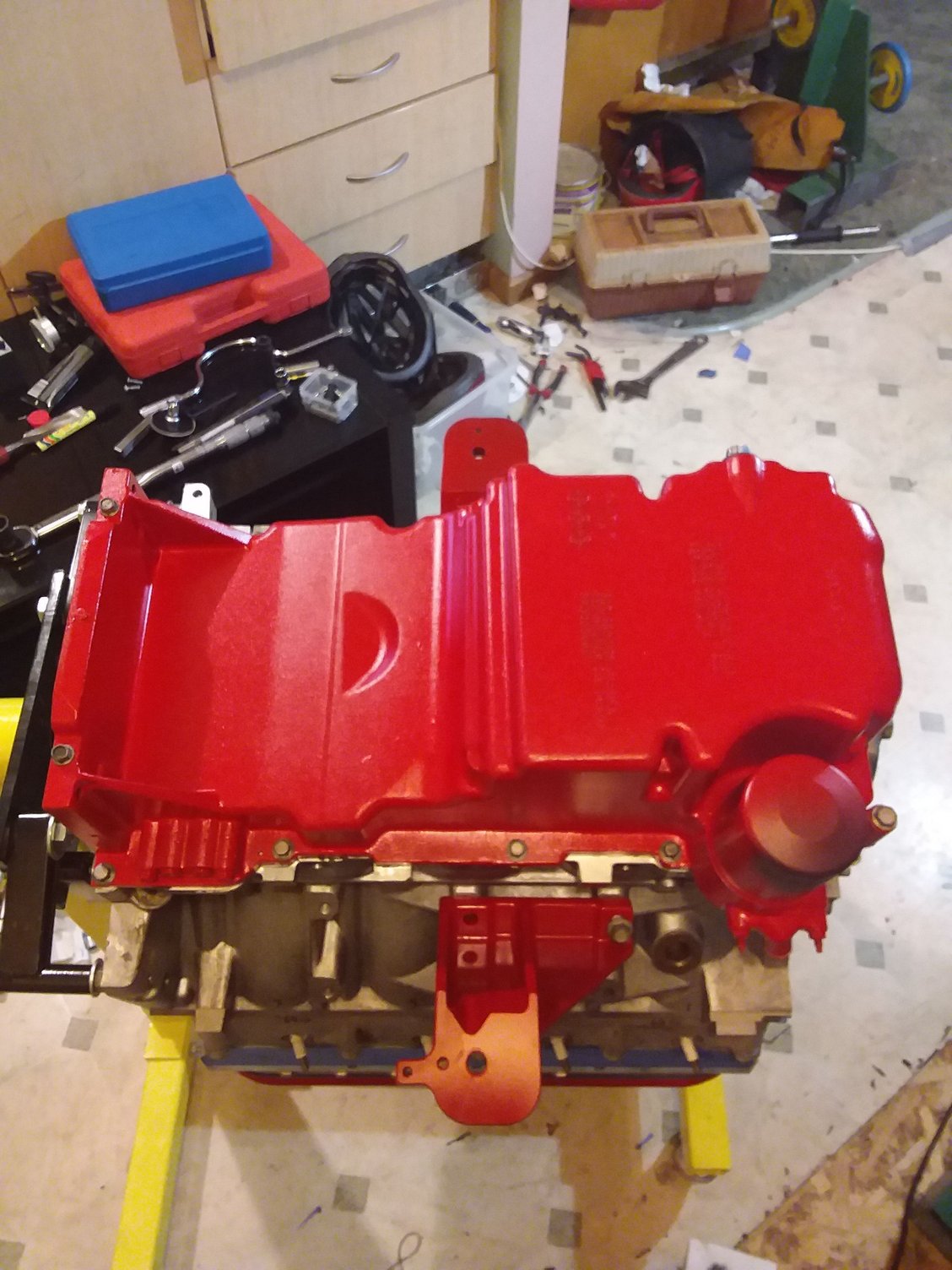

I've never seen that style of oil pan on an LS until today.
Old Apr 1, 2020 | 08:35 PM
TimsLS1's Avatar
Joined: Jul 2019
Posts: 421
Likes: 71
From: Tasmania Australia
It's a 99 VT the first year we imported the LS1 from the USA, prior to that it was the old Holden 308 and 253.
Gto has that stupid oil pan too.

It doesn't hold much oil, I put a racing baffle in it, I will have to check it often to keep it above the top mark.

They look good, I've heard of people using stock one and one poly as one side takes more abuse and it's a nice compromise, can't remember what side, I might do the same.
Just went an measured the poly mounts and they sit 0.40 higher than the stock ones, not sure if this will cause a problem with my header clearance and steering shaft??

I ended up buying stock ones, these poly mounts sit 10 mm higher, I test fitted my headers and they hit the car in one place with the poly mounts.
