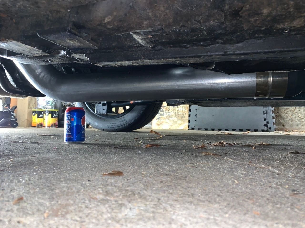

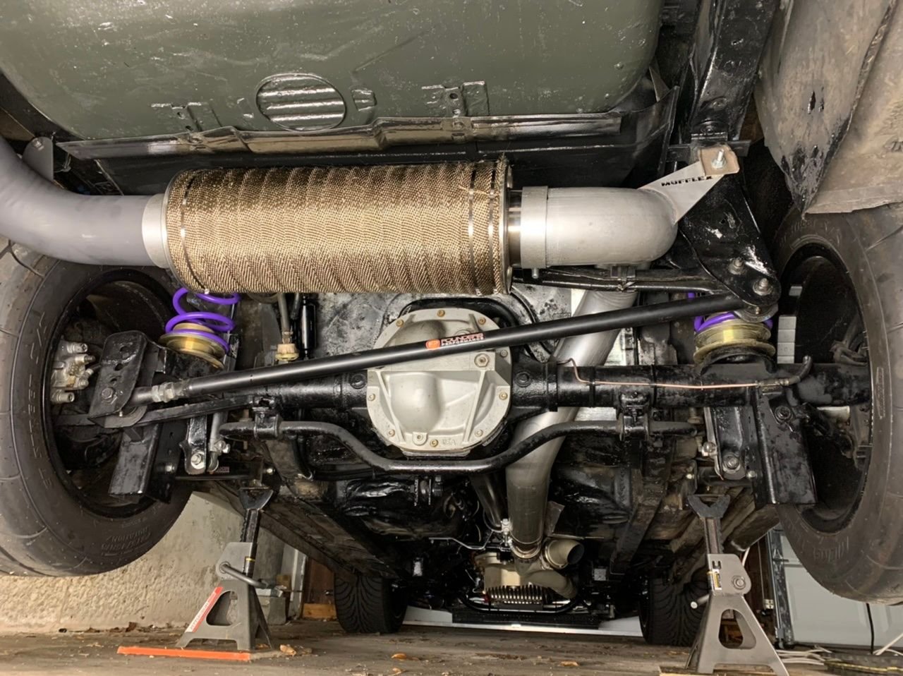

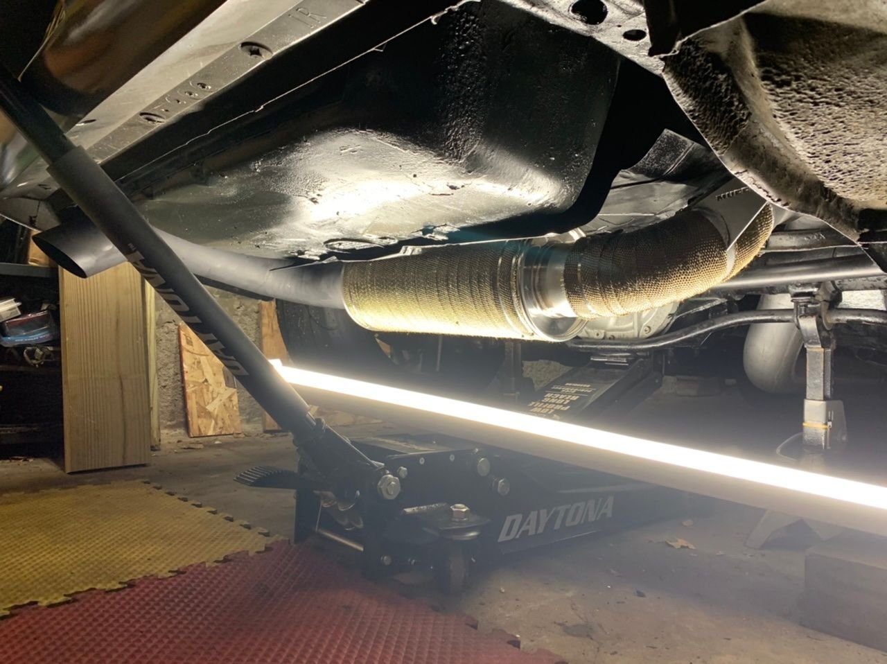

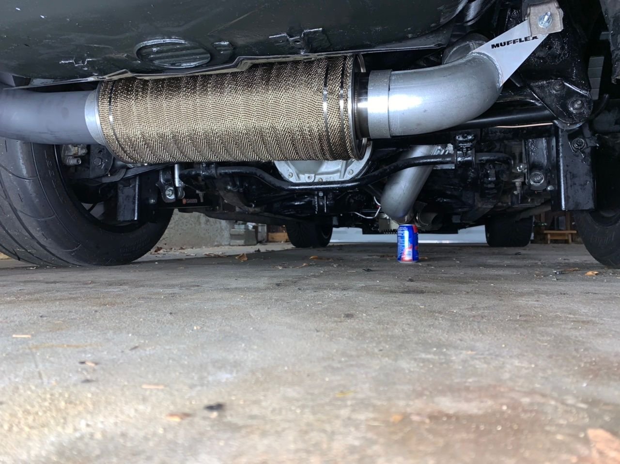

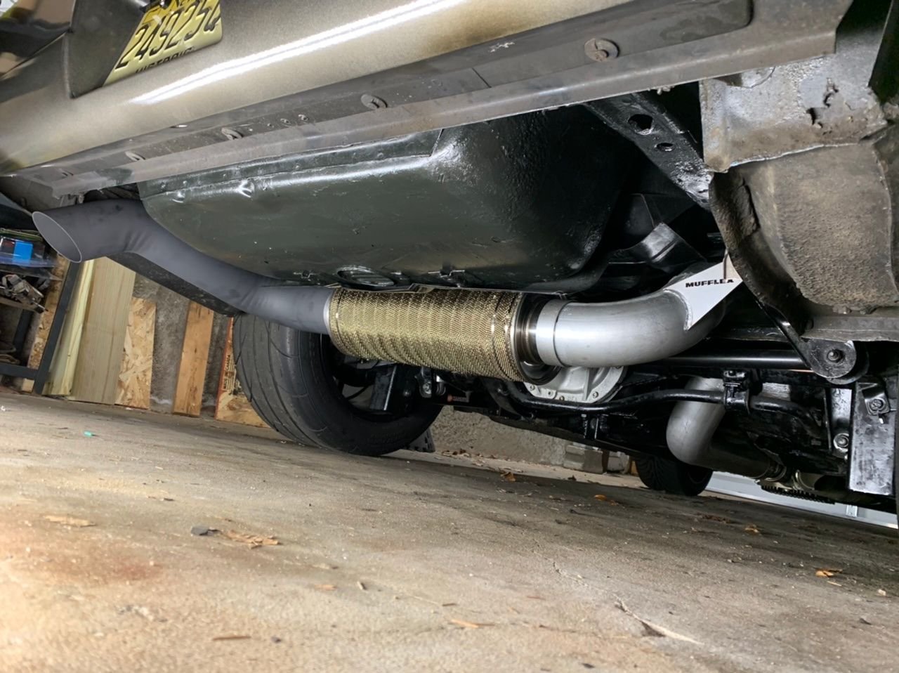

My hawks 4” sinister showed up yesterday and my
22” long 7” DIA vibrant stainless muffler came Thursday. Got the 4” exhaust installed last night... they apparently use mufflex exhaust pieces and it fit amazing. I somehow have more clearance than my summit 3” catback and it cleared the stock PHB support. Muffler fit without trimming and has a gap between the muffler and the heat shield. I think im
gona love it but hope it’s not too loud. I haven’t started it yet but plan to today! Raining tho so no driving. I will pull it and creakote it after i run it for a while and see if I can deal with it.

Started it up and shocked by how quiet it still is. Here are some videos. These idle shots are outside in the same spot so the sound should be close (nothing to echo off of)
here is the before video with the borla proXS muffler idling.
here is the after video with the 4” catback
Driving the car down the highway with 4” catback
honestly I took the car out for a drive and the car is much quieter than I thought. It’s louder than the borla 3” but not as loud as I was expecting. I was able to get alittle more turbo spool through the full exhaust but still nothing compared to what the cutout provides. Overall the car is still pretty quiet and I can cruise down the road with the windows down and not hear the exhaust much. Depending on how I feel I can always do a muffler delete or put something smaller in

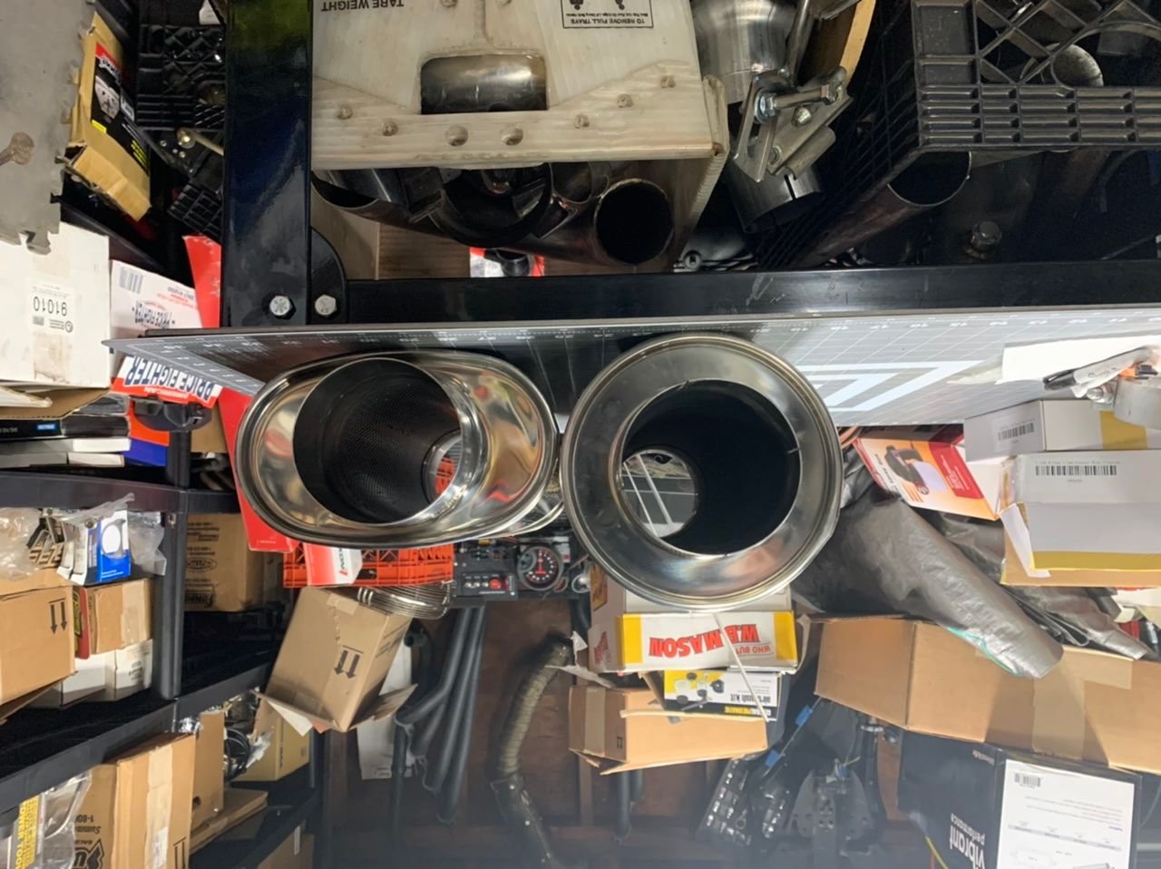

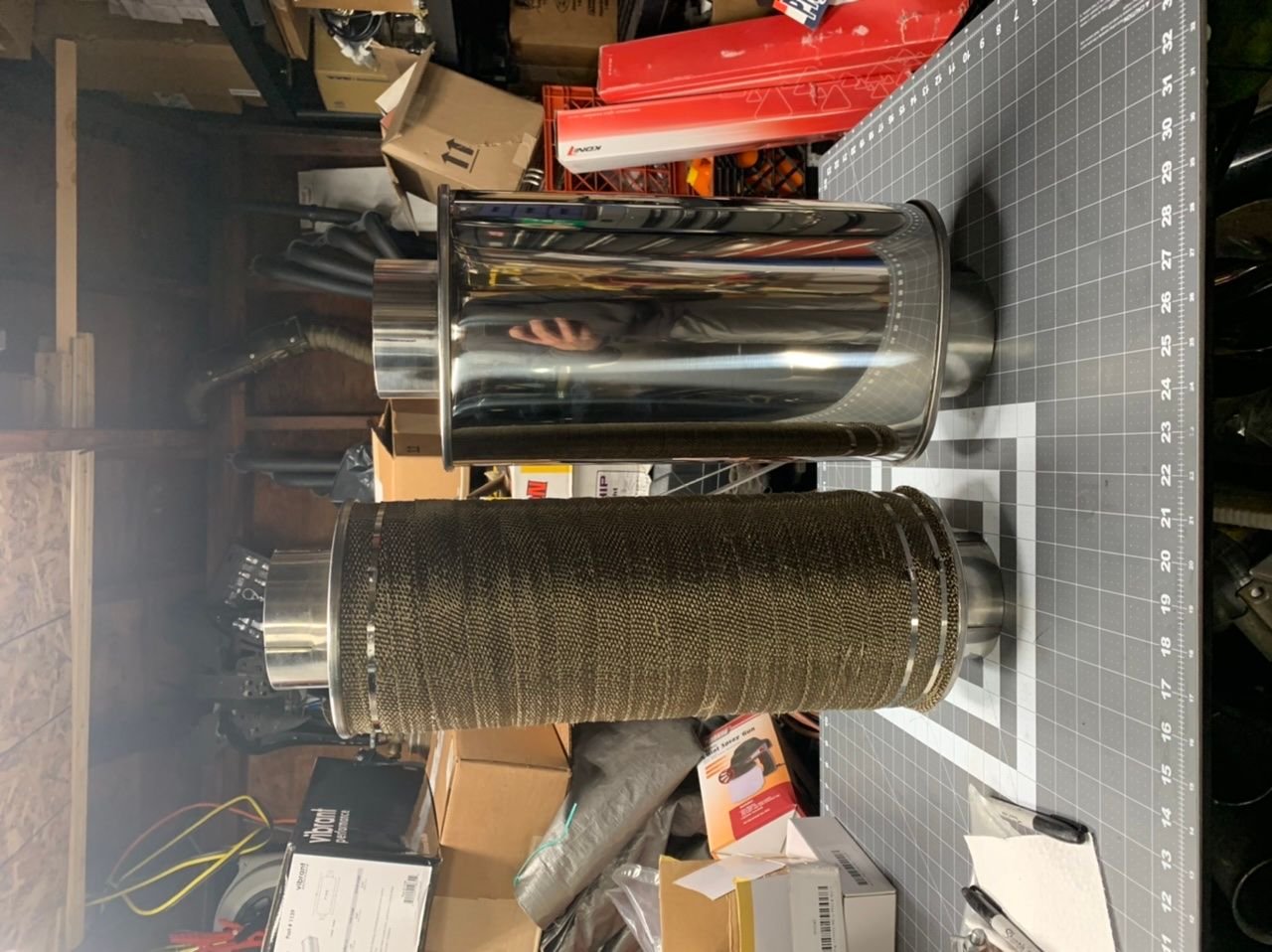

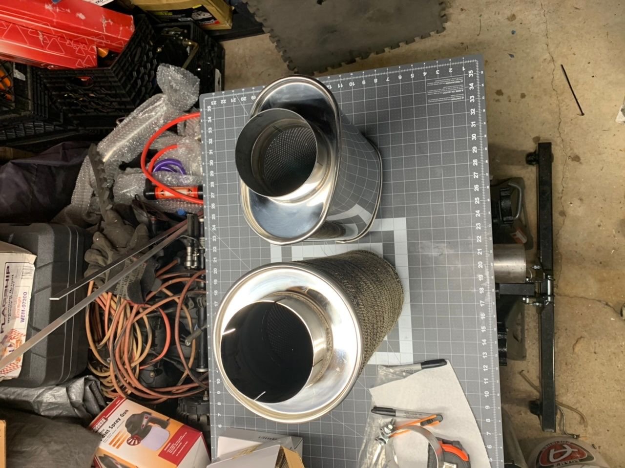

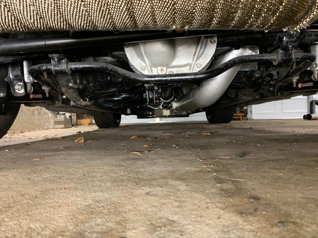

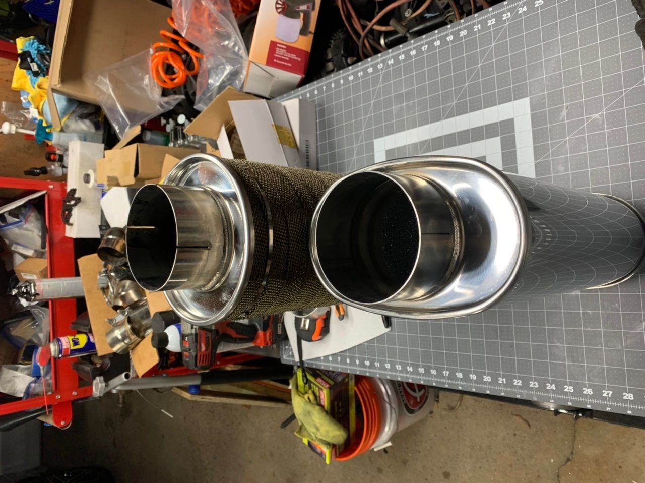

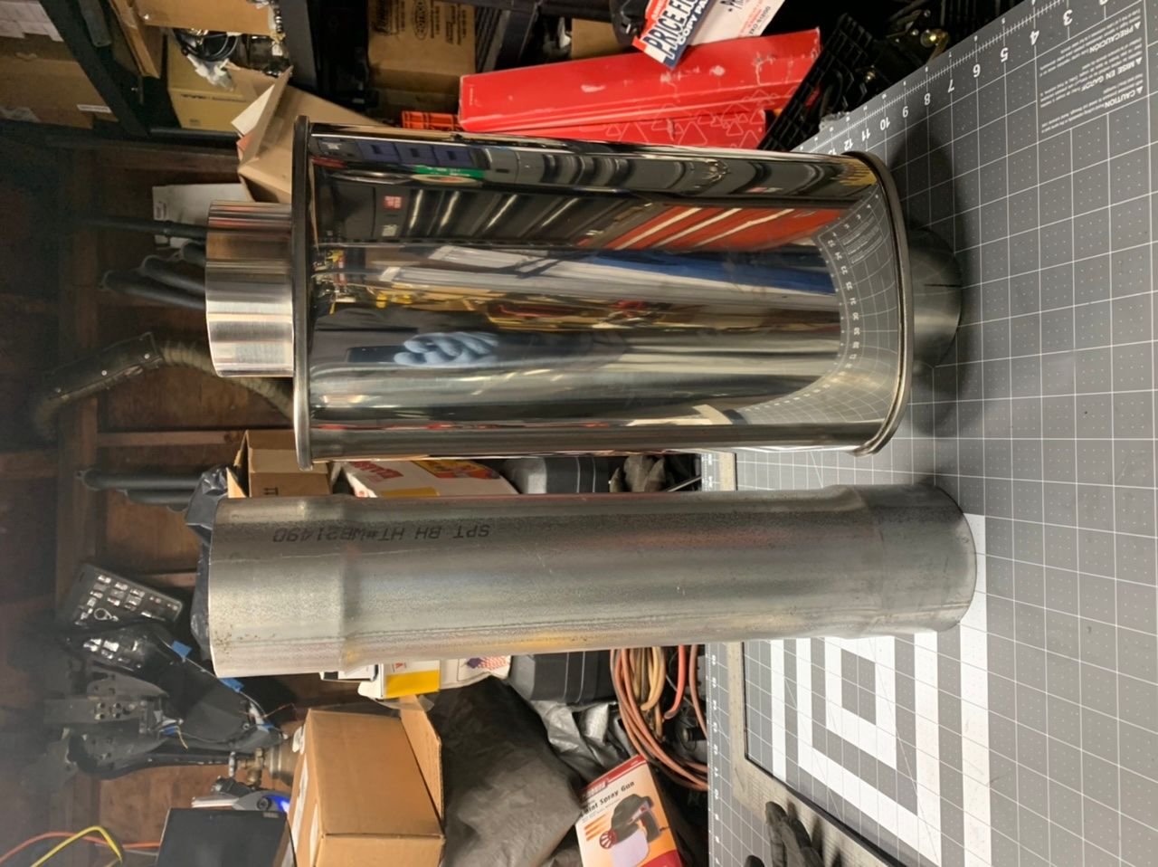

Drove my car out of state Monday (3-3.5 hrs driving total) 90% highway between 50-90mph and it didn’t drone one bit. Sounded fine and pretty quiet honestly. Maybe bc mine has a turbo up front it doesn’t drone but it’s def quieter than any NA car I’ve owned.
for those of you wondering my smaller oval case vibrant randomly shipped 3 weeks early from Jegs and arrive today. It’s a 5x9x15 case with 20” tota
length however it’s really 5.5”x9”x15” and a 19”
overall length. The way I fabbed the exhaust it fits the 22” long 7” DIA round muffler better after test fitting tonight. The smaller vibrant is a direct swap for the Hawks muffler delete pipe (same 19” length) and it’s a good bit cheaper than the maggy. The 7” round only hangs .75” lower than the oval so im fine with that and its not lower than my rear. I did not like how much gap is above the oval muffler than the heat shield... almost wished I could tuck the over axle pipe up higher and if I could then I would run the oval smaller muffler. I def picked up power over the 3” catback and got alittle more turbo whine but still
nothing compared to the cutout being open. got nothing bad to say with this hawks/mufflex catback, lots of ground clearance and great fitment.
