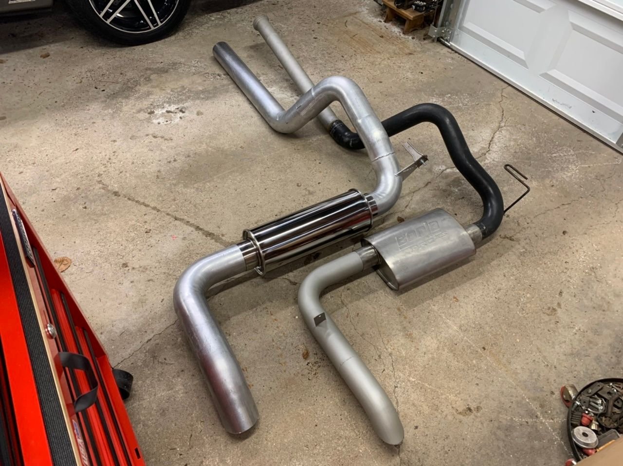

I built my own because I'm a cheap bastard and shipping is expensive. Full stainless. Sounds pretty ok
