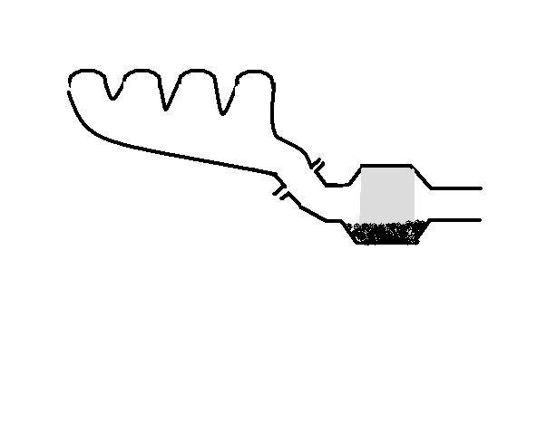

I know a lot of folks here are not running cats. I'm still not completely sure I'll run them myself. If I do, however, how picky is position of the cat?

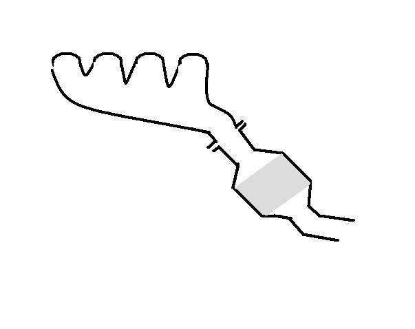

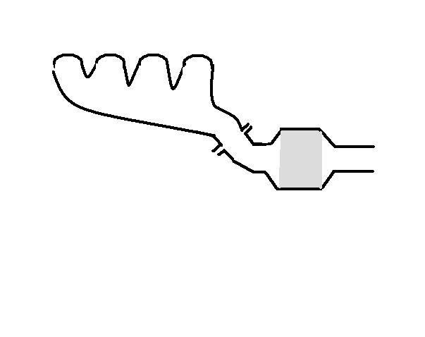

The factory mounted the cat so it could drain completely(pic #1). I'm proposing mounting the cat in a more horizontal position where it won't completely drain(pic #2). I'm concerned it will accumulate soot and condensation in this position(pic #3).
Is this a valid concern? Does the cat have to be positioned so it can "drain"?

In many cases, cats are mounted horizontally so there is little or no "drainage" other than the exhaust flowing through the cat.
The cats are mount close as possible to the exhaust manifolds to help them heat up quickly to start scrubbing the exhaust.
You're saying that manufacturers have installed cats with a "pocket" like shown in pic #2 and #3? If so, that would ease my mind considerably! Mine would fit a lot better if I could angle them up from the factory position.

There is no need for drainage. As they heat up, any condensation cooks out. My 04 Tahoe has the left converter angled and the right one horizontal. I don't know where you get that they need to "drain".

It's not as much condensation I was worried about, as much as soot and particulate matter. I really wasn't sure that was even an issue. I just thought I'd check before assuming I can mount the cat like I want it.

All particulates and soot blow through and out the pipe. Converters have been around for 45 years now. Not much new with those anymore. Be more observant and look at more cars and trucks.
