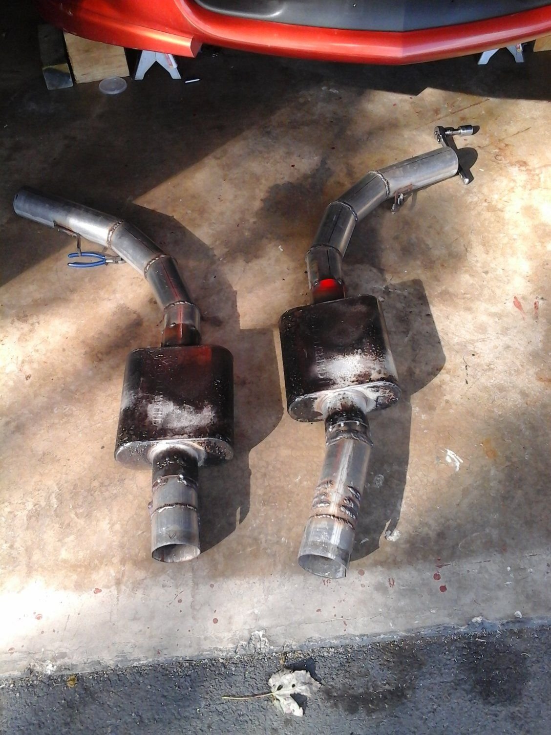

Old May 17, 2020 | 04:09 PM
tug686spd's Avatar
Joined: Mar 2008
Posts: 800
Likes: 16
Old May 17, 2020 | 04:28 PM

Old May 21, 2020 | 11:08 PM
tug686spd's Avatar
Joined: Mar 2008
Posts: 800
Likes: 16
Originally Posted by billymgb1000
Hey tug686speed I have to know what mufflers do you have on that. Thank you!!!!!
That car is 3" flowmaster 40 series mufflers. That exhaust wast about identical to my current cars exhaust except this car is 3-1/2" with cherry bomb extreme mufflers. Current car has vids in thread https://ls1tech.com/forums/drag-raci...arts-pile.html.
