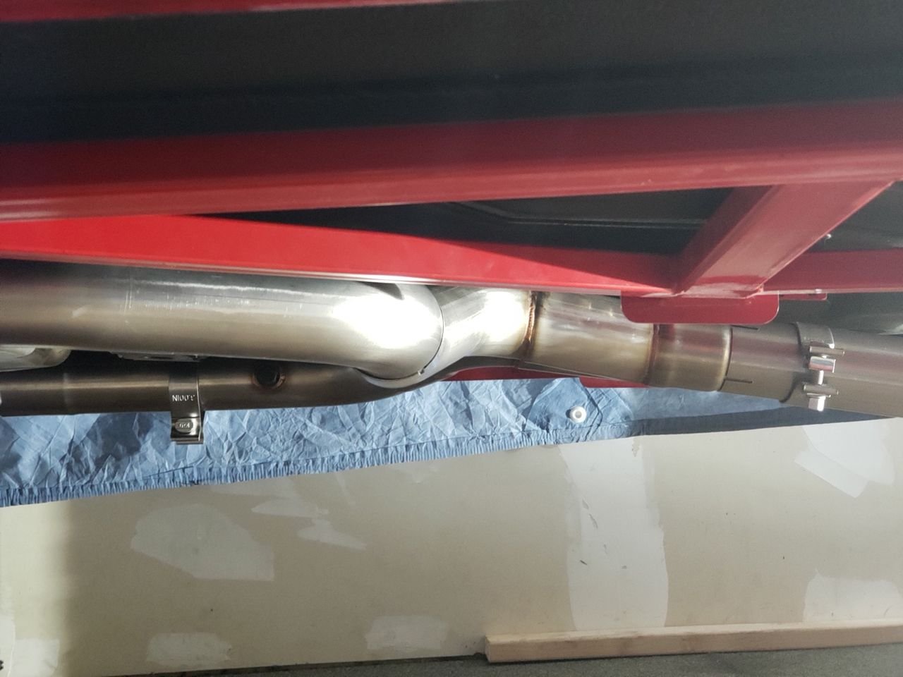

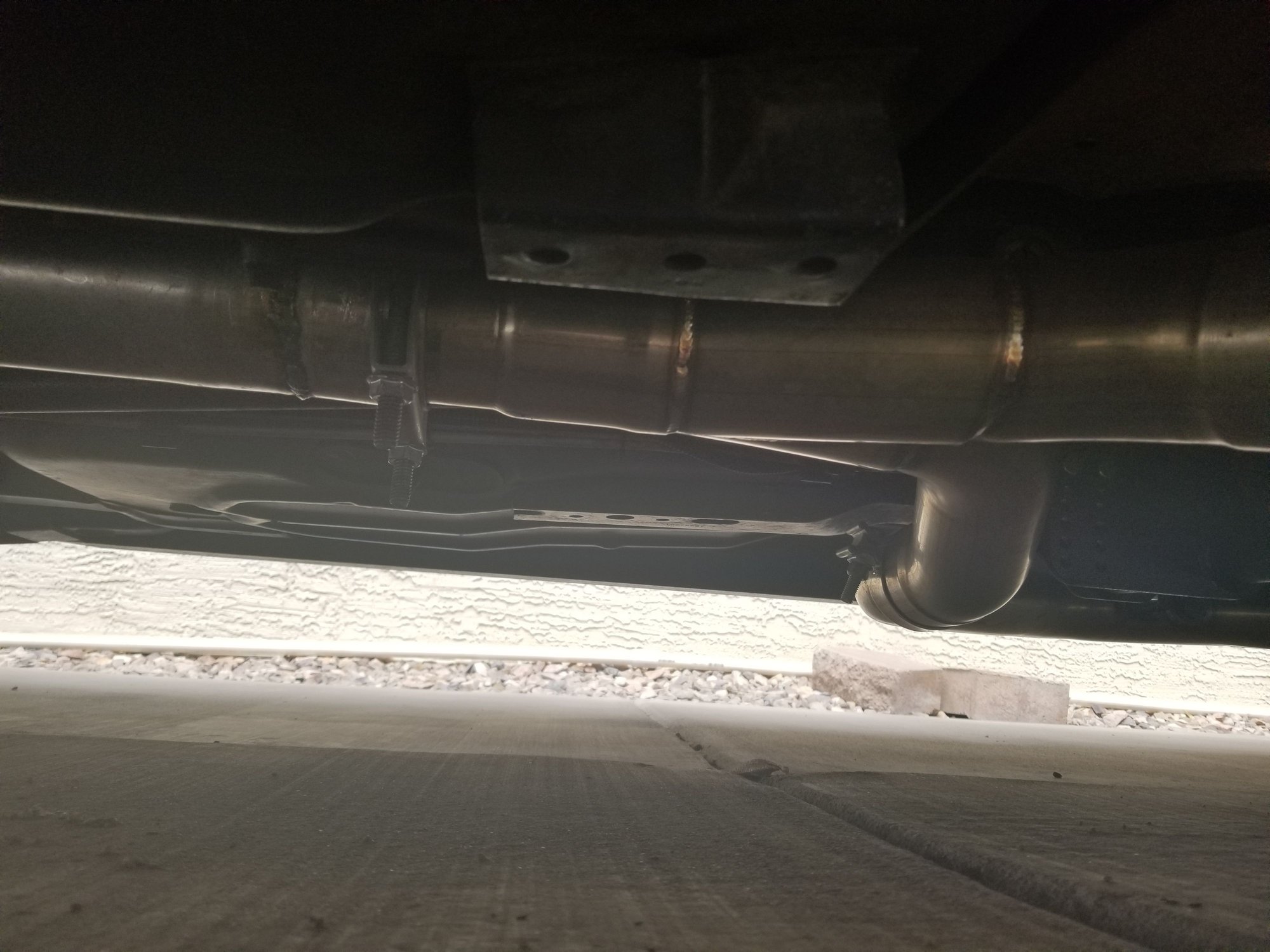

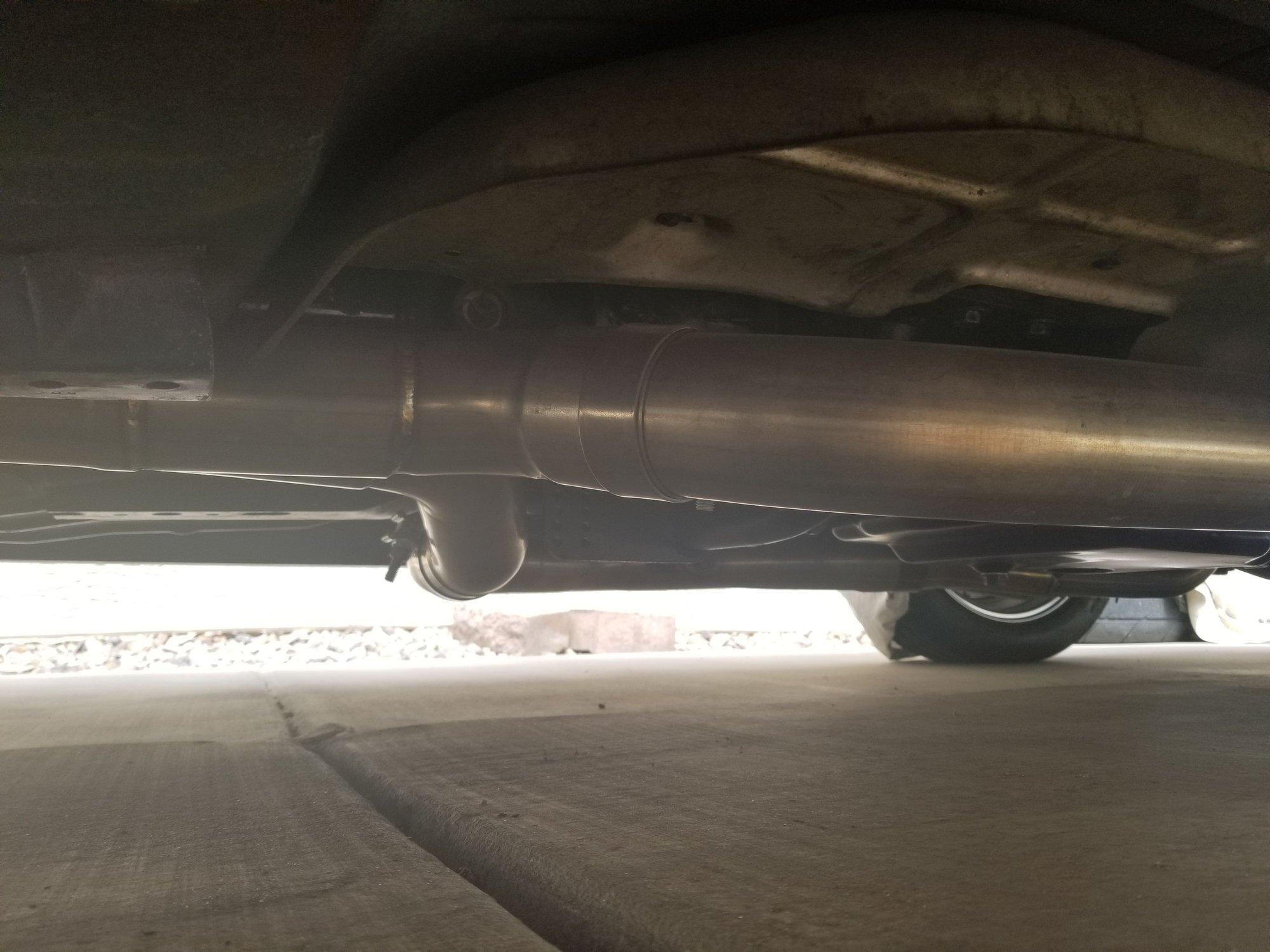

Anyone have pics of the redesigned y pipe intalled. I am trying to get mine installed and the y pipe portion is hitting everywhere. Can not get it aligned with the magna flow catback exhaust

lets do it this way . Post pics of what you got going on there

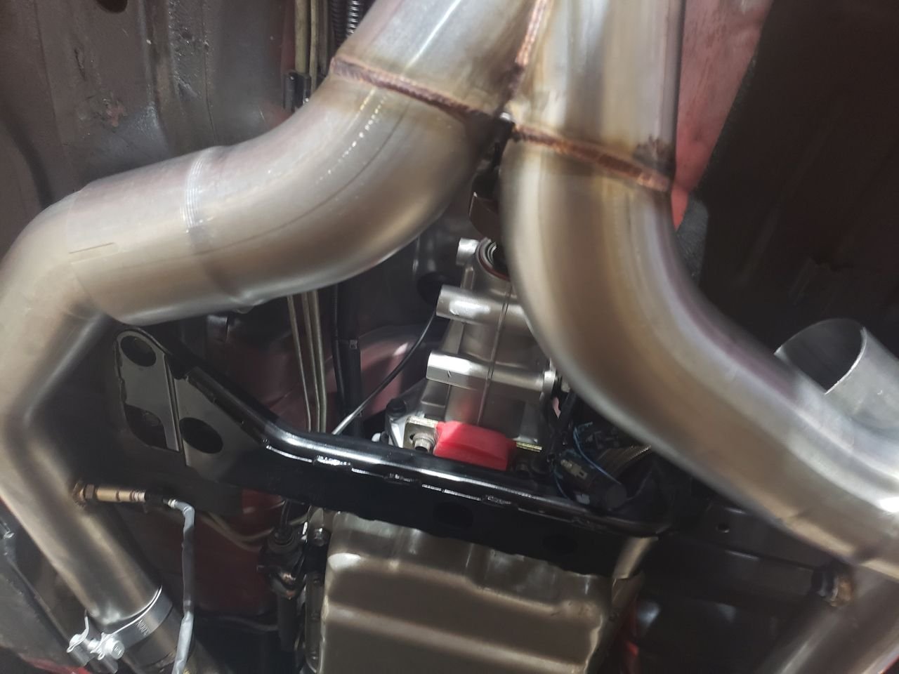

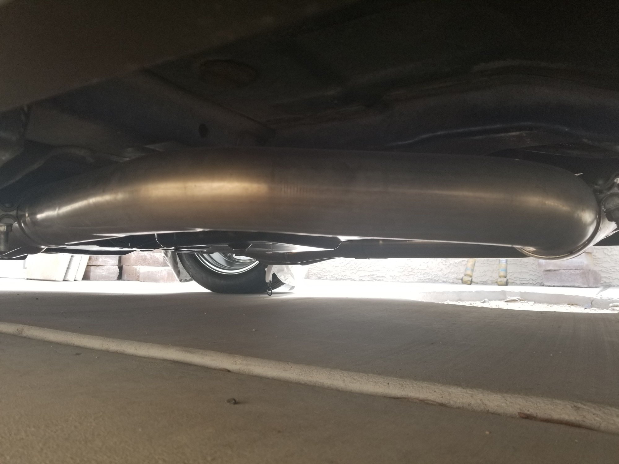

The angle is the biggest issue. It is extremely tight trying to get crap to "adjust" off the collectors etc. My older TSP before redesign (they flattened the drivers side pipe and made merge section on less pipe) fit much better.

Looks upside down. Flip y the other way and I think the pipes coming off headers are wrong too. Can i get a couple more pics of the pipes from headers to the y

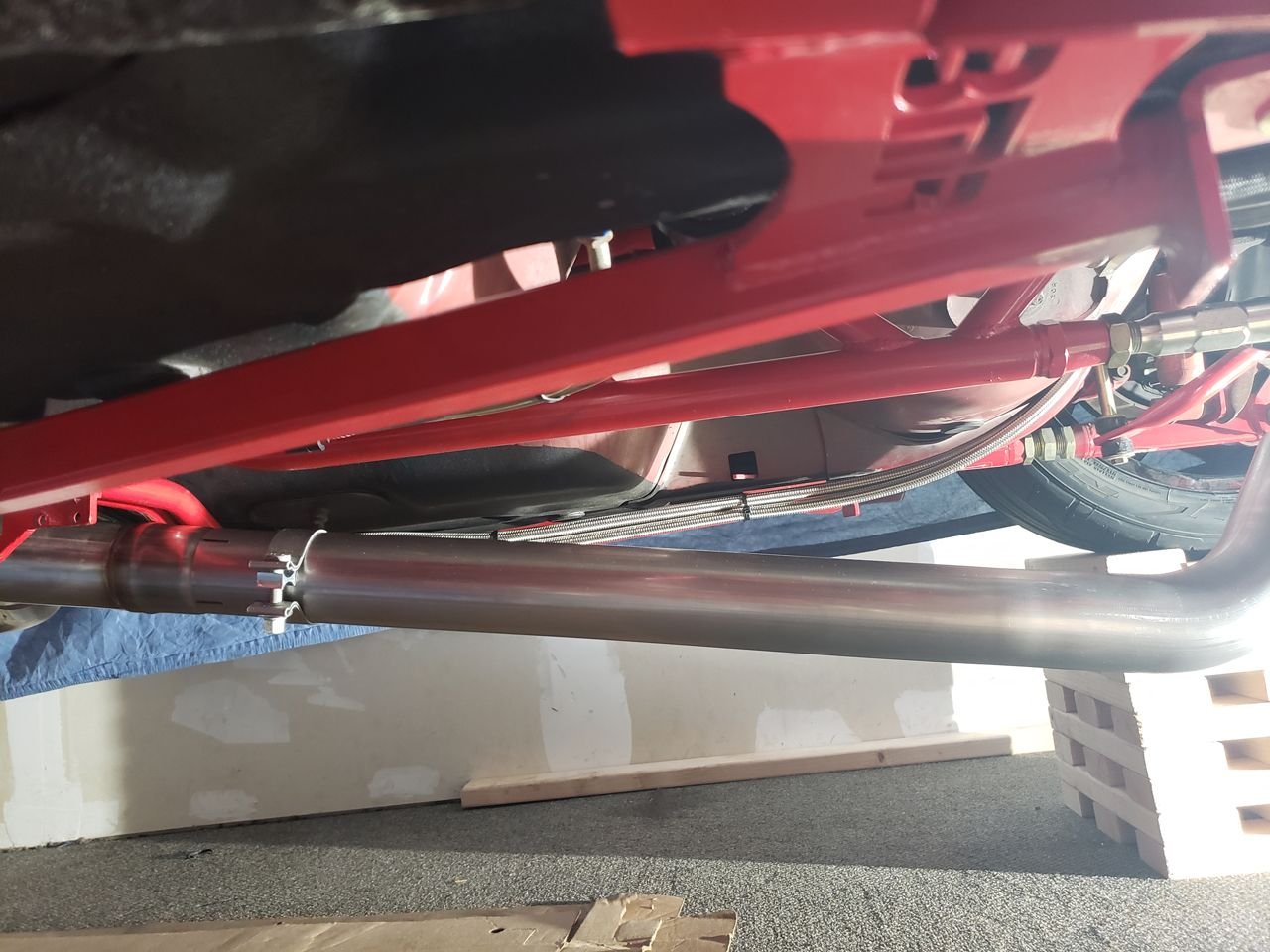

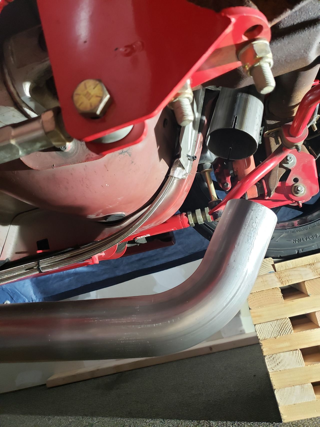

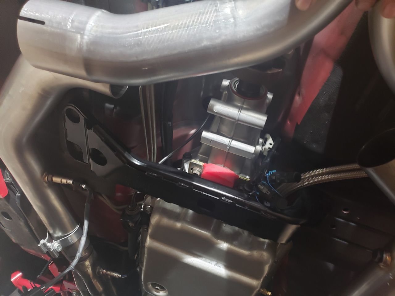

If i undo the passenger piece it will tuck up more level. You can not flip the Y over as it will not even remotely align with anything.

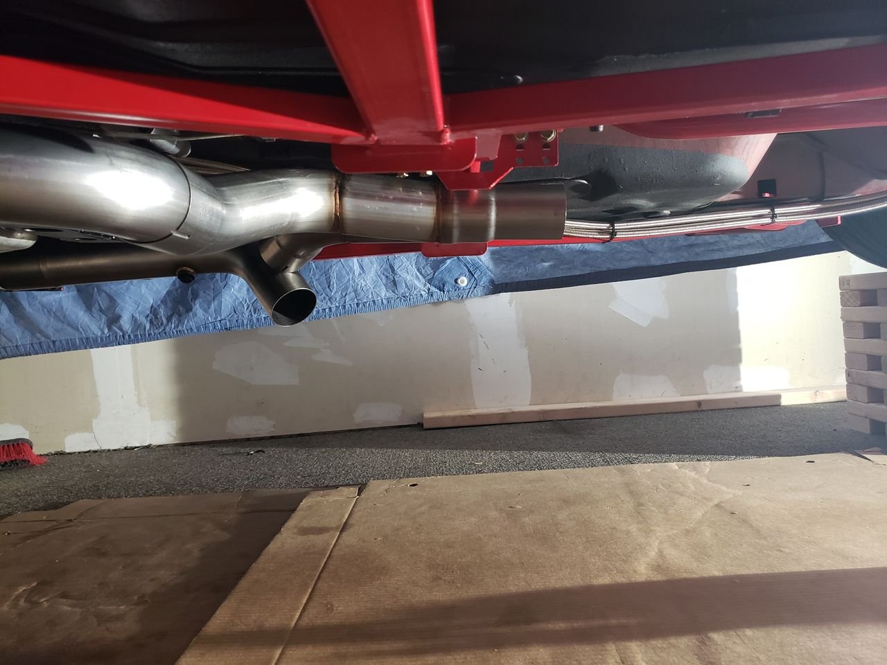

Old Jul 12, 2020 | 12:25 PM

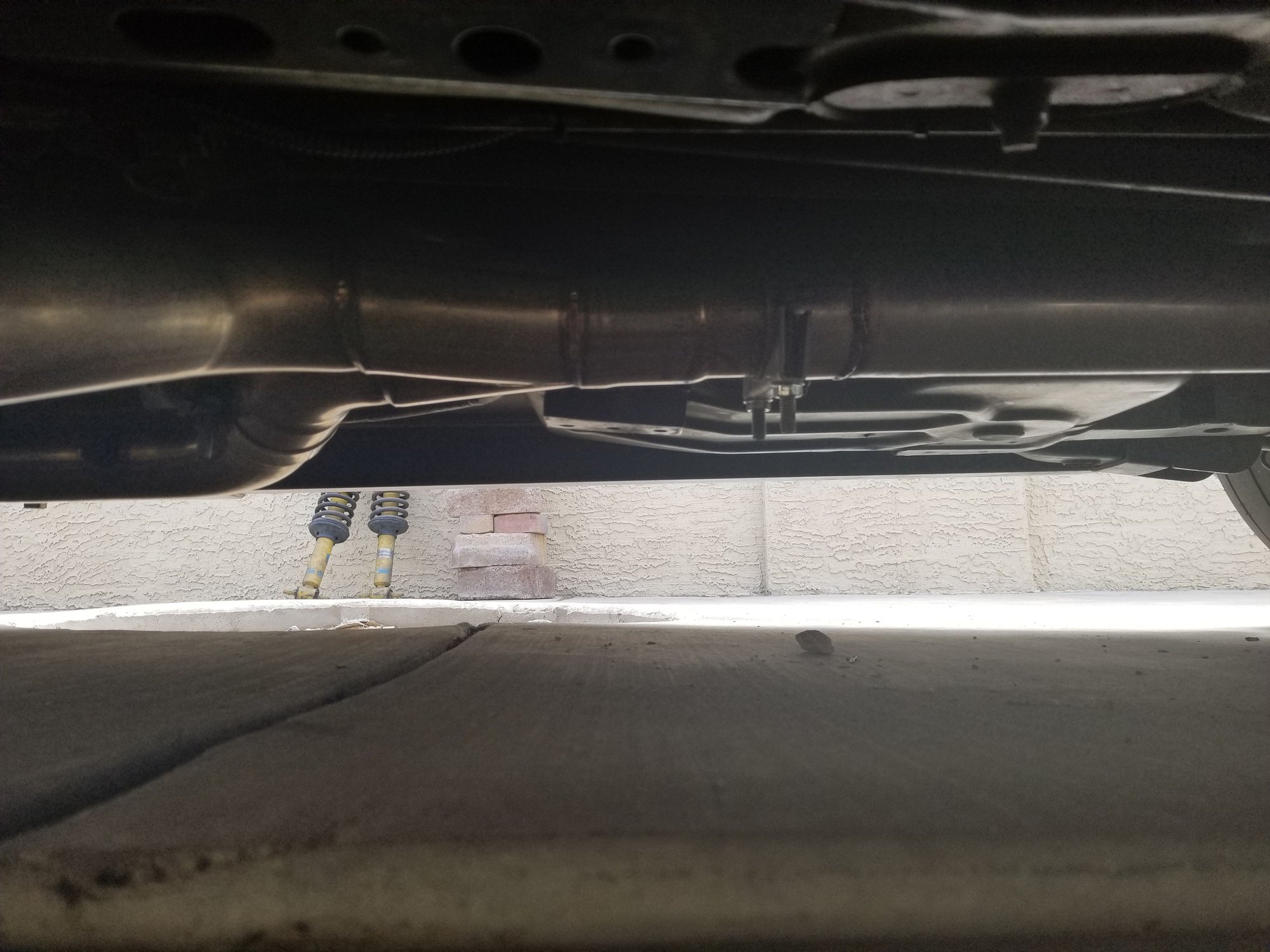

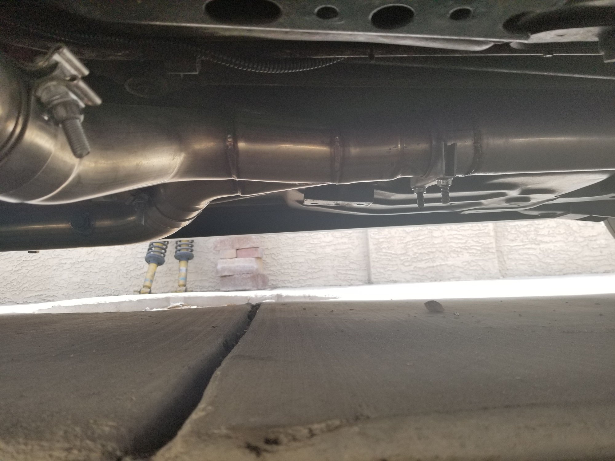

Old Jul 12, 2020 | 12:42 PM

Yours appears to be "riding" above the tunnel brace... which mine must go under it as I have a short torque arm mounted there
then your brace is the issue.

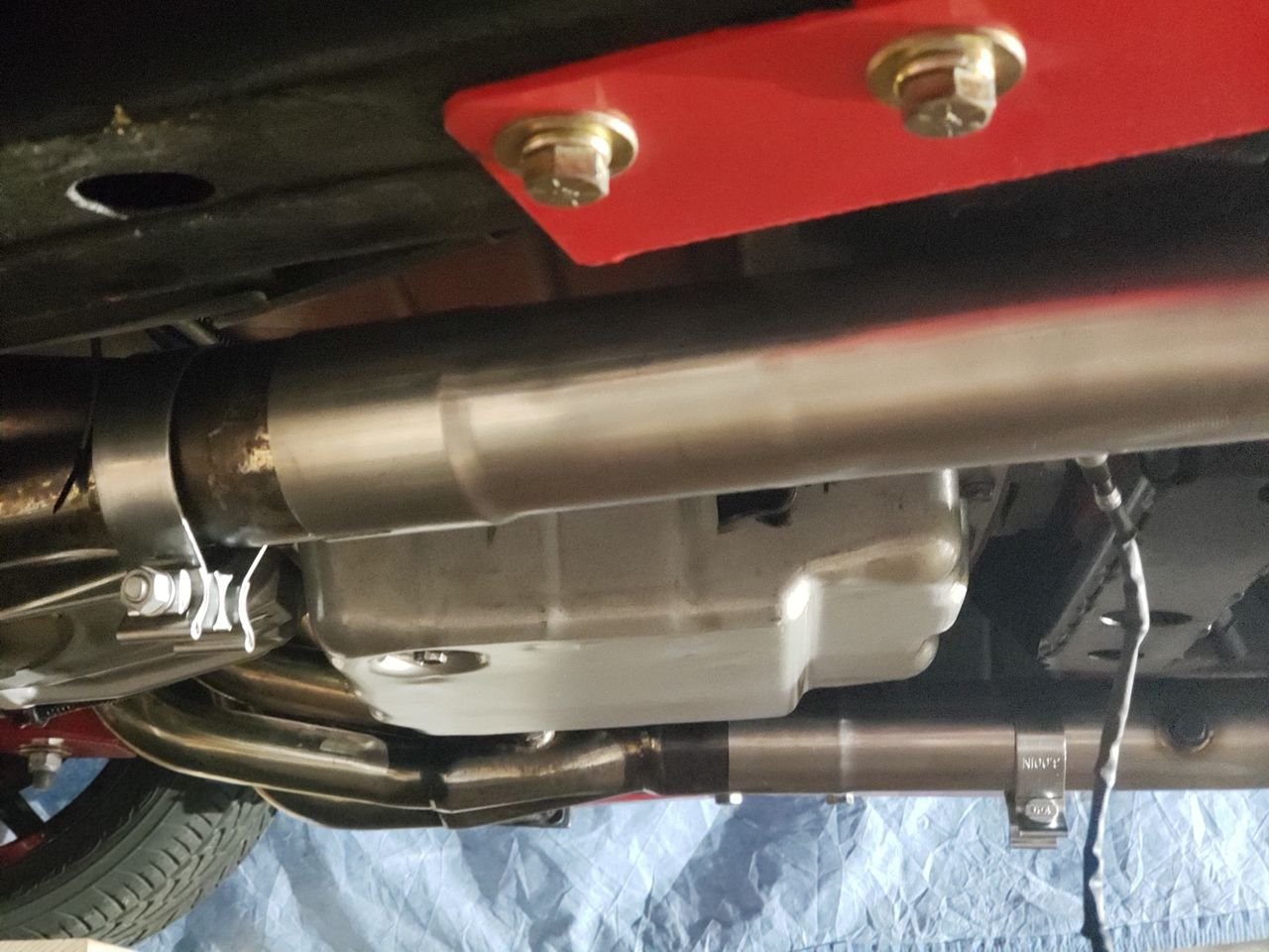

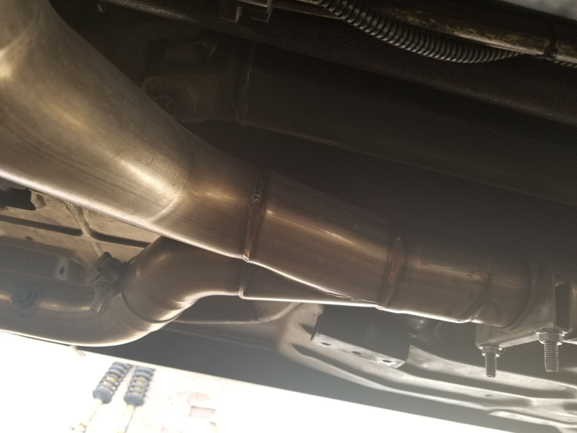

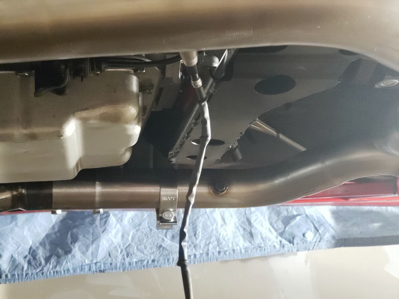

Horrible attempt but kinda shows the y pipe cant be flipped.

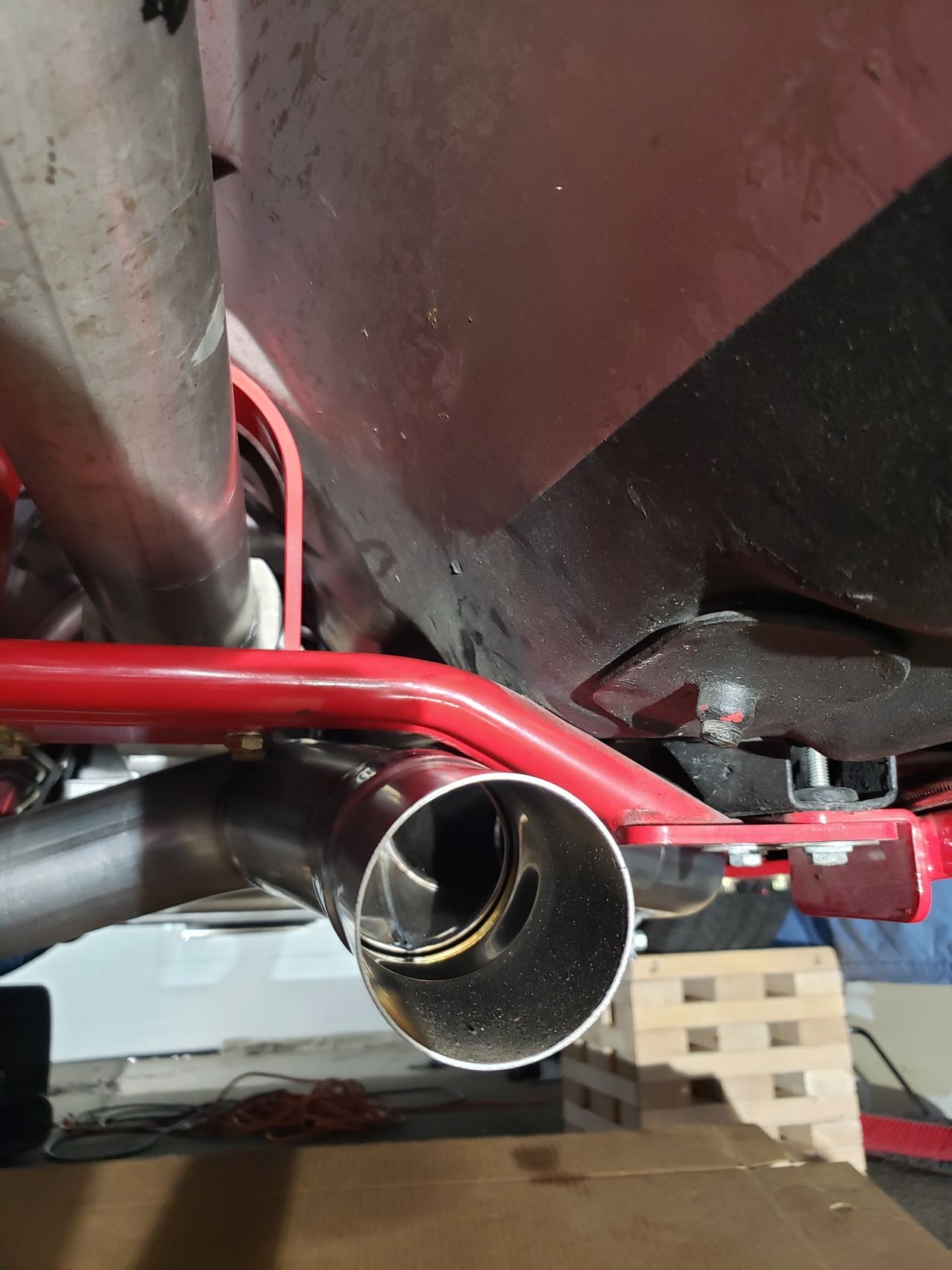

Compare this pic to yours. Is your y pipe merge exactly like this for the pass side? See where I have it clamped?

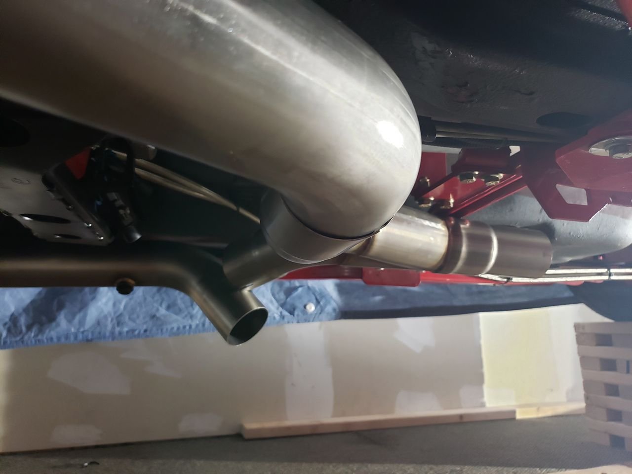

The OLD design worked just fine with the tunnel mount brace. I only updated to the new design because i was redoing my whole exhuast from the headers back.

It looks like the TA mount is interfering with the Y. I dont have that issue because I removed the mount all together. You may need to get creative to get this to work.

They likely designed to get it to tuck more for clearence.
