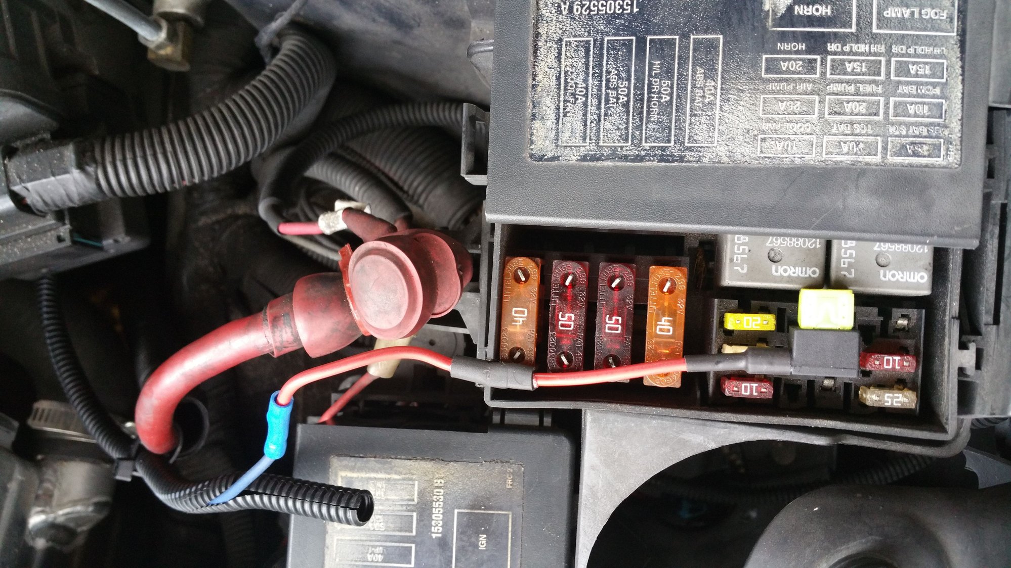

I would suspect the t tap more than anything else. I've had a ton of trouble with those things not piercing the wiring well enough, and even when they do they don't hold a very good connection.
I would cut the wire and use a weather proof butt connector, they crimp and heat shrink down. i use those a ton in automotive wiring and love them because when they shrink they also emit a sealing goo that seals the connection.
Solder and heat shrink works, but you need the sealer to keep the connection from seeing moisture.

I'm not exactly following your suggested changes; here's a photo of how it's currently connected to the fuel pump socket. I temporarily pulled some of the blue wire out of the loom to show it. The black in the middle of the red wire is simply a sleeve to act as a grommet when it passes through a small U-shaped opening created in the edge of the fuse box. If there's a better solution than connecting it to the fuel pump socket, I'm open to all suggestions.

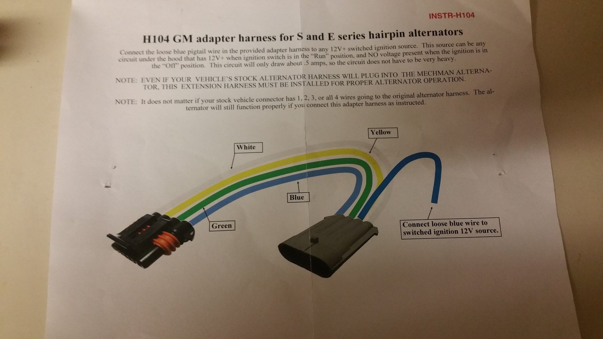

And the provided docs are below. I do not have a fuse anywhere in my charging system as suggested; I have the complete OEM sound system.

"I got the answer. The harness is correct. The exciter wire connects on the car side to turn on the alternator AND to turn off the battery light. It has to be connected to an ignition voltage source (12VDC when the key is turned on)."

Took the car back to the shop, and the tech spoke with Anthony at Mechman. Anthony said to check the yellow wire coming off the alternator to see if it was hot with key off. It was hot, so Mechman is going to email me an RGA. Looks like I need to pay for shipping one way, and labor to replace the alternator twice more. Until I get this alternator removed I'm going to be pulling the tap connection in the fuse box before the car sits for long periods of time.
