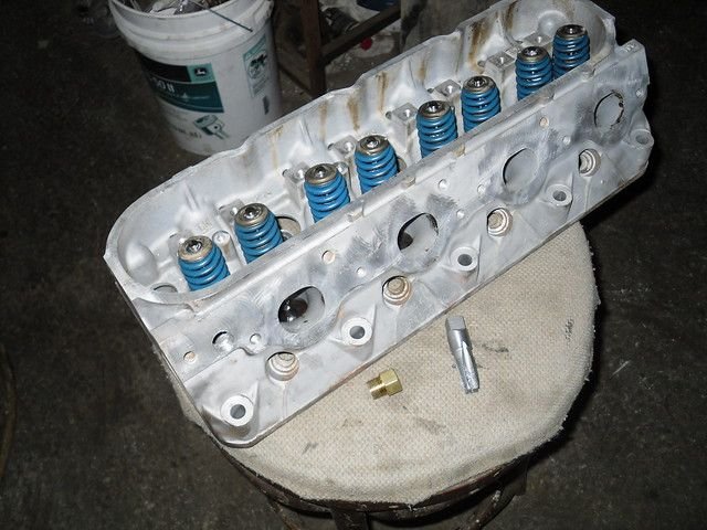

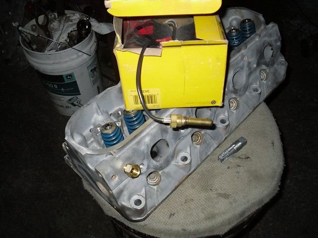

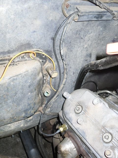

Originally Posted by homers442
Where is a good place to tap for gauges on a 6.0 truck motor?
This is what I did...
