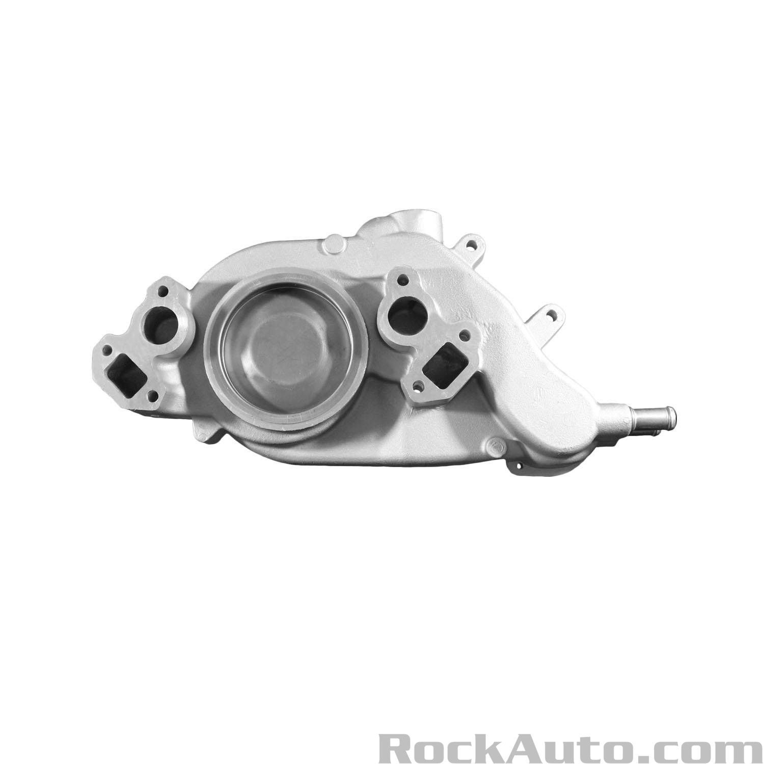

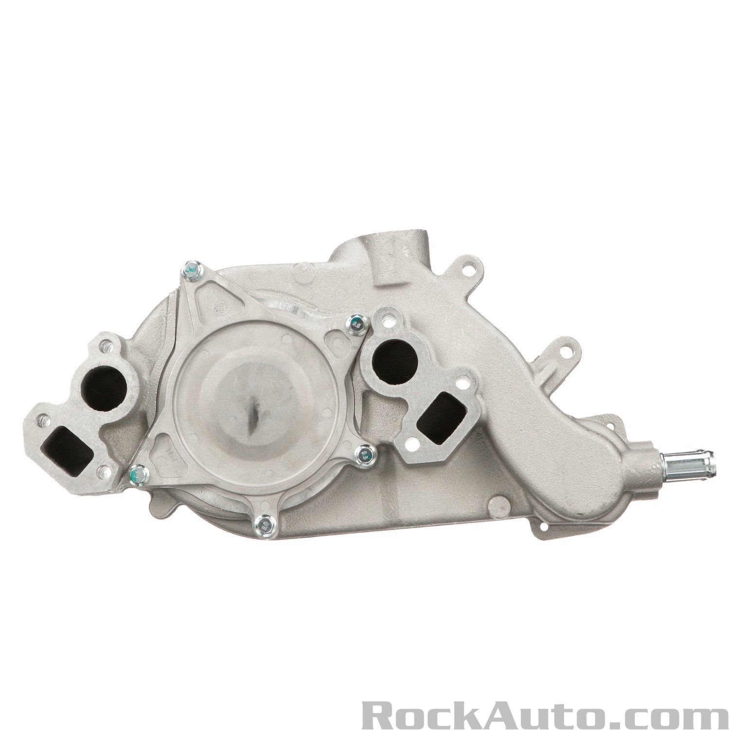

Yes that looks like the correct water pump. If you look at the back of the pump, There's a huge plug that is pressed in that covers the impeller.
On the original style, it had a plate that bolted to the pump instead of that plug. The mounting bosses where the plate bolted into caused the issue with the larger intakes and throttle bodies.

No worries. I figured I'd post the pictures to help anyone new understand what the differences are and why you need the updated pump.
