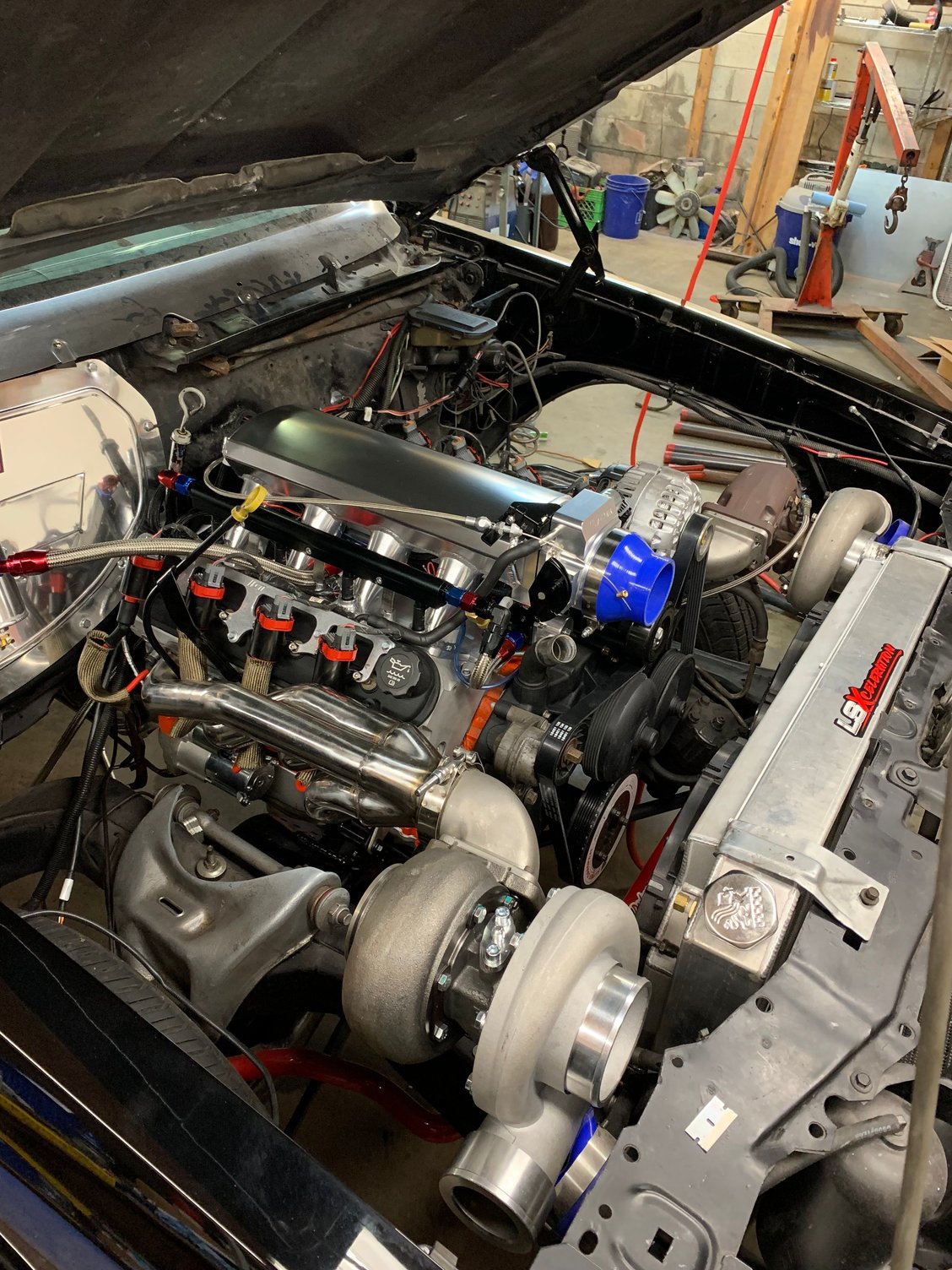

Hello everyone. New here to the LS world but not new to hot rodding. I built a 5.3 gen III LS that will eventually be twin turbo’d. Summit turbo pistons (about 9.7:1 compression) H-beam rods with a Texas speed forged crank. Stock refurbished heads. Snake eater SEP1500 cc injectors in an Amazon fabricated intake with 102mm TB. Brian Tooley stage 4 cam. Can’t seem to get it to light off. Have fuel and spark. All lights are reading correct. Checked coil harness colors to make sure they’re on right. Even tried swapping odd and even to the other sides to see if they were mislabeled. Checked timing by using piston stop and finding TDC and putting a pointer on the ATI super damper. Checks good with what was programmed by the terminator. Pulled the intake up and watched the injectors squirt to confirm they’re working. They are. Tried timing up. Timing down. Fuel flow increased. Decreased. Starting fluid. I can make my headers warm but that’s about it. Pop out the pipes and the intake on occasions. I’ve got probably 10 years on my starter already. Lol. Got the grounds on the back of each head. Proper fuel pressure. Im out of ideas. Any suggestions I will try!

The Terminator x has LED’s on the front to tell you if your crank or cam sensors aren’t working. Mine both check ok. Have checked timing by using a piston stop and setting a piece of Tig wire as a makeshift timing mark. Checked all 8 pistons for timing as well as order. All checked ok.
