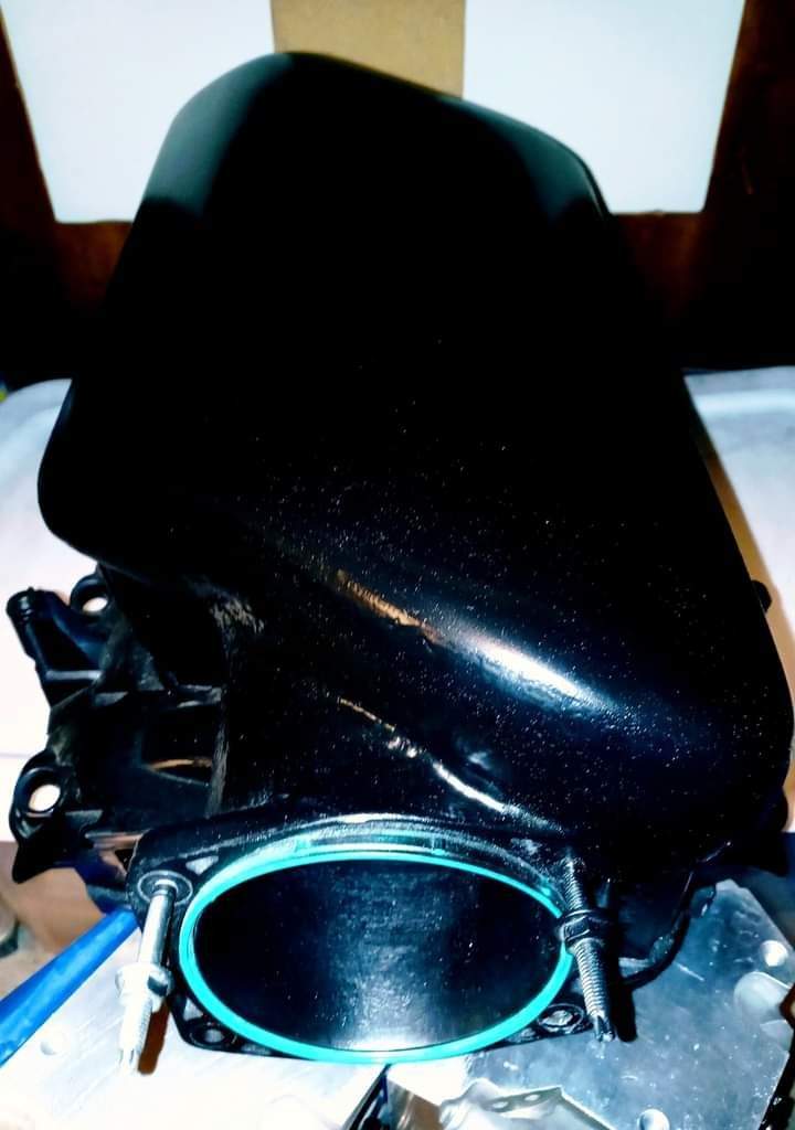

That Amazon link is for the 08+ TBSS. It uses a gen4 MAP and doesn't have the vacuum nipple for the PCV. If you have a gen3 engine... part number 12580420 is an easier fit with the correct MAP port size and PCV nipple.
OP I'm running the TBSS (12580420) with a Nick Williams 92mm on a Gen3 LQ9
Attachment 712339
