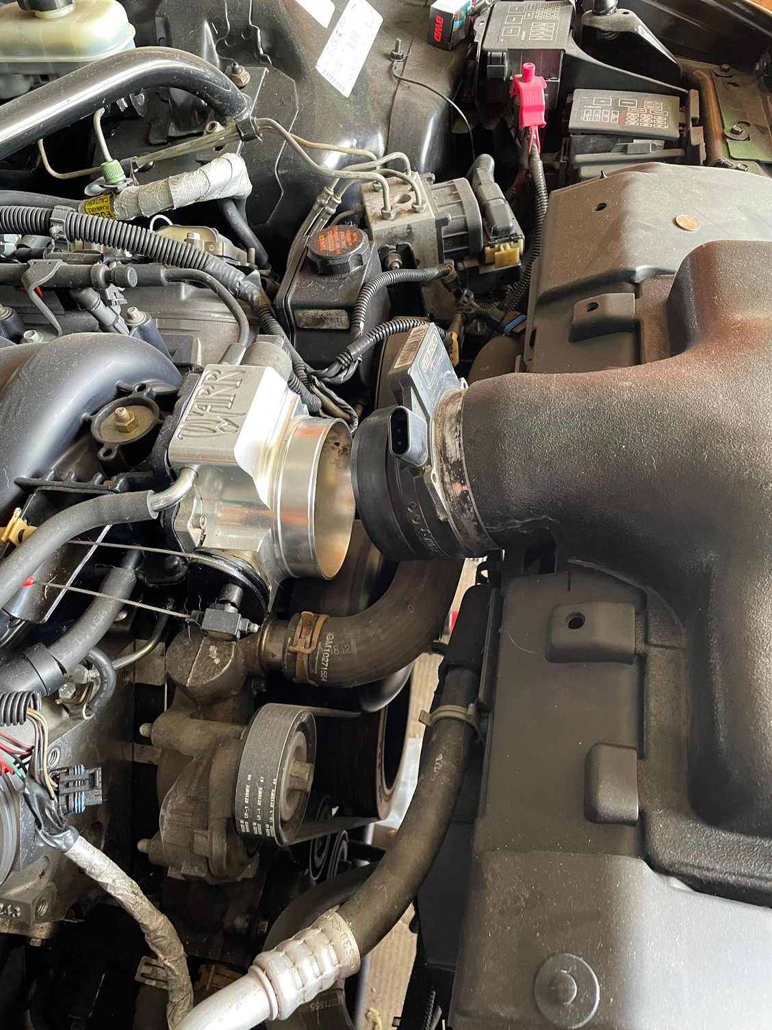

So long story short I was in a motorcycle accident spent almost 2 years getting surgery’s and healing up so I have not been able to even mess with my car
before the surgery’s started going I finished up the H/C/I swap but never got the car tuned or drove it now I’m in the garage cleaning up the car and getting ready to ship it over to the tuner and I need to order a bellow to link the maf to the TB how do you guys have yours set up? I have a 92mm TB and 85mm maf
Also while I’m thinking about it should I upgrade the MAF before I send it off to get tuned?

The stock accordion bellow will work with the 85mm MAF and 92mm TB. If you have the 85mm MAF, that is already an upgrade over stock.

WS6Store has a very nice coupler set up for that. I can't recall the part numbers but they are just a phone call away and very helpful.
BTW - if you want the 100mm MAF & coupler set up WS6STORE can also provide those parts as well.
Don't have the stock one it seems to have grown legs and walked away lol
I will have to take a look again on their site the only one that I seen was a bellow that replaced the stock one

On my 00' WS6 I went to home depot with the TB and MAF and bought a plumbing fernco--did the job and looked OK
