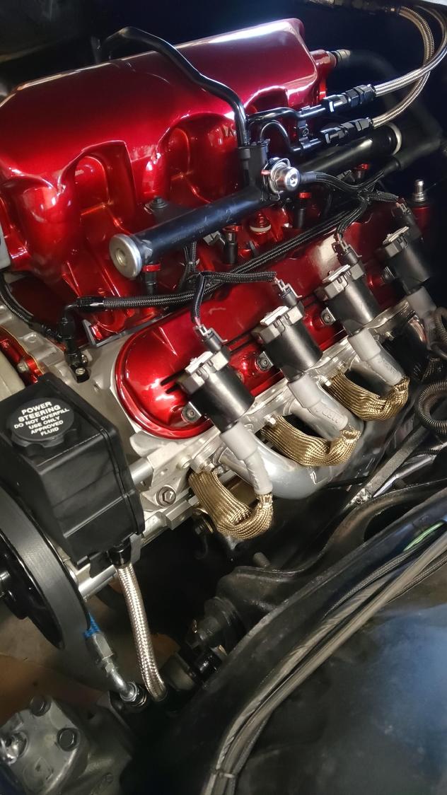

How far is the factory truck intake from clearing the hood? I made mine fit in my '71 Camaro swap with a 2" cowl induction hood
I shaved, smoothed and painted it
