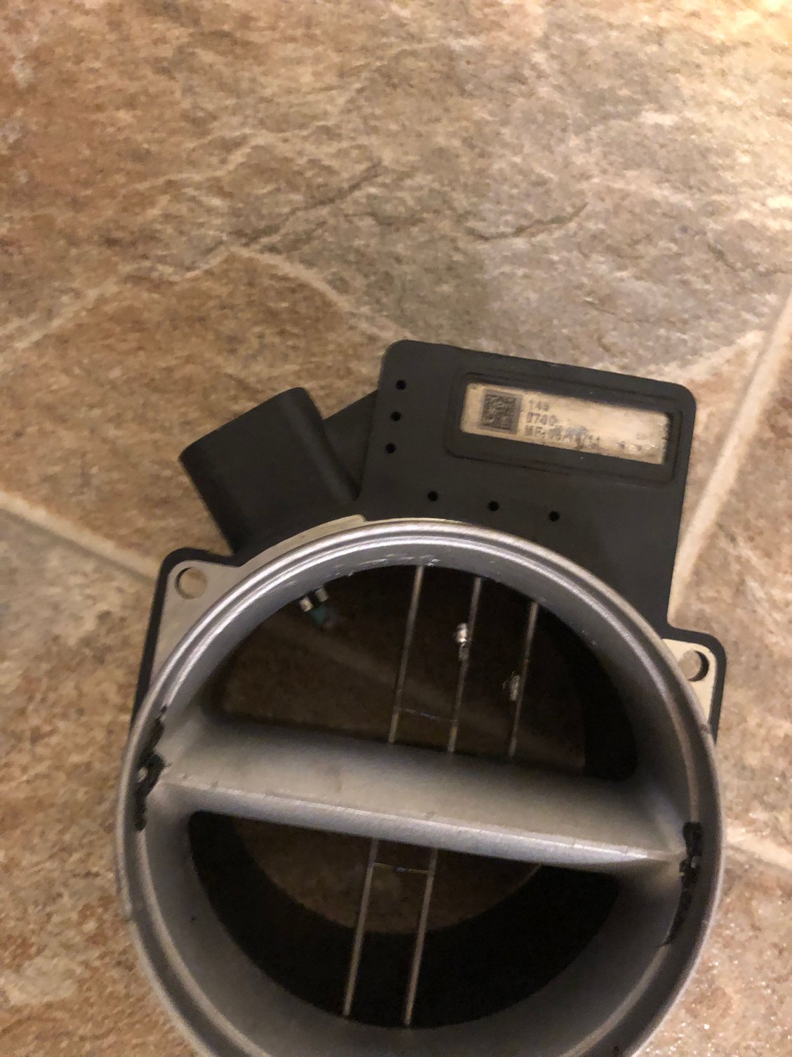

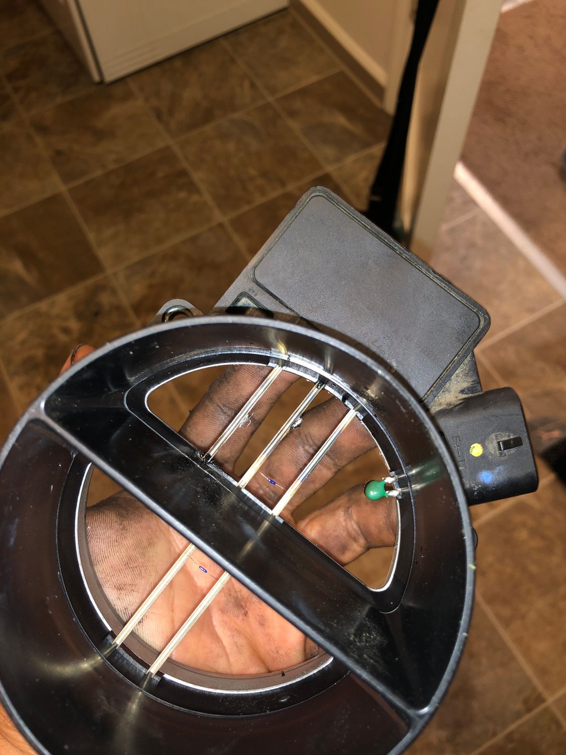

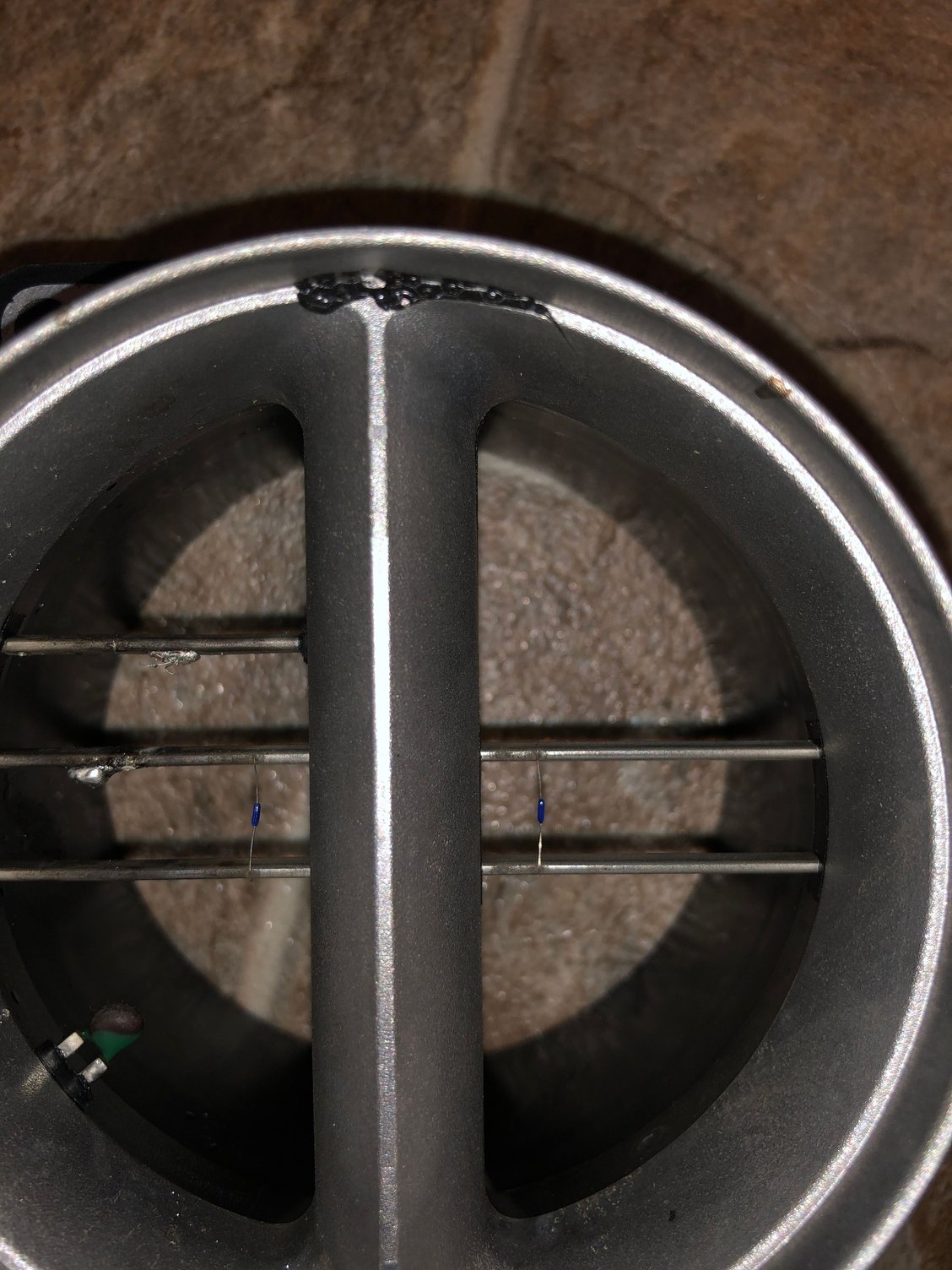

I have a 2004 Silverado that has a lq4 with hci and a 100 shot of nitrous. I was messing with the intake a little bit and damaged one of the maf resistors by accident. Went and bought a new ac delco unit and truck bogs with black smoke at 4k rpm. Ran great with original maf. One thing I noticed was the resistor colors in the original one had blue ones and the new one had grey ones. Any help is greatly appreciated I really want to get this thing back on the road. Don’t mind the ghetto soldier on the one side I tried to see if I could soldier it back together.

Did you break the housing on the old sensor? Maybe trying using the new housing and removing the old sensor and put it on the new housing
I’ll see if I can get it apart. Thank you

I’m gonna bring it to a computer repair store and see if they can soldier different resistors on the new one. Thank you for all the responses I’ll post if it fixed it or not.

I just pulled one of the blue resistors off of the old broken maf and tested it with a multimeter. I only got 23.8 ohms?

I believe ohm resistance is around 2.0-3.0
