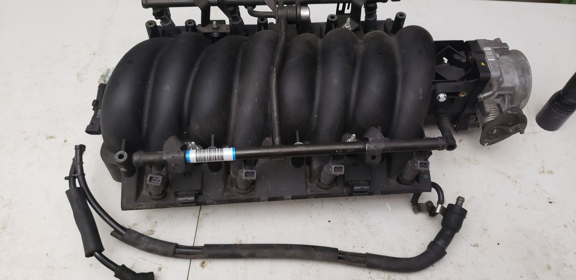

That dosen't sound right at all.
In stock form the driver rear port was connected to the passenger rear port and then it ran to the intake manifold port. Notice the inline PCV valve at the end of the line before connecting to the hose on the intake manifold? You could do something like this by running a 3/8" T and connecting the back ports of the valve covers and then run a third line up to the intake manifold with an inline PCV valve at the intake manifold. You could also invest in a sealed catch can and have that line that would normally go to the manifold go into the can and then out of the can to the manifold with an inline PCV valve between the can and the intake port of the manifold.

Thanks for the picture, from what I have read that hose system was discontinued years ago.
I hesitate to change anything since everything seems fine as is.
I am mystified where the crankcase pressure is being relieved.
I don't understand the need for a catch can if the stock setup works properly as originally installed .
I don't understand why it was plumbed to both valve covers for pvc with fresh air being supplied to one of them instead of the conventional way of fresh air to one and pvc to the other.
I don't understand what the restrictor plate does in the driver's side cover.
I am considering adding a hose from driver's side v/c with a pcv inline to the intake and leaving the rear port capped off with front port connected as it is now to throttle body on the passenger side v/c.

That would certainly work and really no need for a catch can. LS engines have ran for many many miles without the use of a catch can but it is a way to cut down on the gunk that finds it's way into the intake manifold.
