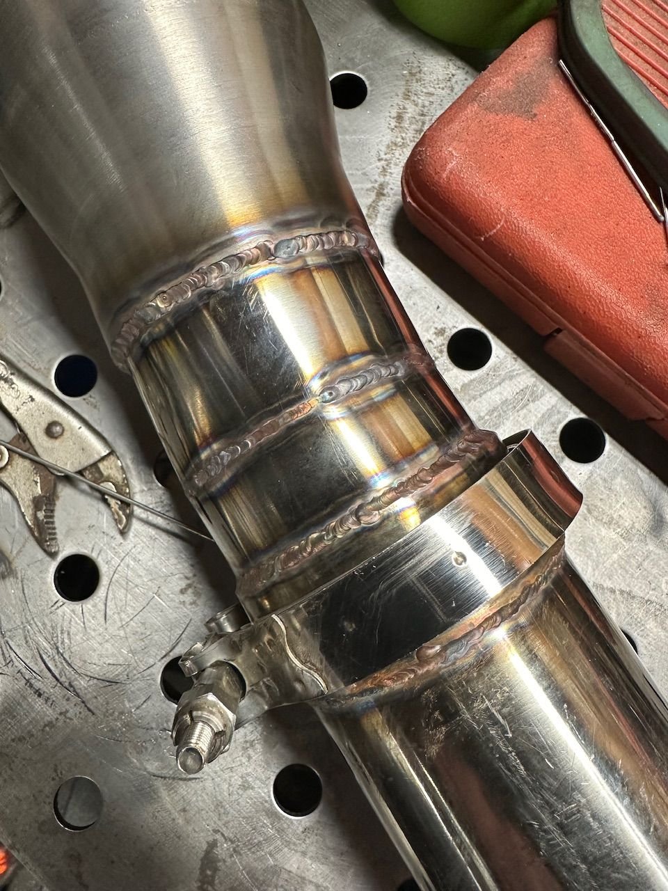

I ended up welding on 1.5” of 3” ID 304 I bought off Amazon (basically a 3” ID coupler) so I got two pieces from one coupler. Welded that on the one end so I have more clamp/slip for the header collector and clamps. I can always slit the welded sections for a 3” narrow band clamp. I finished it up all last night, all 304ss. The welds aren’t perfect but they aren’t bad. On the last 2 pics I had to make a slight bend as it wasn’t perfectly straight so I took out a mini pizza slice and bend the tubing to give me what I needed. Didn’t warp the vbands so I call it a win and should be leak free and hopefully smell less.
