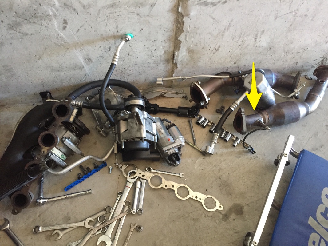

These pipes are 2.” But the pipe they bolt to are 2.5.” Would you still get the 2.25” cats or would you get a 2.5” cats? I don’t think there’s enough of the 2” pipe to cut and weld the cat to, so they’ll probably be cutting it after the flange, at the 2.5” section.

They can cut further back on into the 2.25" cat, or what ever you buy. They can use reducers, cones, or something more hamfisted to get the size needed. Been there, done that.

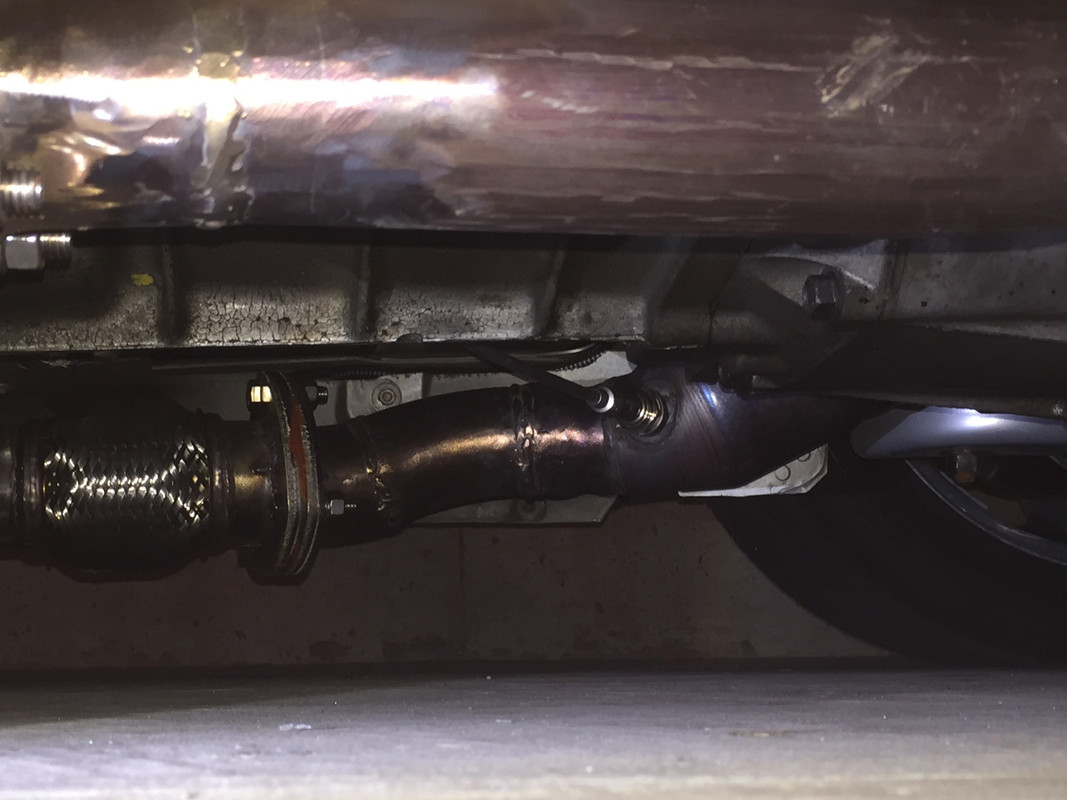

Thanks Lee. One more quick question. I know I’m making this harder than it should be, but I was looking at the oem cats and I noticed how close they are to the front O2 bungs. I was shopping for cats that didn’t have bungs prior to realizing how close the O2’s were. Should I order cats that have bungs? Will the O2 in the cat mess with the 02 readings?
I guess a shop could use a section of pipe that has a bung if they had it on hand. But I bet that’d cost more than just putting the 02 in the cat. If the harness will reach I guess.

The front o2 bung on the passenger side, the shop will just reuse that length of pipe, post manifold flange. The driver's side o2 is on on exhaust flange, so the o2 does not need to be touched on the driver's side
The rear o2's don't matter since you're eliminating them, but they can weld on the existing tubes that you have. The shop will, or they should, chop out the cats that are installed presently, and weld into place, between the existing sections of pipe, the new cats. No more complicated than that.
