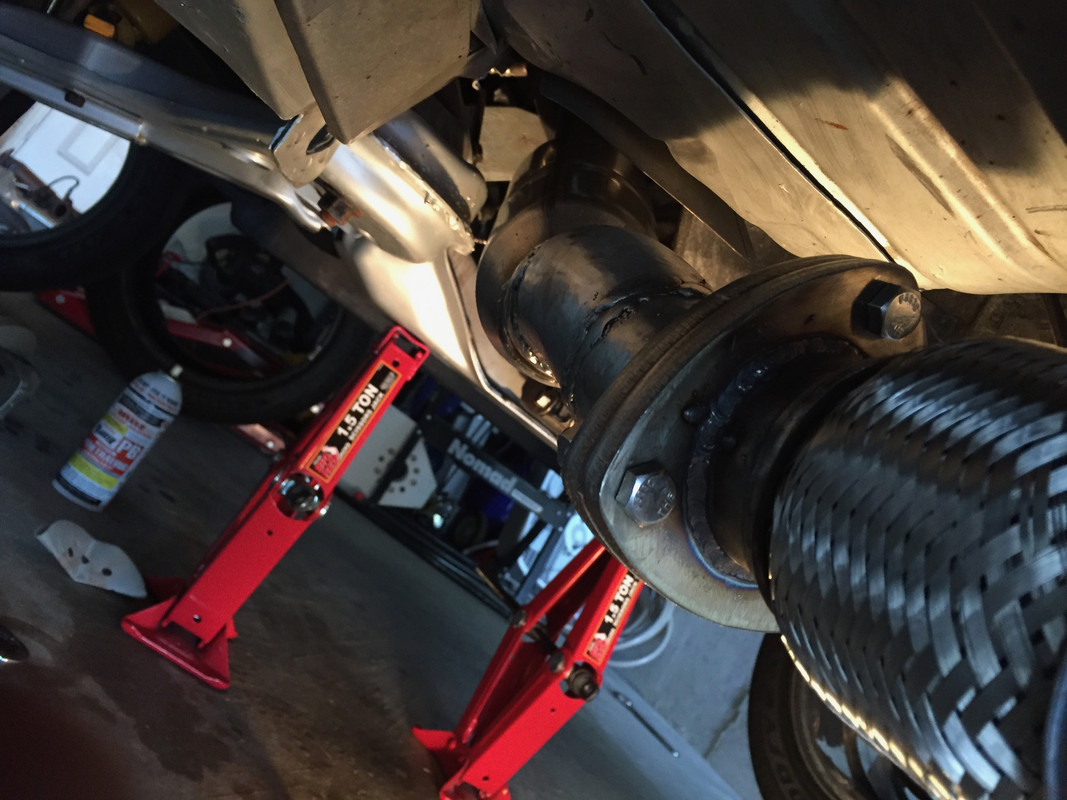

Do y’all think a shop could weld these in somehow? They’re 3” diameter and 11” long. I think the cat without much pipe before the flange might make it hard to get a universal set in. But maybe it can be done.
Not much room to cut & weld
Universal cat $72 a pair Universal cat $72 a pair

I don't think those would fit without some creative welding.
The only "test pipes" that I know of that were made as a direct fit for the 2000-02 LS1 F-body were the Mufflex pieces, they were 409 stainless and they did fit excellent (I used them on my '00 car before I had headers). I think they were like ~$100 back then (this would have been 20+ years ago). A couple places used to sell an entire ORY pipe for the stock manifolds as well, but I never had one of those.
You'll probably have to cut the studs on the ball flange (Y-pipe) end, which isn't a big deal, but if the studs break in the manifold end that's going to be a bigger problem. That's fairly typical at the age of these cars. Most folks are pulling everything to do headers anyway, so it doesn't really matter in their case. I would soak them excessively in PB Blaster before even attempting removal (heat might help as well). Or, if you just want to hollow it out, you might be able to do that without pulling the manifold end (though it would require some creative use of flexible rods, etc.)
