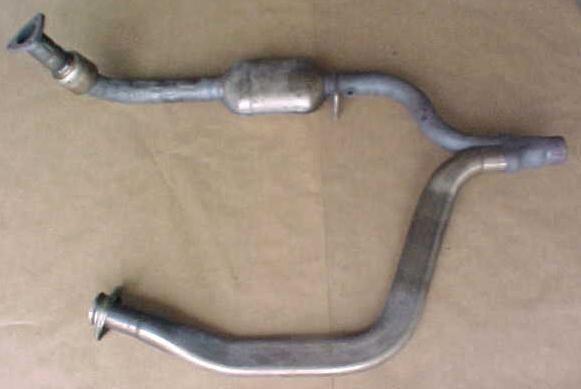

When I checked the temps it had only been idling 5 minutes. Thanks for the heads up on the O2’s rattling. Know what is weird to me about the rear O2’s? The distance difference between bank one and two. The passenger side rear O2 is way down there compared to the drivers which is right after the cat.
This is probably a left-over wiring harness routing/design element from the earlier '98-'99 exhaust system (where the passenger side cat was located further downstream than the driver's side). The passenger side cat was molded into the pipe and much further back on the earlier LS1 F-bodies:
