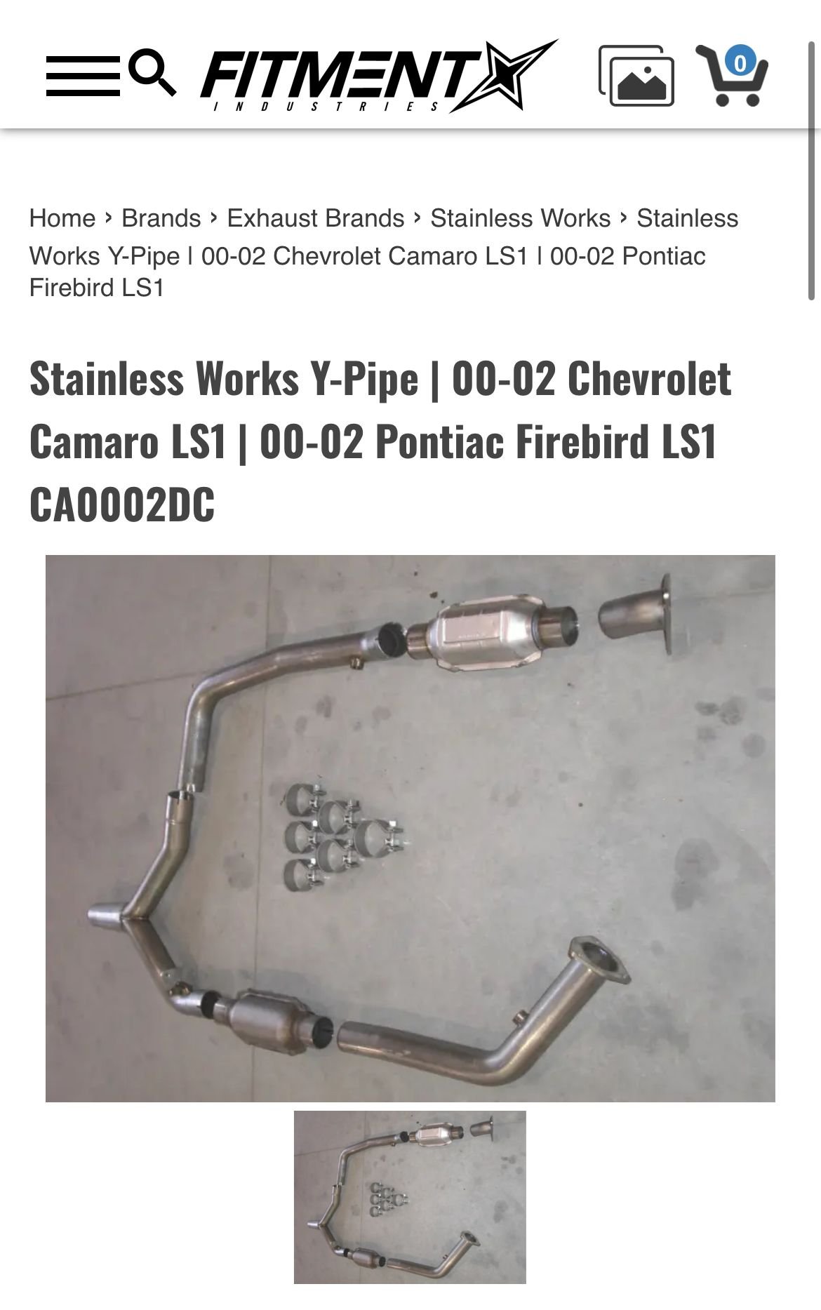

Make me one of these Lee. 😂

You don't need any of that. Just someone willing to unbolt the stock cats from the manifolds. Tack in the new cats, check to be sure things clear by reinstalling them loosely, ensuring things are in the right position and clocked correctly, then completing the welds on the bench. If the person wants to be precise about it, build a jig out of square tubing to hold things in place while welding. Yes, the heat cycled studs and nuts are going to be a pain, and might need encouragement, I broke two on one effort, and had to remove the manifolds to drill out what remained.
Your muffler shop guy handed it over to Larry the welder, decided there wasn't money to made in the deal, especially since he has to unbolt the cats first, and told you to move it along while he waived a honda in to bay 3. My guess is he only wants to deal with by the numbers stuff in the book - and you didn't fit the bill. There is no getting around the fact, mufflex solution mentioned early or the one you just posted, someone is going to have to run the risk of a broken stud - use an oxy torch, if they can get it up there, to persuade things along.
Yeah Larry the welder said all he could do was a bolt in style due to this that and the other which brings us back to broken bolts.
