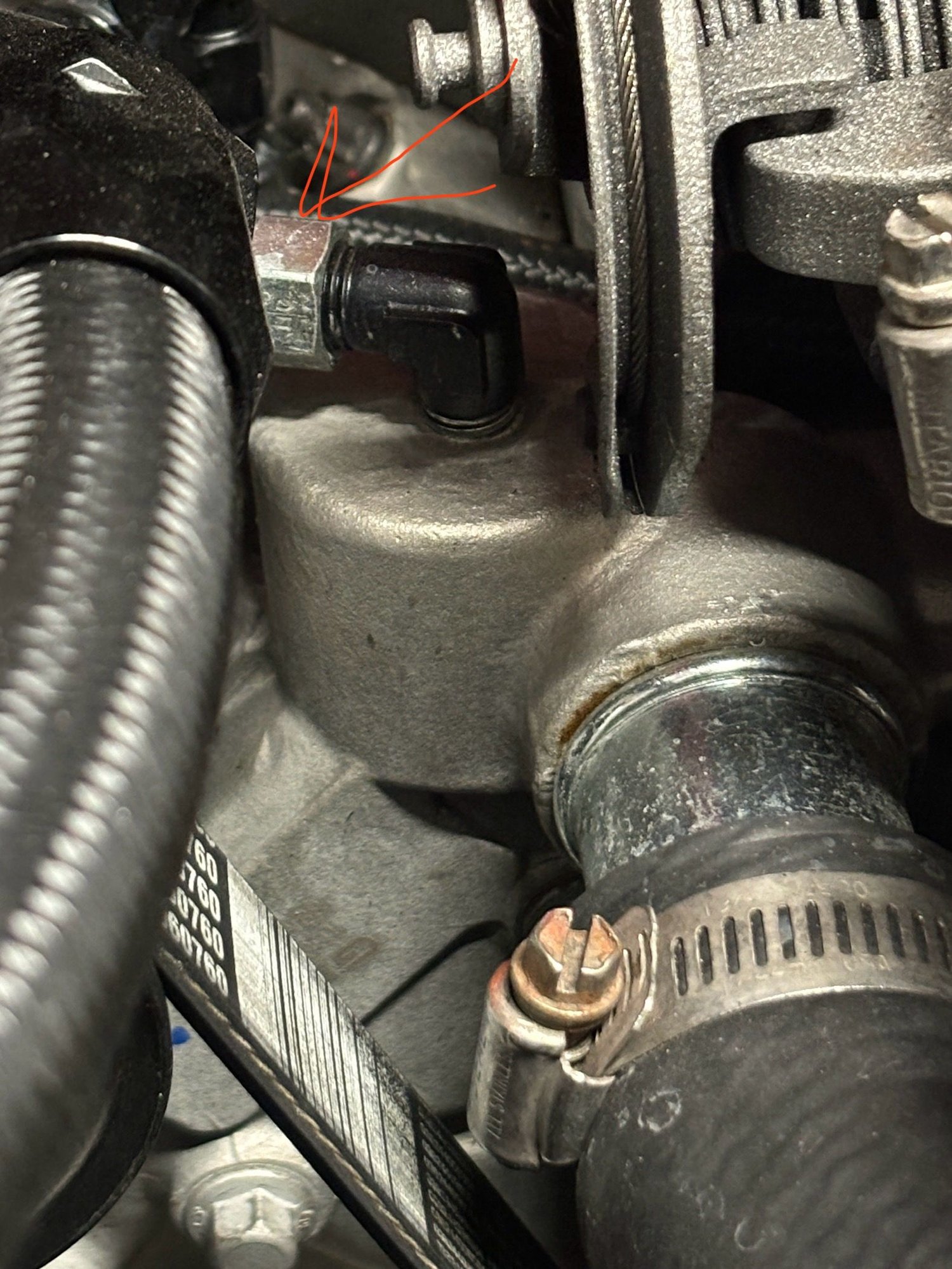

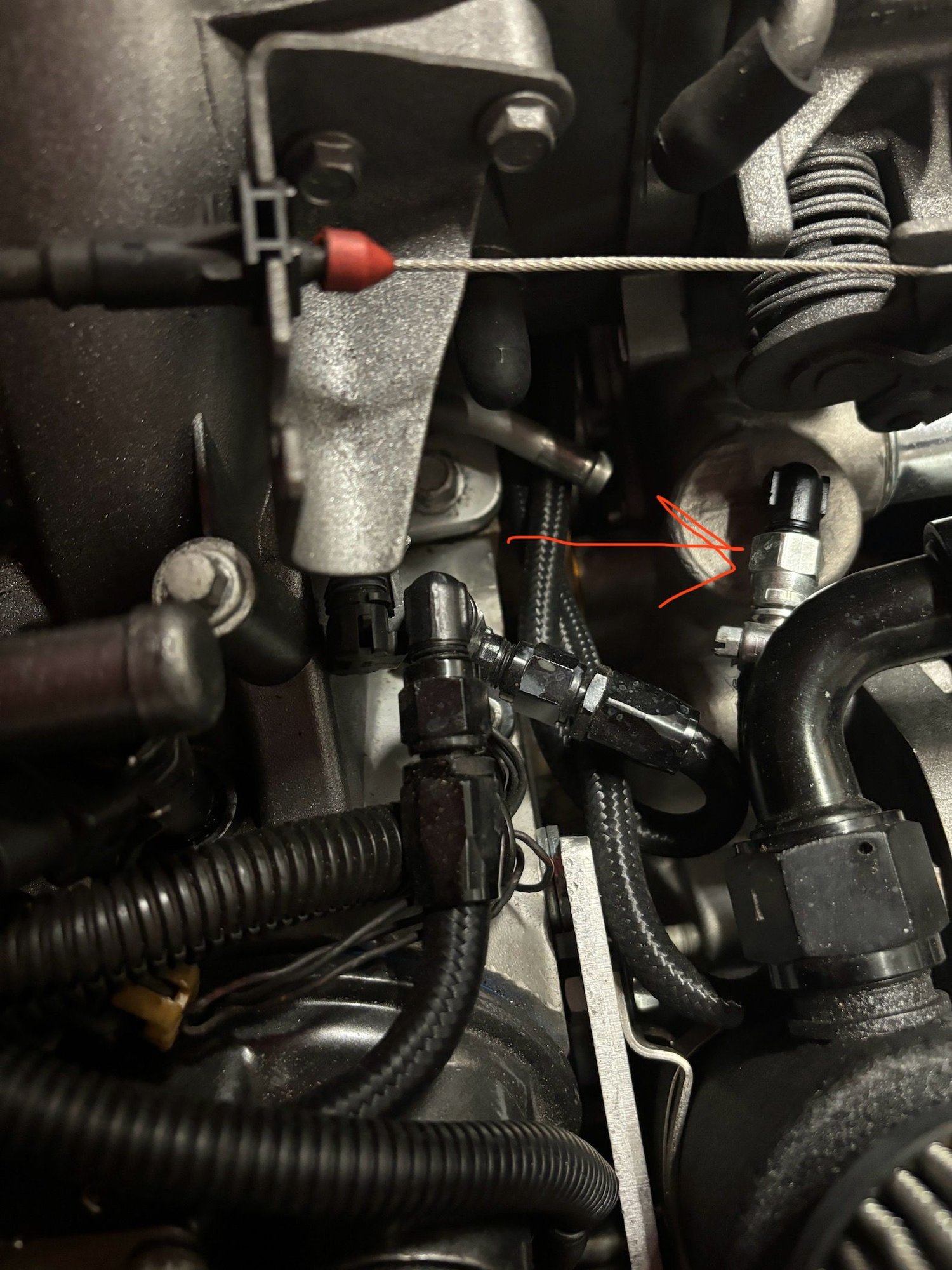

I personally chose to drill a hole in my water pump and connect my steam vent line to that, instead of running it like factory over to the radiator port just under the radiator fill neck.
see the black steel braided lines, that’s a steam vent kit running to all 4 head ports.
when I need to bleed my coolant system I simply loosen that silver nut and the air ****** out. As soon as I see just coolant pissing out I tighten it and it’s fully bled.
Not that you should go this route, I did it because I just recently installed a new engine so I did the steam vent kit.
Bleeding without this can be a pain in the *** or you can get lucky and the coolant will reach the t-stat to heat it up so it’ll open, while you are standing there watching the coolant level drop down so you can keep topping it off.
Start this process with a COLD engine with the radiator cap off.
BTW…..go remove your radiator cap. If it’s not topped off you have an air bubble.
