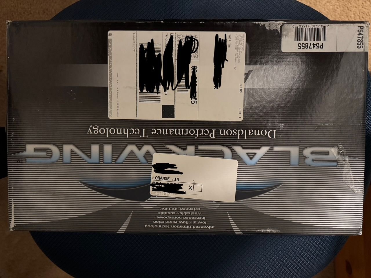

I do have the original box and paperwork that came with it from when I bought it in 2003. Here're some pics. Also includes a page from the old SLP catalog from when the blackwing filter was a new offering. Again, this is from when Donaldson was the original supplier to SLP. I'm not sure who makes it now and how the construction/recommendations for renewing the filter have changed.
Very cool you have all of that, thanks for sharing. I have a friend that has one brand new in the box but I don’t think he wanted to open it. My filter is embossed with the Blackwing logo so who knows at this point.
Maybe something has changed along the way. You would think maintenance instructions (for the possible different filter) are somewhere out there on the net. Possibly the only one that could shed some light on the subject would be Dave Hamburger himself.
