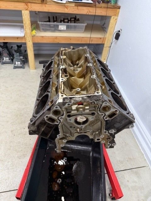

Does it look like that I would need to cut the boss down for clearance, I was told that my engine being a 2001 that I would not need to have this done. Hawks is also telling me that its a direct fit with no cutting

LS6 blocks do not need clearance for the cover.....LS1 do.....if you look up the other threads on here explaining the procedure you will find all this info....there is also a website that covers the conversion too....the threads on here have links to that website

I Just didn't know if my block was slightly different being a 2001 I did read some info. that this year and newer you did not need to cut. I don't understand why Hawks is saying it's a direct fit with no cutting, I was not sure if their kit was built any different

If you have the bullseye on the passenger side front, you have a LS1 block. Some argue that the LS1 block is stronger than the LS6 block.

you have an ls1 block, the ls6 valley cover wont fit unless you grind off that oval part of the block that protrudes into the valley.

its not hawks part...its a GM part....a part designed to fit LS6 blocks.....some F bodys did get LS6 blocks , but not many.......it can be made to fit LS1 blocks with minor clearance....I had to clearance all the engines I did this conversion to....not hard at all to do
