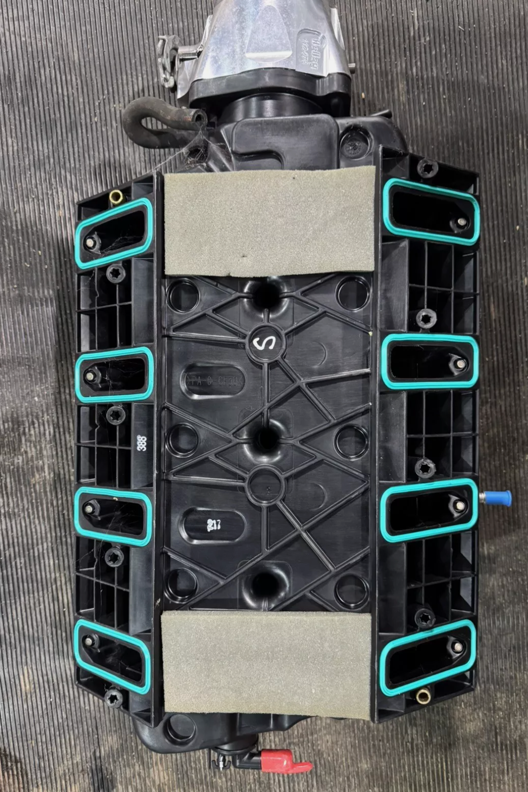

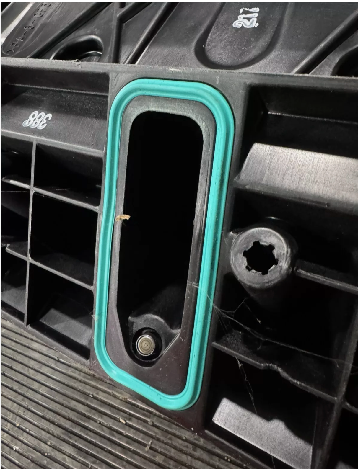

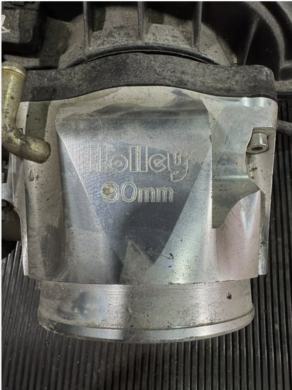

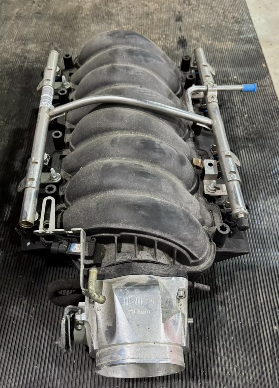

Anyone know what intake this is? It has a 90mm Holley TB (cable operated).
And will this intake fit on a 5.7 LS1?

looks like a LS2 intake to me......a LS6 intake would be better ....or upgrade to a fast 92

I concur- 4 bolt TB on a car-style Gen IV cathedral intake. Only one of its kind.

LS2 Intake, as mentioned above. Could have google'd the part number on it and gotten the same info.

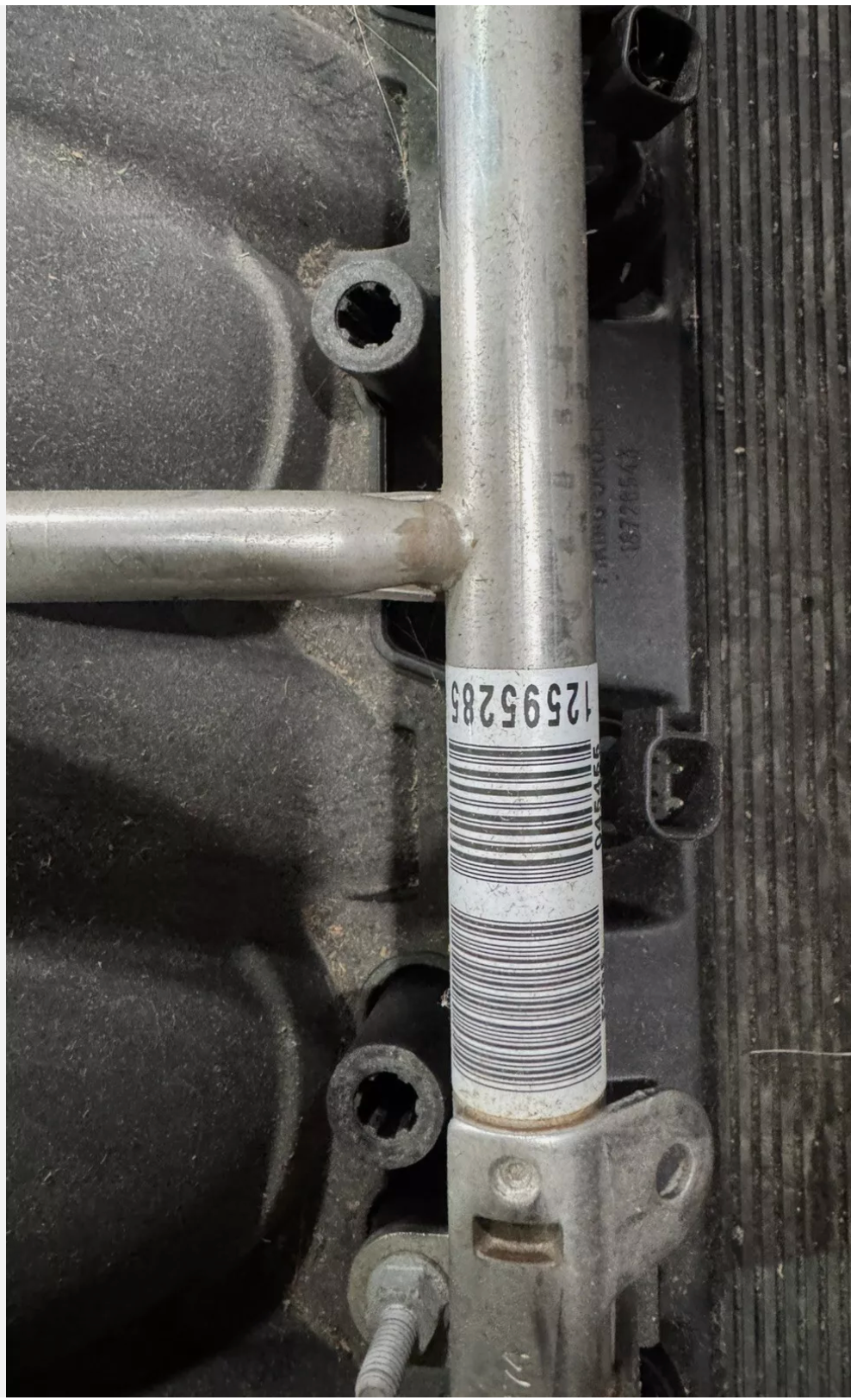

I don't have the part number unless it is in the photos. Not sure where to look tbh... I don't have the intake. It is for sale.

Dorman LS2 or Fast intake would be better than a factory LS2 intake.
This pic here, this is on the drivers side.
Originally Posted by 300bhp/ton
It says:
FIRING ORDER
18726543
Literally above the word FIRING ORDER is the GM Part Number. Fuel Rail is in the way in the pic.
Thanks, but as said, I don't have the intake, it is the 'only' used intake for sale on ebay.co.uk and the seller has it listed as an Ls7 intake.
