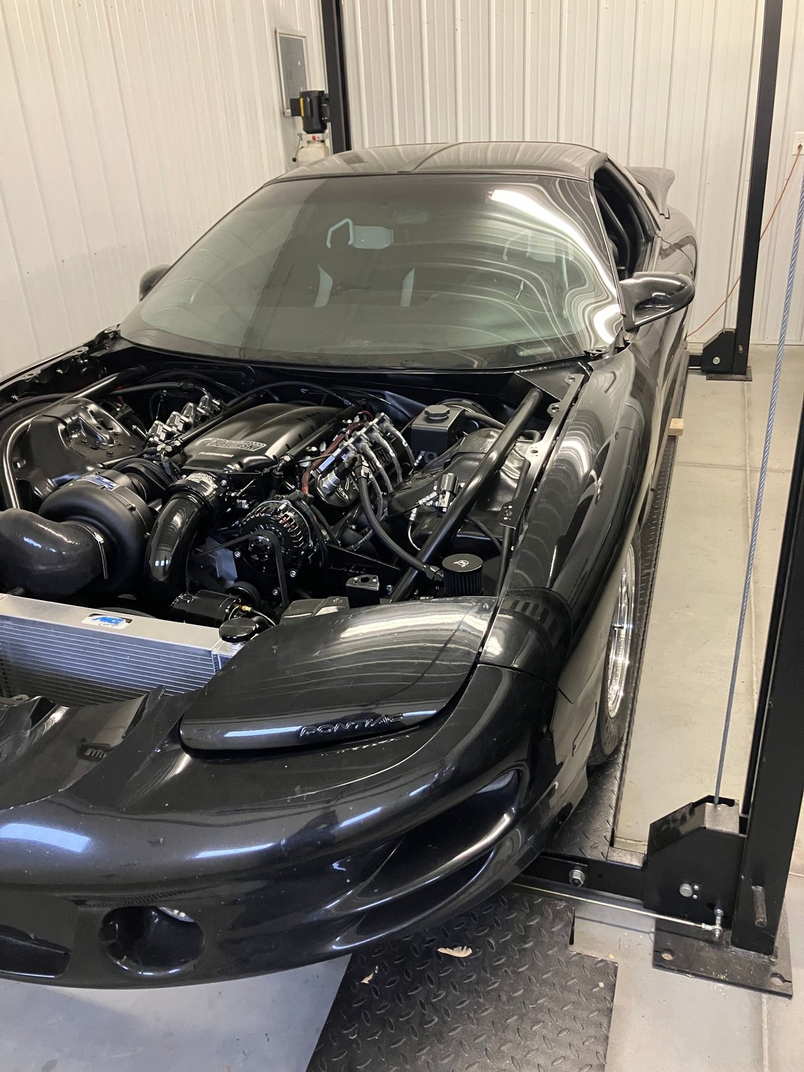

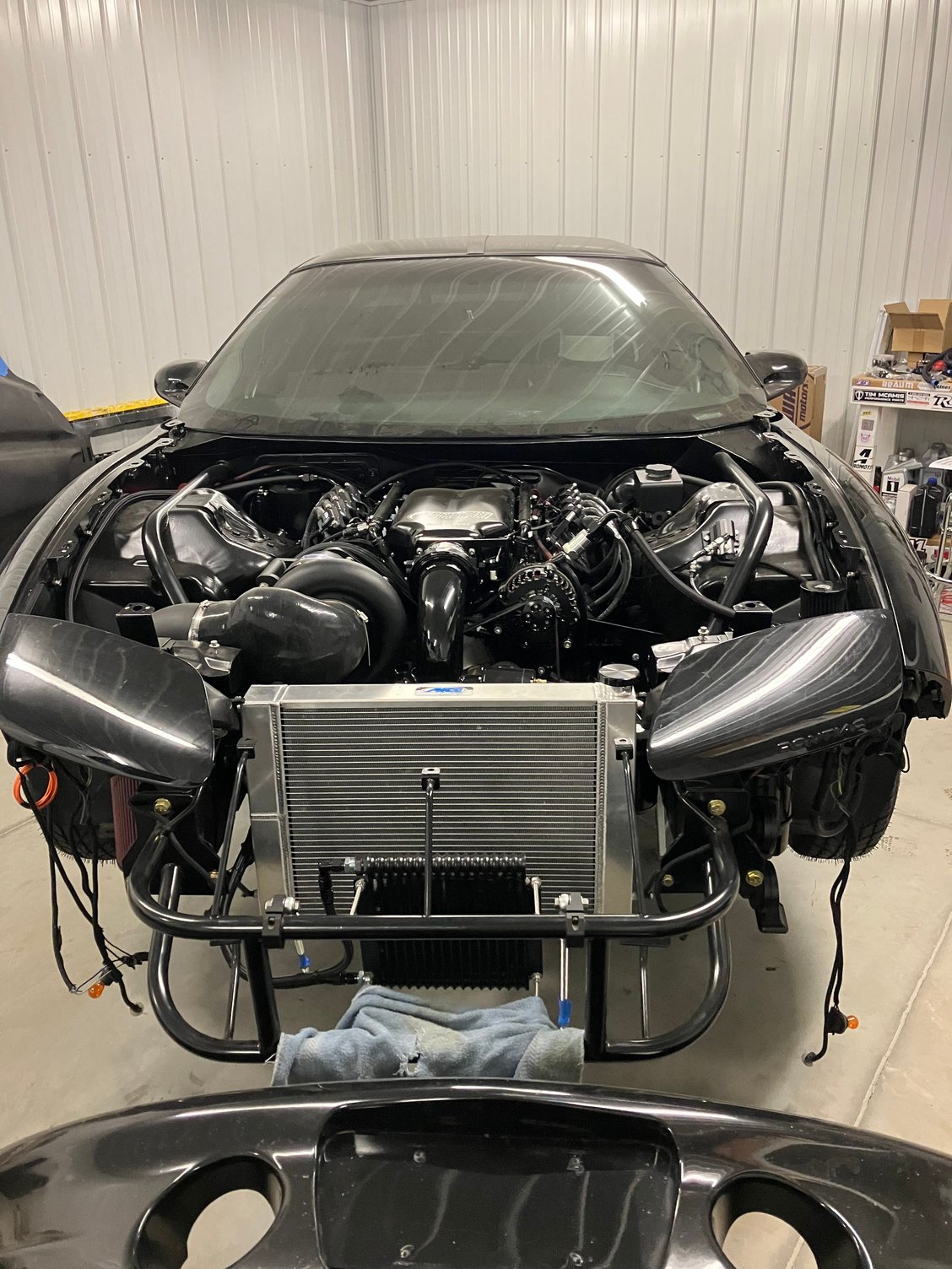

I have been working on a little project for 9 years. Finally got to a point where I am lost as to what is going wrong. I have a 427 with a f1x procharger. Running on e85. Can’t seem to keep engine cool. I drove down the road for 20 miles and temp got to 230. Way too hot for my liking. I am running a Burkhardt bumper support with a double pass afco radiator. Meziere 55gpm pump. When I questioned the radiator they said they had plenty on the street with no problem. I haven’t been able to dyno tune her since I found out I need an intercooler for the street. Somehow talking to my engine builder it must have gotten lost in translation that I wanted a street car. Wondering if the engine is getting warm because of the high intake air temps. Also I changed the map sensor to 5 bar. I haven’t been able to tune the file to a 5 bar sensor, since I was waiting to have the tuning guy do it. Could that also be making the car run lean and make it run hot? Any help would be greatly appreciated!

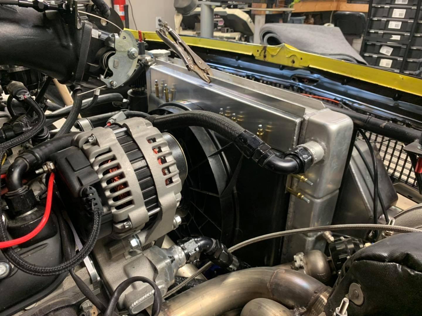

What CFM does that fan pull? That shroud really isn't letting any air pass thru unless it goes directly thru the radiator.
Could need something like this: https://www.speedwaymotors.com/Fan-S...saArtcEALw_wcB
It also isn't even ducted in the front so the air will find the least path of resistance which isn't helping your cause.

I’m not an expert, but the sheet metal that the fan mounts to looks like it obstructs about half of the radiator’s surface are. It seems like you could use 2” wide bars to mount the fan and open it up. Like previously mentioned, it looks like you could install a deflector to push air into the radiator. I wonder if you could install a pusher fan on the other side of the radiator to help. Cool car!

You want the shroud. You can make a few windows in it with some rubber “flappers” on it that open when cruising and close when stopped. Or just install a great fan and you’ll likely be fine.
The best deal out right now that I’ve seen is the brushless silverado fan paired with a burn down garage mounting kit. (which is optional) Impossible to beat those flow numbers for the $ with aftermarket fans. Around 9000CFM wide open.

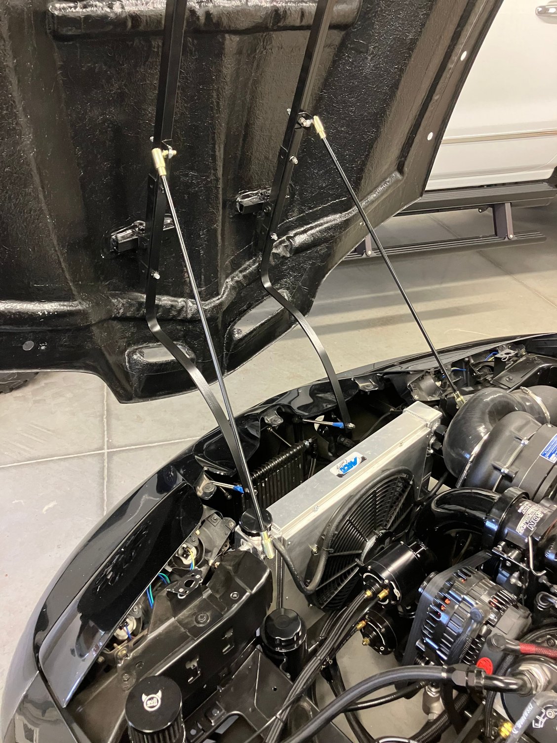

Installed 1860 cfm fan from spal. Checked coolant and installed a bleeder air release also on steam line to radiator. No air in system. Driving down the road it gets to 210. Much better. When I stop and idle the temps come right down. Trying to make an air dam to funnel air towards radiator and install the rubber flaps from speedway next. Since I haven’t had her officially tuned is it possible that she is running hotter because it’s getting lean?
