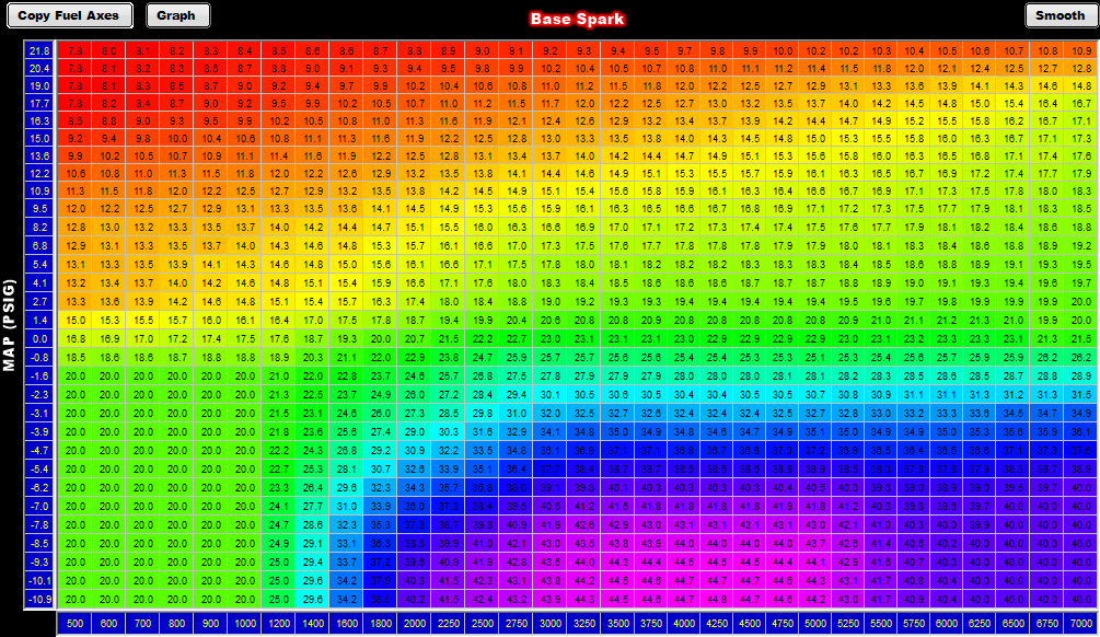

Running 93 pump, 8psi, wired for flex but I dont think the tune is done for it. Full 3" exhaust with a resonator. Ebay intercooler setup with cast 7875. My concern (other than the intake) is my clutch and not sure if I'm blowing thru it in the upper rpm's but not sure how to figure that part out. The clutch is a Texas Drivetrain Performance Diamond.....rated for 475 torque. Here's my timing table

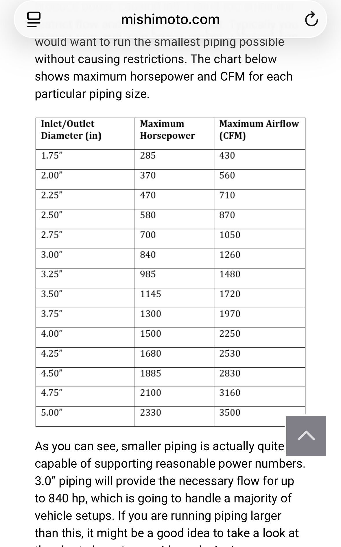

Going off of this I’m guessing my 2.5” intercooler pipe is choking it, hell my emusa intercooler probably is too.

Your exhaust (CFM) chart is whacked;
A SINGLE 3 inch exhaust pipe is getting restrictive at 400 flywheel horsepower.
Old May 7, 2026 | 07:21 PM
4EyedTurd1's Avatar
Joined: Feb 2013
Posts: 328
Likes: 19
From: Waco,Tx
That chart is from Mishimoto intercooler piping chart.
