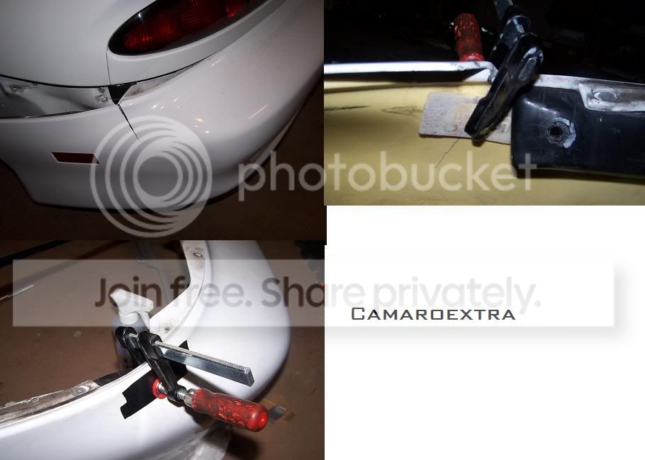

I put the back of my car through a fence, and got a 6inch rip in my bumper cover right below the tail light. i couldnt get another one for a month or two, so I took it off, and gorilla glued some plastic paint stirers i had in the garage on the back of the rip to hold it together, and it worked great! i used clamps to hold it all together, and they held together for liek 6months, even when i replaced the bumper,and pulled on it to get it off, the seam didnt seperate
heres a little pic i stiched together for ya
that paint stick was even dirty and half melted for some reason and it worked great.
ths black tape on the white is to protect the paint from the clamp
