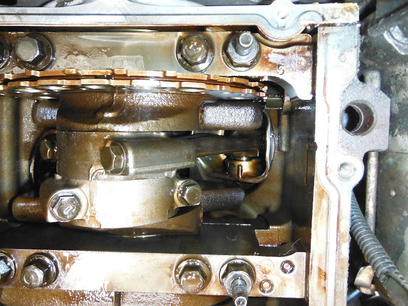

Old Mar 29, 2013 | 11:54 PM
pvfjr's Avatar
Joined: Mar 2013
Posts: 15
From: Corvallis, OR
Old Mar 30, 2013 | 12:07 AM
Rob WS6's Avatar
iTrader: (16)
Joined: Oct 2012
Posts: 349
From: Maple Shade, NJ
Oh damn! I bet that cylinder got hydrolocked at some point.
Old Mar 30, 2013 | 05:04 AM
RezinTexas's Avatar
Joined: Jun 2011
Posts: 1,343
Likes: 8
From: Katy, TX
took me a minute, then I saw it. Damn!
Sorry for your troubles, but at least now you get to upgrade...
Old Mar 30, 2013 | 09:33 AM
Old Geezer's Avatar
Joined: Jun 2004
Posts: 5,639
Likes: 71
From: GA, USA
Unhappy Ya..
Like some moron tried to start it, when it was rolled back onto the wheels, after the wreck...Oil ran past the rings, partially hydo'd it.
A common problem.
[Just saw a NICE, lo mile 07 Silvy, w/ 2 rods out of the block....Same stupid mistake.]
Old Mar 30, 2013 | 09:50 AM
Rob WS6's Avatar
iTrader: (16)
Joined: Oct 2012
Posts: 349
A common problem.
Yeah, ya know that would probably make the most sense. That's a shame, but at least it didn't take the whole block with it.
Old Mar 30, 2013 | 11:16 AM
pvfjr's Avatar
Joined: Mar 2013
Posts: 15
From: Corvallis, OR
Yeah, as soon as I saw that rod I thought "Oh no they didn't...". When will people learn? How hard is it to try turning it by hand first just to check? Then pull the stinking plugs and crank it over? Grr....
Oh well. I ran out of daylight last night, so I'm going to pull the rod cap off and see what the crank looks like today. Hopefully it's not scarred up, but that twist in the rod has been putting a little side load on those two rod bearings.
