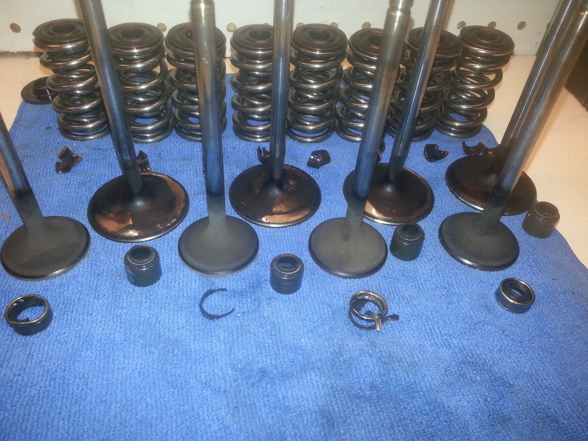

Scored a set of WCCH 317 heads with unknown brand of dual valve springs. I tore them down tonight for cleaning and inspection, and noticed on one head, every single intake valve seal is completely munched, or in the case of one, gone all together.
The valves appear to be stainless, but again, not 100% sure as I didn't buy the heads new.
Anyway, does anyone have any opinions on why it would be only the intake valve seals that got tore up? Are there any specific valve seals that work especially good with dual springs?
In some cases, they nicked the valves. What is the general opinion here? Does any amount of damage warrant replacement, or is there some room for recovery, such as knocking down the high spots on a combustion chamber that got tore up from a failure?

Pictures added for clarification.

are all the valve seals the same height?

I also would not run the valves if the damage part goes into the seal. It will leak. I would replace the damaged ones.
Best i can tell, yes. Some of them are severly damaged, but when I compare the undamaged exhaust seals to the ones that were installed on the intake valves, they were all the same height.
I wish there was someway to further ID these springs and seals...

get some fel pros and put it back together. Install them dry.

Is it the general consensus that Fel Pro brand is the best? I had heard through the grapevine about some ones that were viton material that had a smaller exterior diameter to help from getting pinched by dual springs.
Ever heard of such a thing?
I have but all I can go by is what I have experienced. Never a failure using the Fel pros
