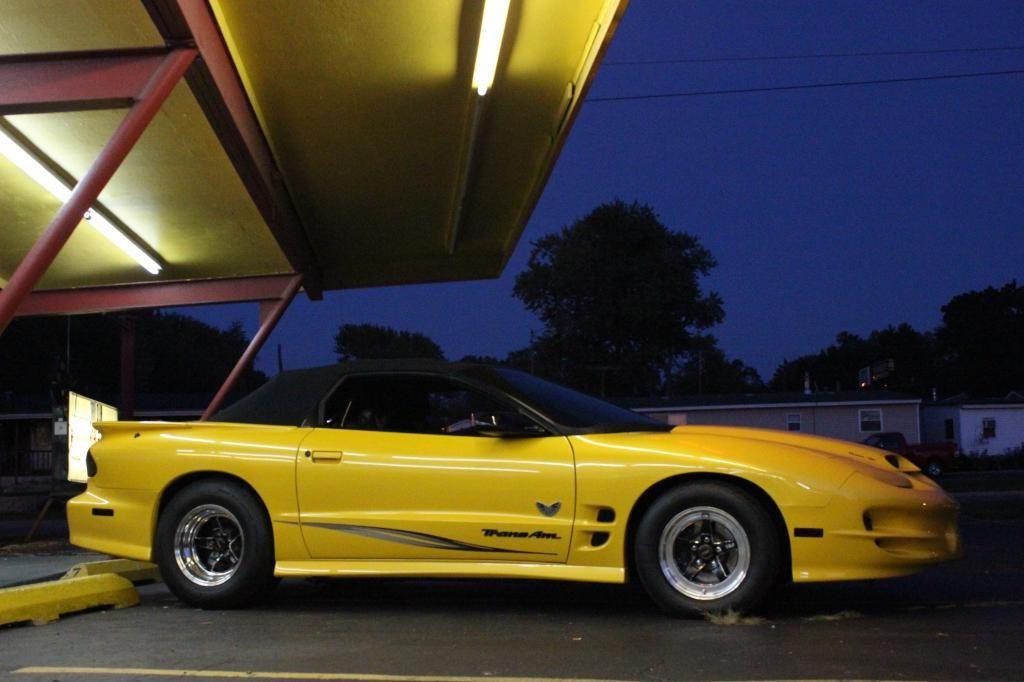

That would be me, I have put a alot of time in with it now and still maintain I can drive it anywhere. Since then I have put 4.11s in with viking coilovers and have gone a low 11 @115 1.7 60' and a best of 10.90 @ 130 with nitrous motivation. If I were to drive it every day I would just quiet the exhaust down and keep a relatively sticky tire on it. Will be getting tea/tfs 215s on it this summer along with a stiff wall.

Got any recent pictures after the Vikings install?

I did not really take pictures of the install, but it was super simple, but here's some together and on the old welds and then the billets right before it got put away for the winter, will need to do some adjustments in the spring to get it where I would like it.

Looking good man! once you get those heads on there we'll have to meet up at the track again and line up!
