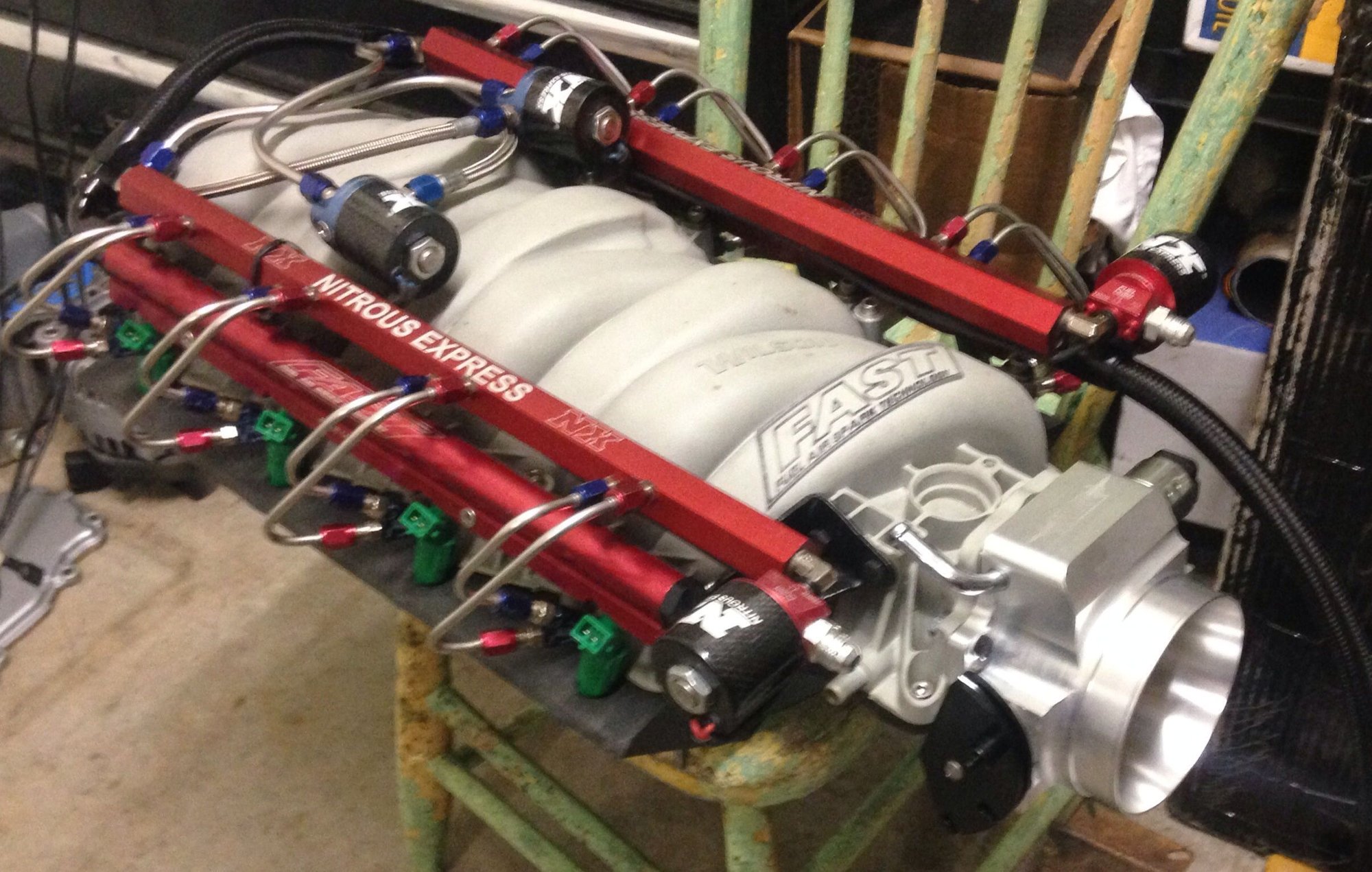

New injectors and 92mm throttle body..

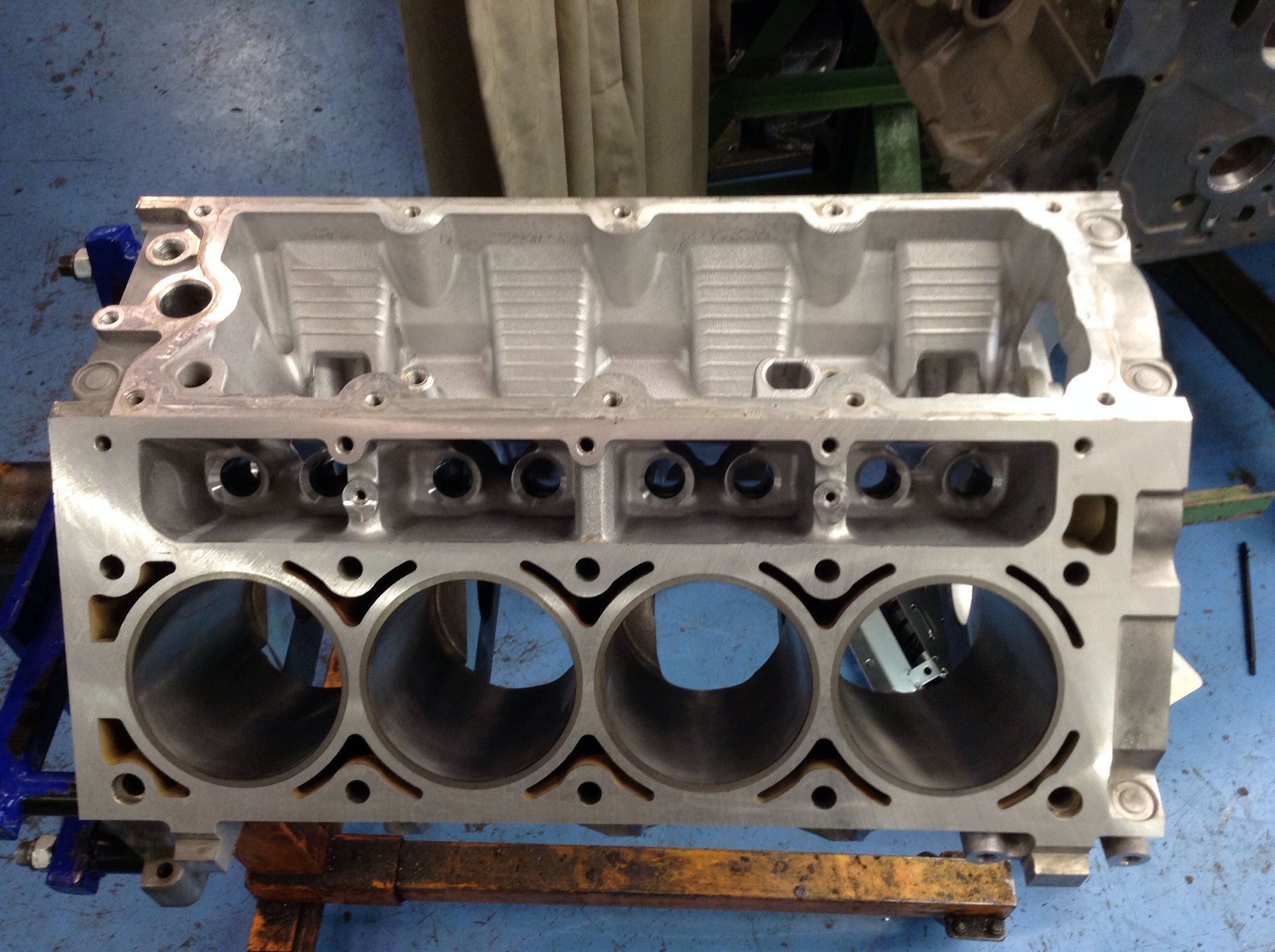

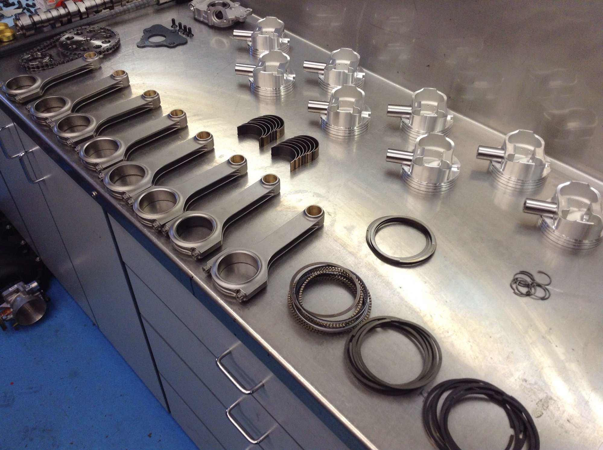

Short block is ready!
Old May 3, 2015 | 07:01 AM
Tuskyz28's Avatar
Joined: Sep 2014
Posts: 4,893
Likes: 706
From: Mississippi
Good looking setup!!

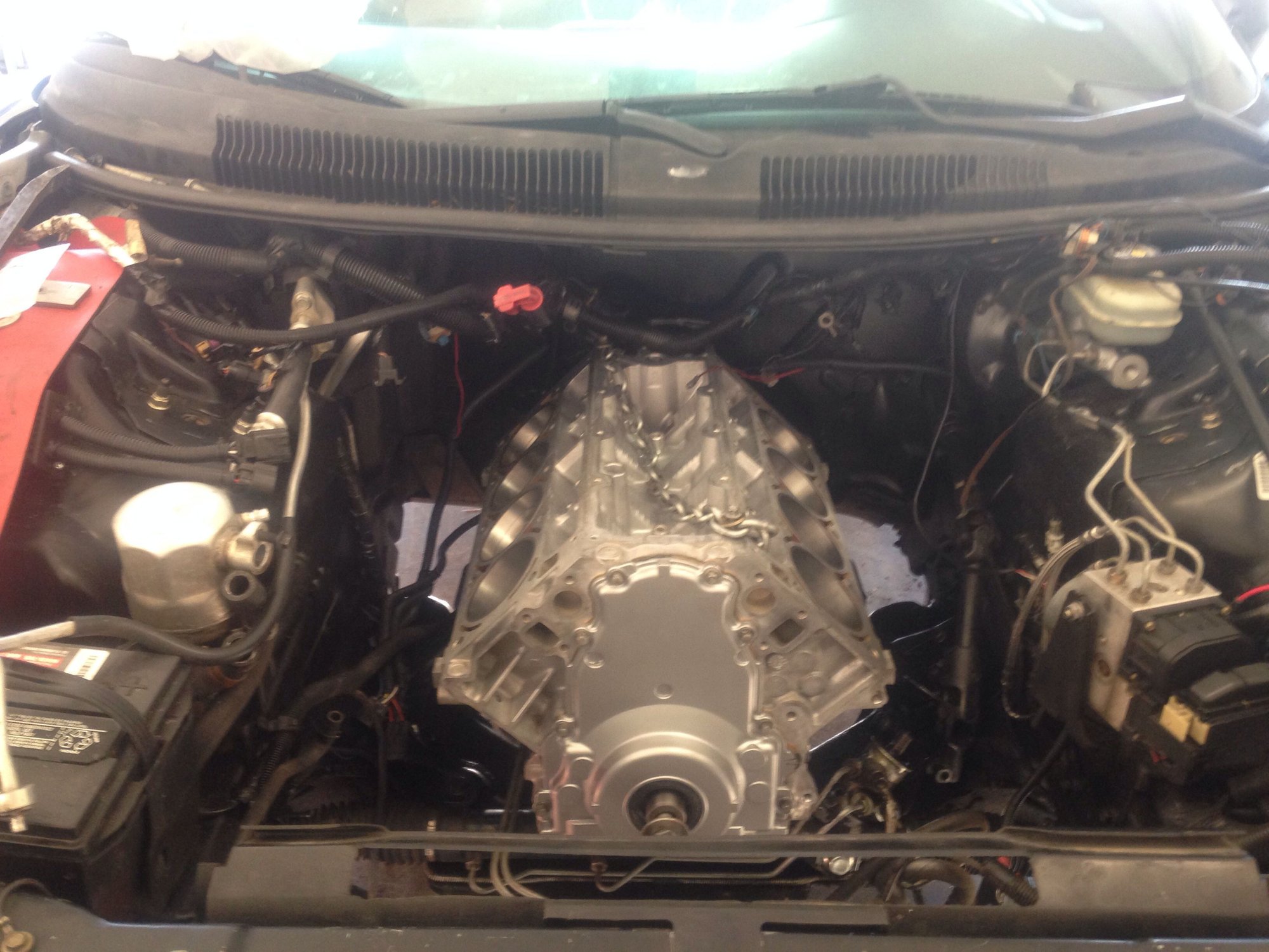

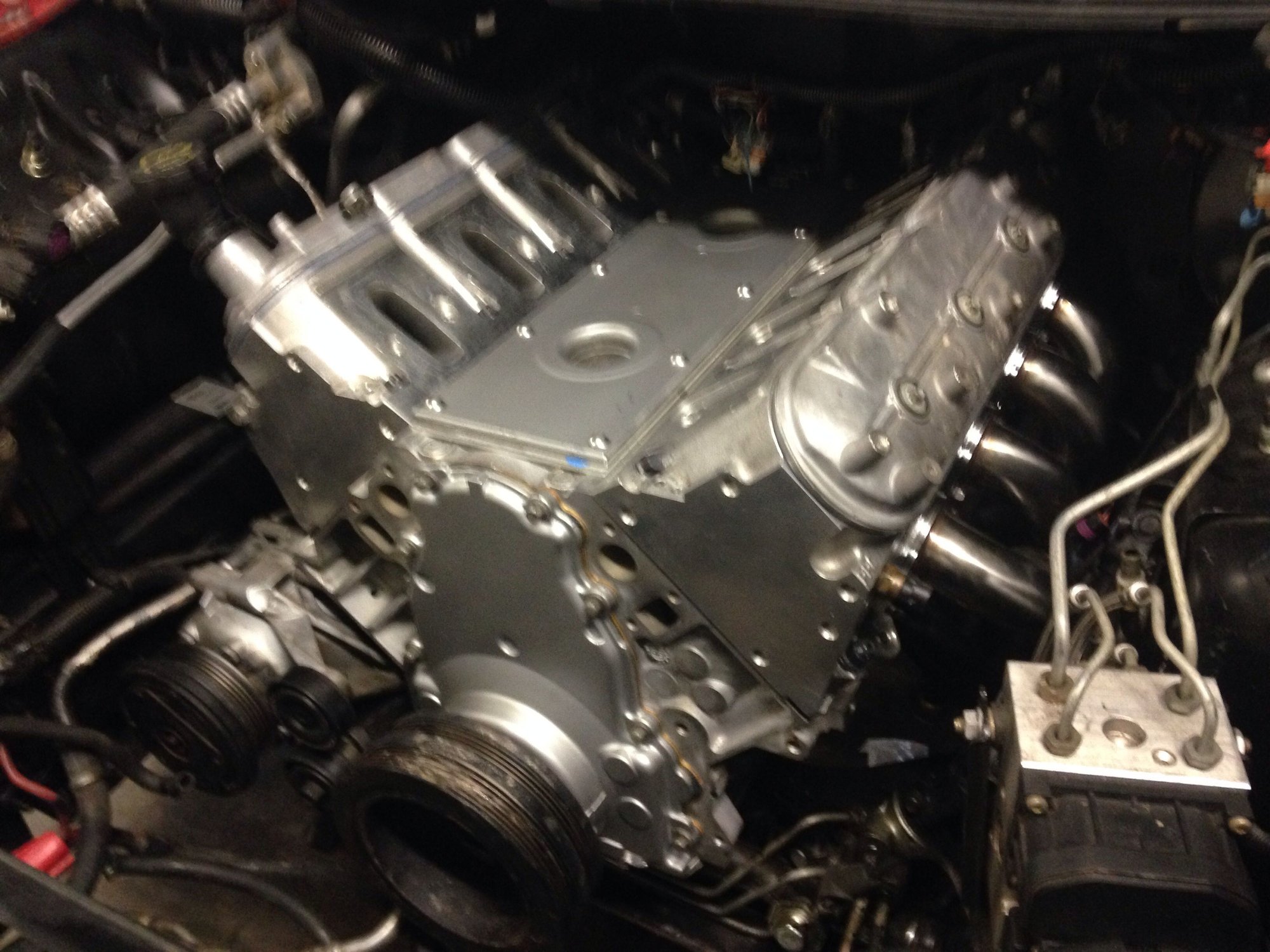

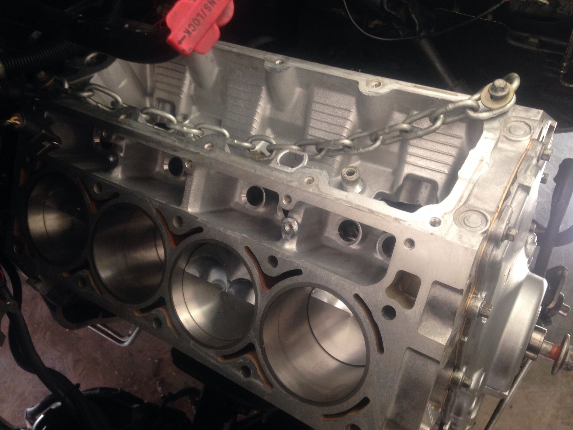

Making progress!
Old May 4, 2015 | 10:06 PM
ds98formula's Avatar
Joined: Mar 2008
Posts: 965
From: Joliet Illinois
Looks good siting in there. You did not want to put the heads on first?
Old May 4, 2015 | 10:16 PM
Csnell3732's Avatar
Joined: Sep 2013
Posts: 93
From: Arkansas
Was stabbing it by myself so I just installed it without the heads to make it a little easier .. I'm not too worried about it... Heads go on pretty fast anyways
