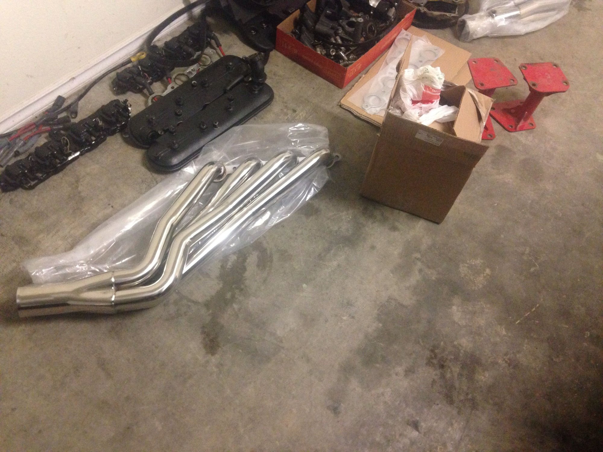

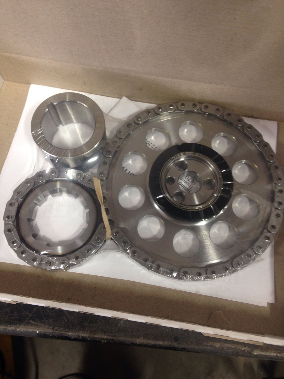

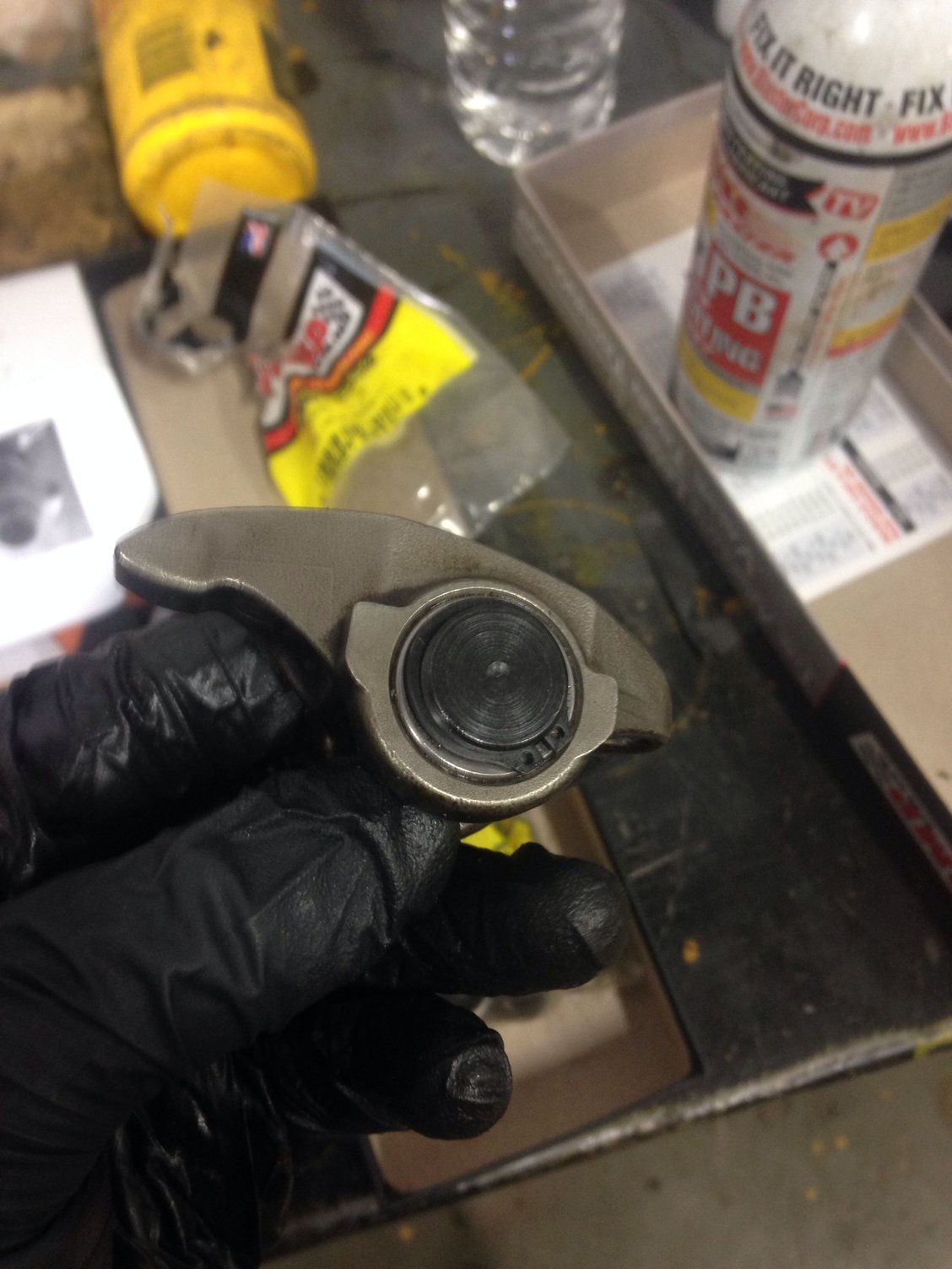

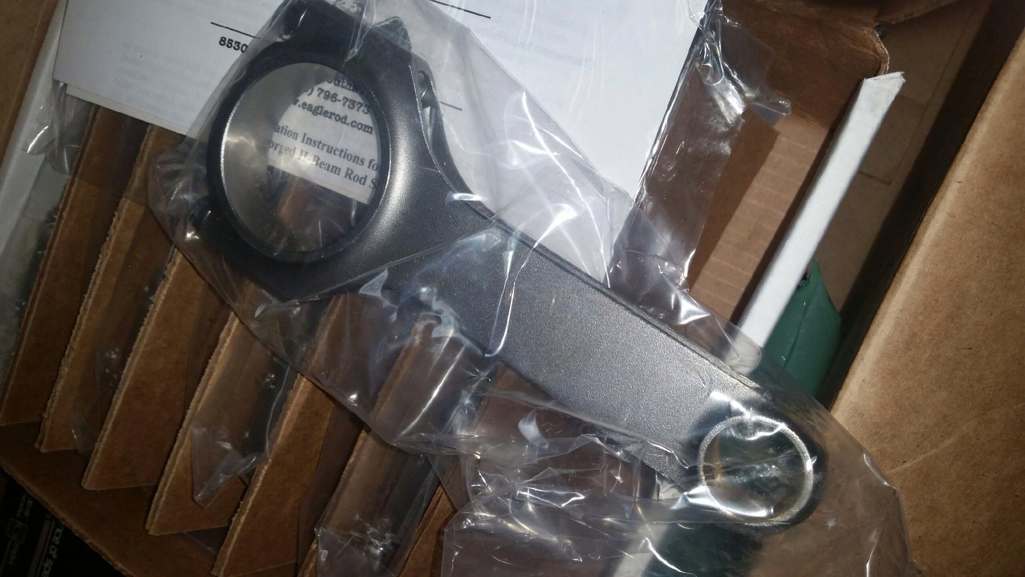

Old Apr 6, 2015 | 07:51 PM
Csnell3732's Avatar
Joined: Sep 2013
Posts: 93
From: Arkansas
Talking
Update on parts!
Old Apr 7, 2015 | 03:32 PM
jhshnh's Avatar
Joined: Oct 2014
Posts: 898
Likes: 71
Wow. It's gonna scream!

Looks good. I think even with a great tune it's going to be interesting driving it. I'd also invest in some higher end lifters and bigger diameter pushrods as well as rockers or a trunnion upgrade with that cam. I went with a smallish 229/236 .631/.631 111 cam as I wasn't going for max effort but good drive-ability. My stoker runs smooth as silk.

Trunion upgrade is in the mail on its way! And I have bigger diameter push rods also! The car will be speed density tuned and honestly I have a amazing tuner, he made my buddies car with the texas giant cam idle and drive like stock on MAF setup, speed density does help with idling so I'm thinking I'll be ok plus it's just a weekend toy/strip car! Did upgrade to a billet timing setup also with 9 way adjustable sprocket! What kind of power did yours make? What about track times?

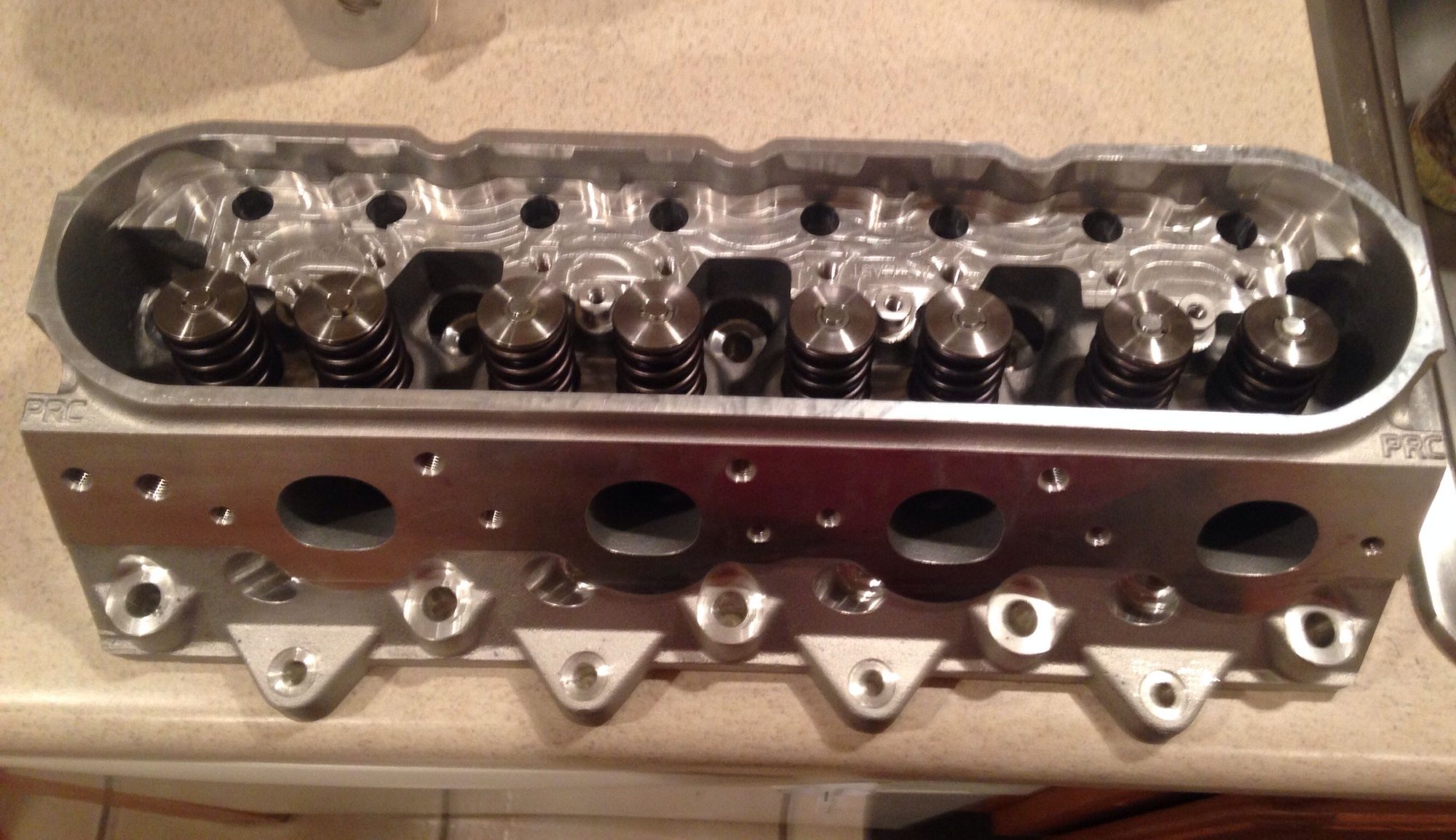

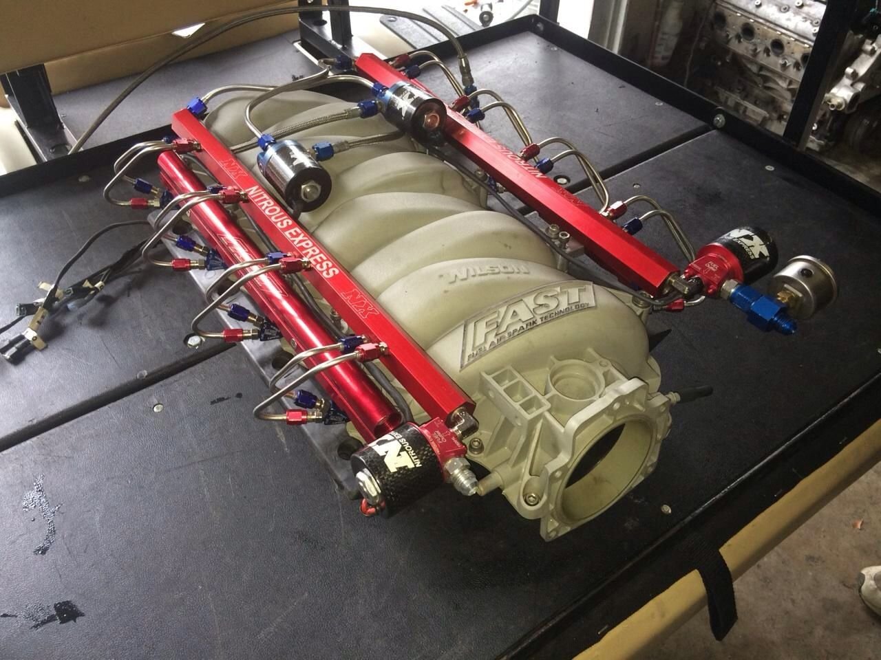

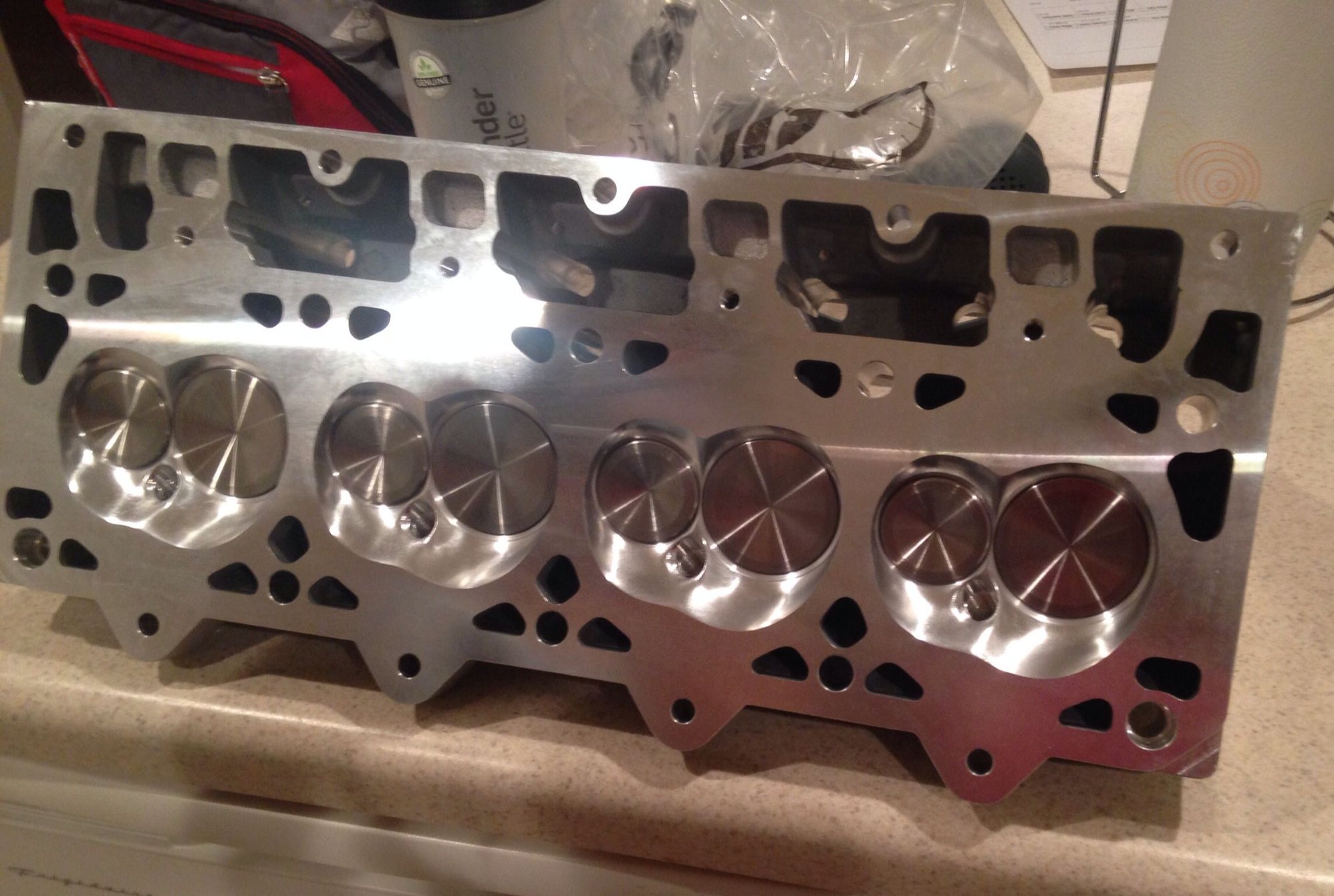

Old Apr 9, 2015 | 05:41 PM
Csnell3732's Avatar
Joined: Sep 2013
Posts: 93
From: Arkansas
Old Apr 27, 2015 | 11:04 AM
ds98formula's Avatar
Joined: Mar 2008
Posts: 965
From: Joliet Illinois
In for results.
How long from ordering to receiving your heads was it? I am looking at these heads. Can not find a lot of results with them so I am interested in yours
