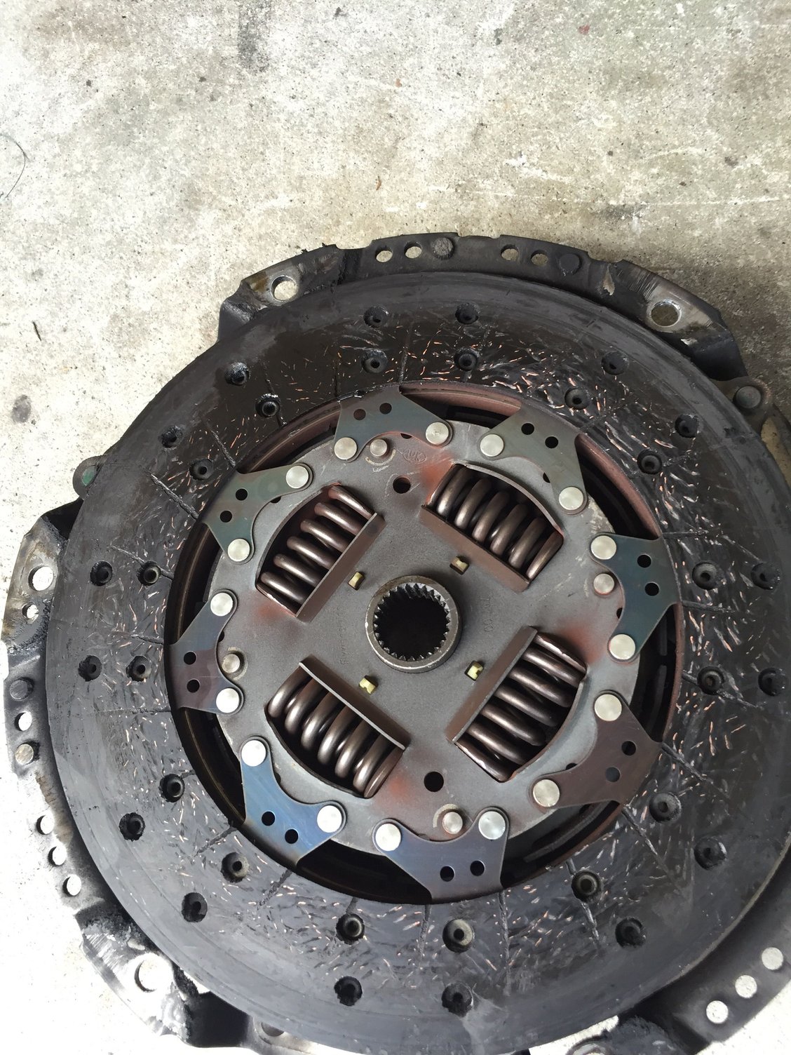

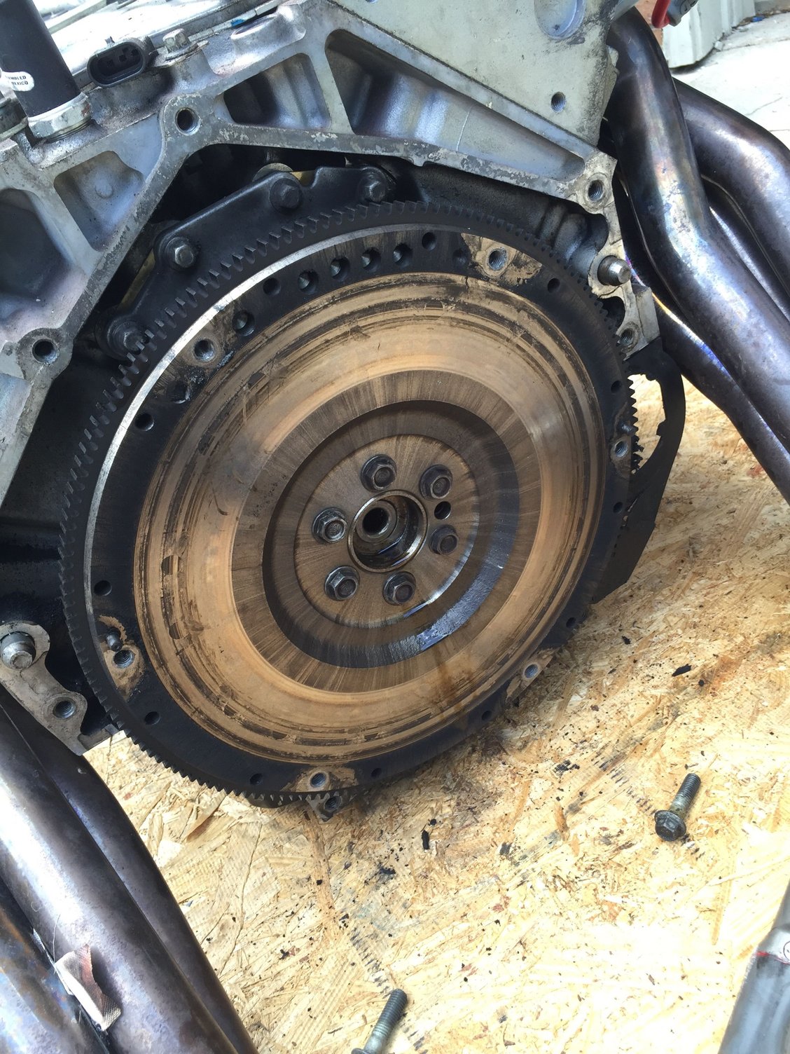

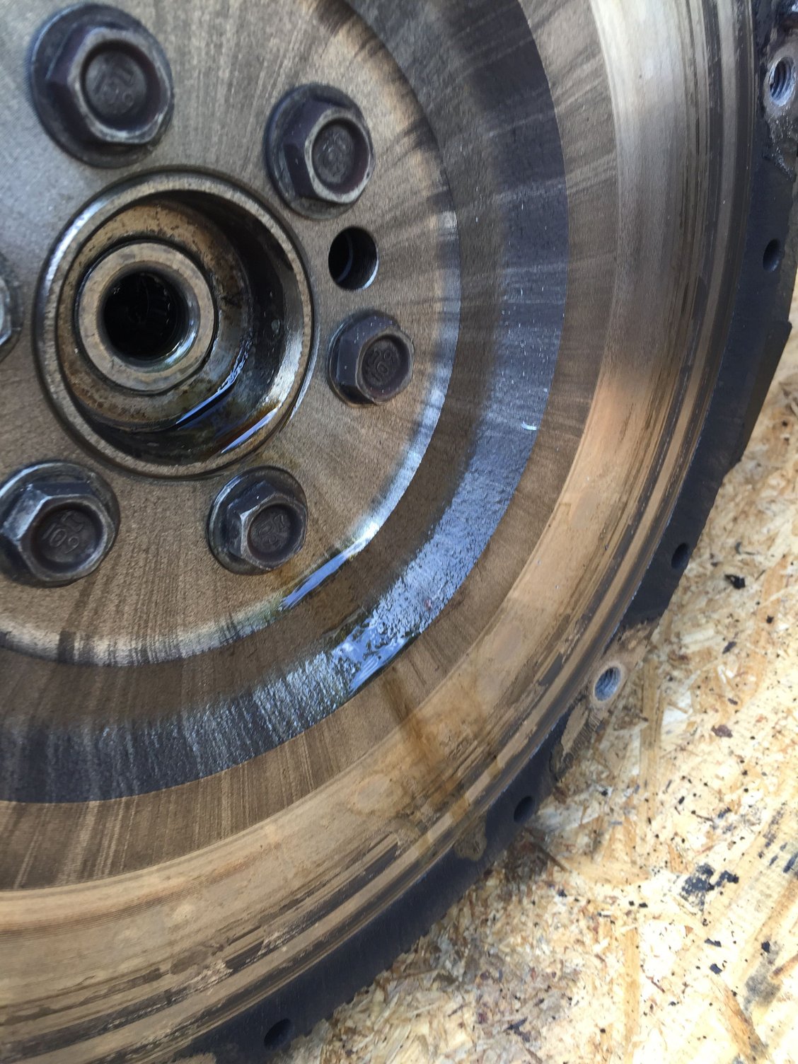

I pulled my engine and transmission, and After separating my trans from motor, I realized that the clutch had a layer of oil on it, along with the flywheel.
Does this mean my pilot bearing was bad? Or could this have happened because I pulled the engine, and the motor and trans where sitting verticle at one point, allowing oil to seep out?
The clutch never really slipped before.

Stick a pencil through the bearing hole, it should touch a freeze plug in the end of the crank. That plug may be missing, skewed, or have a hole in it...

Yeah, I'm thinking oil may be leaking from the plug in the back of the crank.

I made it squeaky kleen and drier than a popcorn fart. Got the best hi-temp adhesive RTV I could find and glued the plug in. Put in a new roller pilot bearing. Pics show my treasure from Texas Driveline Service (sadly out of business) 15 lb billet steel fly, pressure plate rated to 550 tq, big clutch disk but composite, not grabby like a dual friction monster can be. Smooth and a pleasure to drive. New Bolts ! Tick speed bleeder ( do yourself a favor, buy one) Wilwood 7/8" master (made a adjustable clevis), oem slave, extended braided stainless line because my LS1 is in a 93 RX7.
