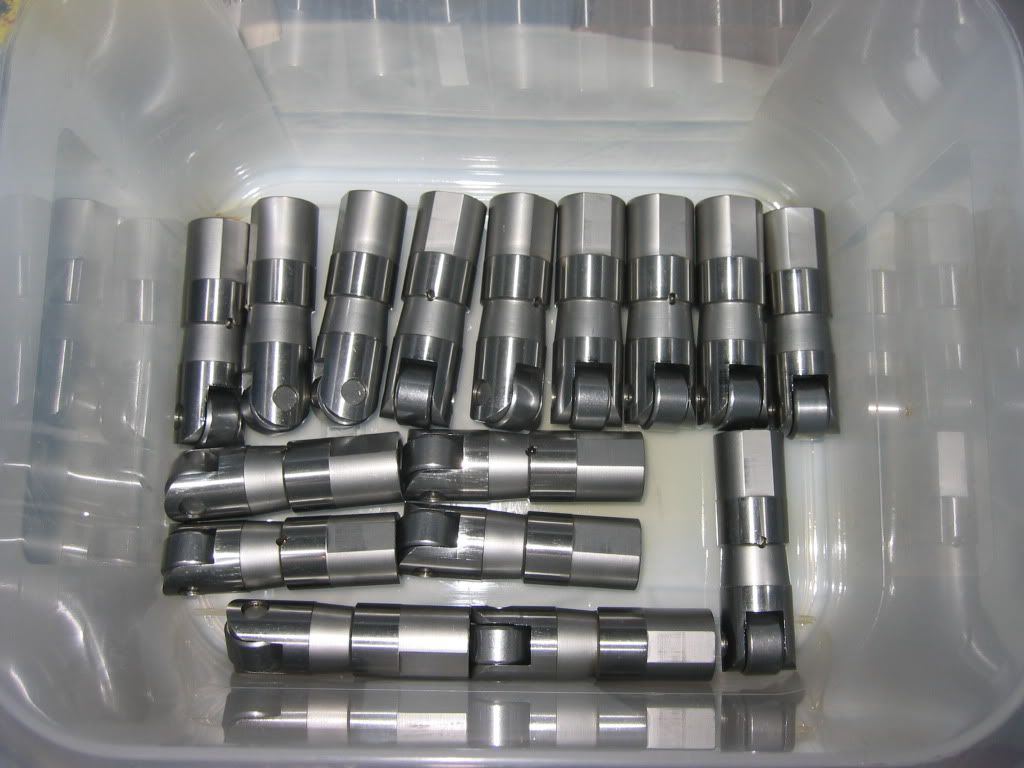

No, if you look at a photo of a lifter (below) there are two sections that are full diameter and then a reduced diameter section. The dowel fits in this reduced diameter section. So if the lifters are up or down so the reduced diameter section is not aligned with the oil gallery, the rods won't go in. Hope that makes sense.

To those using pen magnets including the OP, tell me you were using something to hold those pen magnets up.
