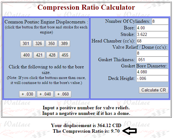

A stock bottom end LQ4 with 821/823 square port heads will be about 9.7:1. Not a lot of compression there, but it is not a deal breaker. Still better than the 317 heads.

Kind of what I expected. Low enough I wouldn't want to jump to a much larger cam. I went from a 5.7 to 6.0 with more compression but kept the same 230/238 size cam and I've been more than pleased with how it runs now versus the smaller lower compression motor.

How are you reaching those numbers? Thats not what I came up with

Here are the numbers from a stock LQ4 for a control:
Here are the numbers when you swap on a set of L92/LS3 heads and requisite 6.2 head gaskets:
You could mill the heads or use thinner head gaskets, but it will reduce piston-to-valve clearance unless you fly-cut the pistons to compensate.

Cool thanks, I wonder what info i put in wrong. I will definately need to mill my heads, I am wanting to go ahead and do a 408 bottom end anyways. This may be a good reason for me to do it lol
