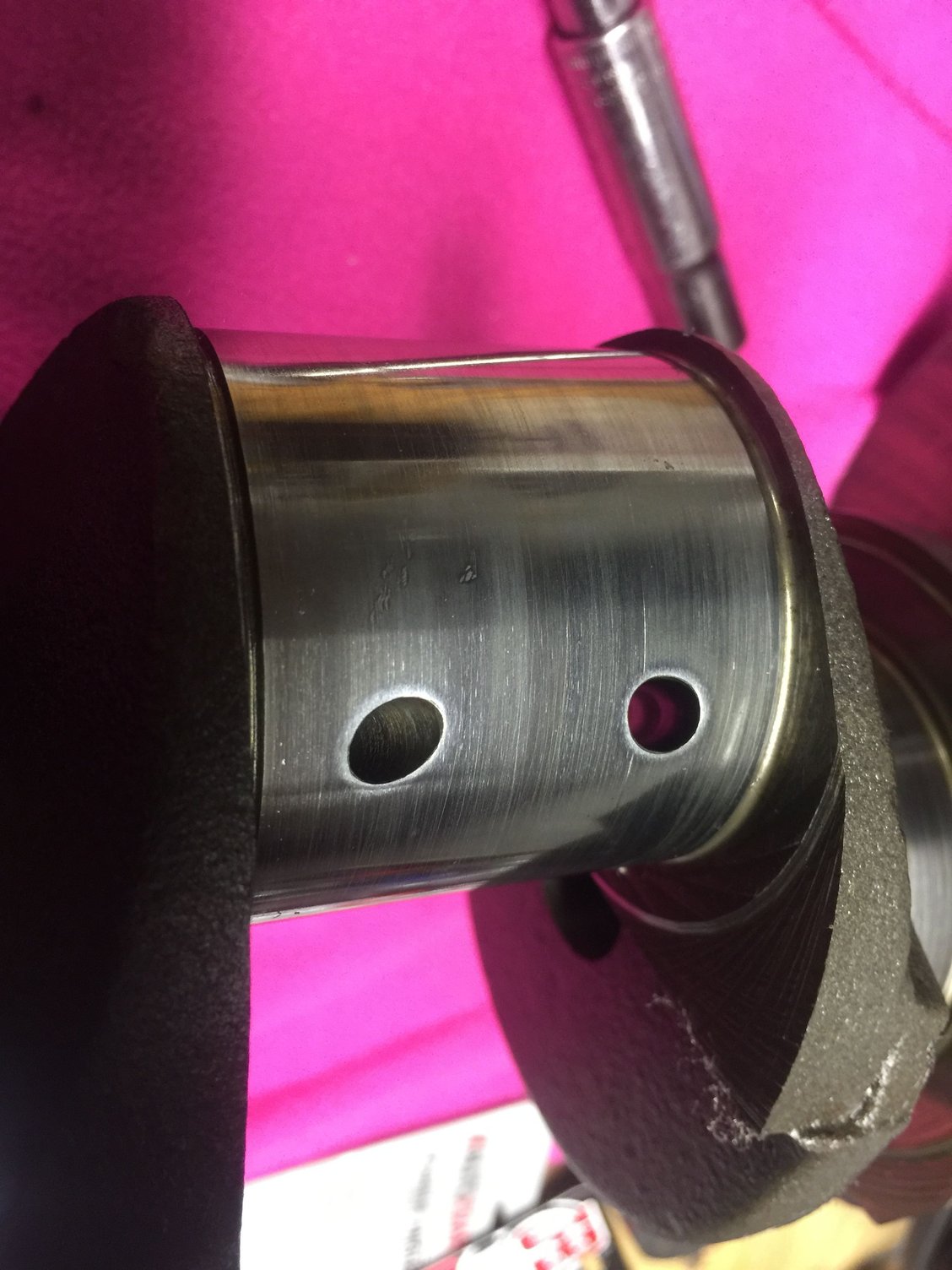

So I picked my motor up from a local machine shop after having the basic work done. Block bored and honed, crank cleaned and polished, rods resized for ARP bolts, etc... This is a 99 model LS1 btw...
Well I noticed the 1st journal on the crank has some ridges in it, enough where you can feel them with your finger nail. I asked the machine shop and they said it was fine and within spec. But.... It has me concerned. I took some pics, what do you all think about this? The motor was running strong with good oil pressure when torn down so it didn't have a spun bearing or anything.
My idea of polishing a crank is the surface should be smooth like glass. Am I wrong?
The other rod journals look good.
This is the main journal in question...

Looks like ****. I would polish it at least, if not have it turned .010".

According to the machine shop they polished it. The other journals look nice, all except for this one. Guess I need to take it to another machine shop for a second look. I just don't feel confident putting this new motor together with a crank that looks like that...

They must have forgot that journal, that doesn't look polished at all.

agreed...that looks like total llama poop
A good shop would have chamfered the oiling holes and polished it using a three step process....new 180 or 220 belt, used 320 or 400 belt and either a scotch brite finisher or a dead 600
Now based on the visual scoring present, I would expect the journal to mic small afterwards, and perhaps need .001" undersize bearings which then forces your hand to decide on just getting a grind.
Problem is, there are so few good crank guys around anymore that it could size and or index worse afterwards if ground by someone who cares more about your coin and less about the success of your build.

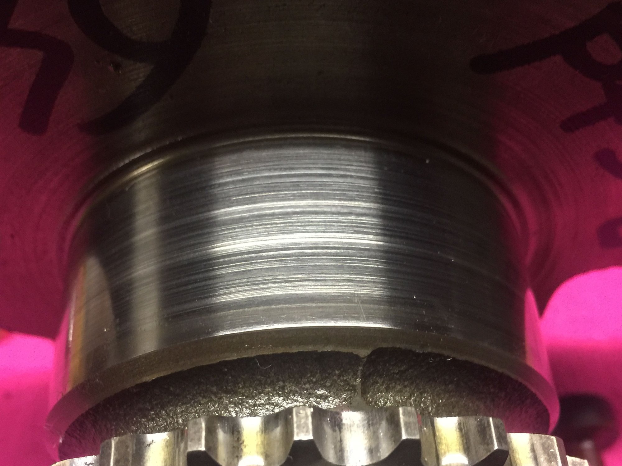

In the bottom right of the photo, what is going on with the counterweight? Is it broken or is that an illusion in the photo?

KCS, that's a good question! I didn't notice that yesterday when I picked it up but I'll have to give it a good look when I get home from work. Almost looks like it's broke or cracked on that counterweight. I sure hope not...

Well... The crank is apparently fine. I took it by Race Engine Design in Rossville, GA to get their opinion. The crank isn't broke, that was a piece of lint or something on it. They said the grooves in the main journal won't hurt the bearings or crank. If it was out of round or had high spots, then it would be an issue. But the journals were true and clean. The tech there told me extra oil can be trapped in the grooves, which is a good thing. So... I guess it's ok to run.
