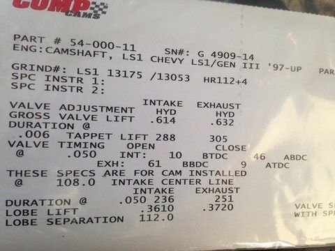

Question for you guys that are good with engines.
What kind of horsepower should I be making with this camshaft? I am guessing 500-550 hp. And I think this is a nitrous grind camshaft. Any ideas or recommendations?
Engine specs are as follows:
Stock 6.0 short block
Brian Tooley .660 double springs
Comp trunion upgrade
3/8 hardened pushrods
1 7/8 headers long tubes
850 double pumper carb
Victor jr single plane intake
Stock 243 imported cylinder heads
MSD 6LS ignition box with stock coils

What camshaft lol??

Added pic of cam card.. Sorry.. Brain fart

No problem lol. Being that those 243's are stock I'd say maybe closer to 550 at the motor. Also would depend on the dyno, trans, compression, etc...

It's a stock 6.0 bottom end. Has powerglide transmission with 4500 converter, 5.13 gears, and is in a '75 camaro with a roll cage and not a lot of lightening done to the car. And is on 28x10.5 slicks.
It's running right at 7.50 (1/8 mile) on motor. Launches at 4600 rpm, and pulls good.
Still having a fuel system issue that's supposed to be being addressed this week. Will find out come Sunday if the suggestions I made helped any.
