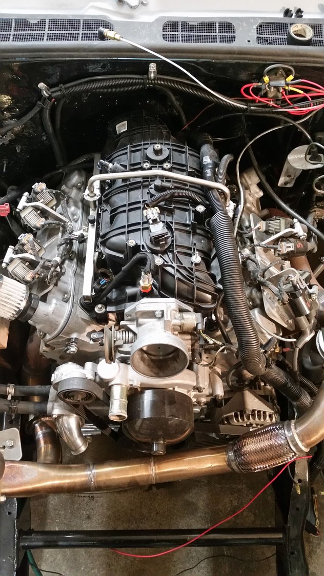

what's an NNBS intake? Why did you swap, though it was the stock intakes fault?
its the trailblazer ss / new-new body style truck intake
GM redesigned it for more midrange torque and I swapped because it supposedly helped with the "lean in #7" thing according some bs thread i read on performance trucks. i've actually never hurt an LS, I am really conservative with my tuning, especially under boost.
NNBS truck intake
OBS truck intake
so if it its not the steam ports, and not the intake, then its either the way coolant passes through the block or ????
i know less now than I did before
